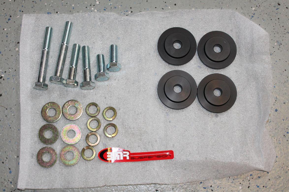

Initial impressions were good, although I wondered why the included bushings were so thin when I had seen the thicker bushings from Steeda on other Mustangs. The BMR kit can be seen below in the pictures.

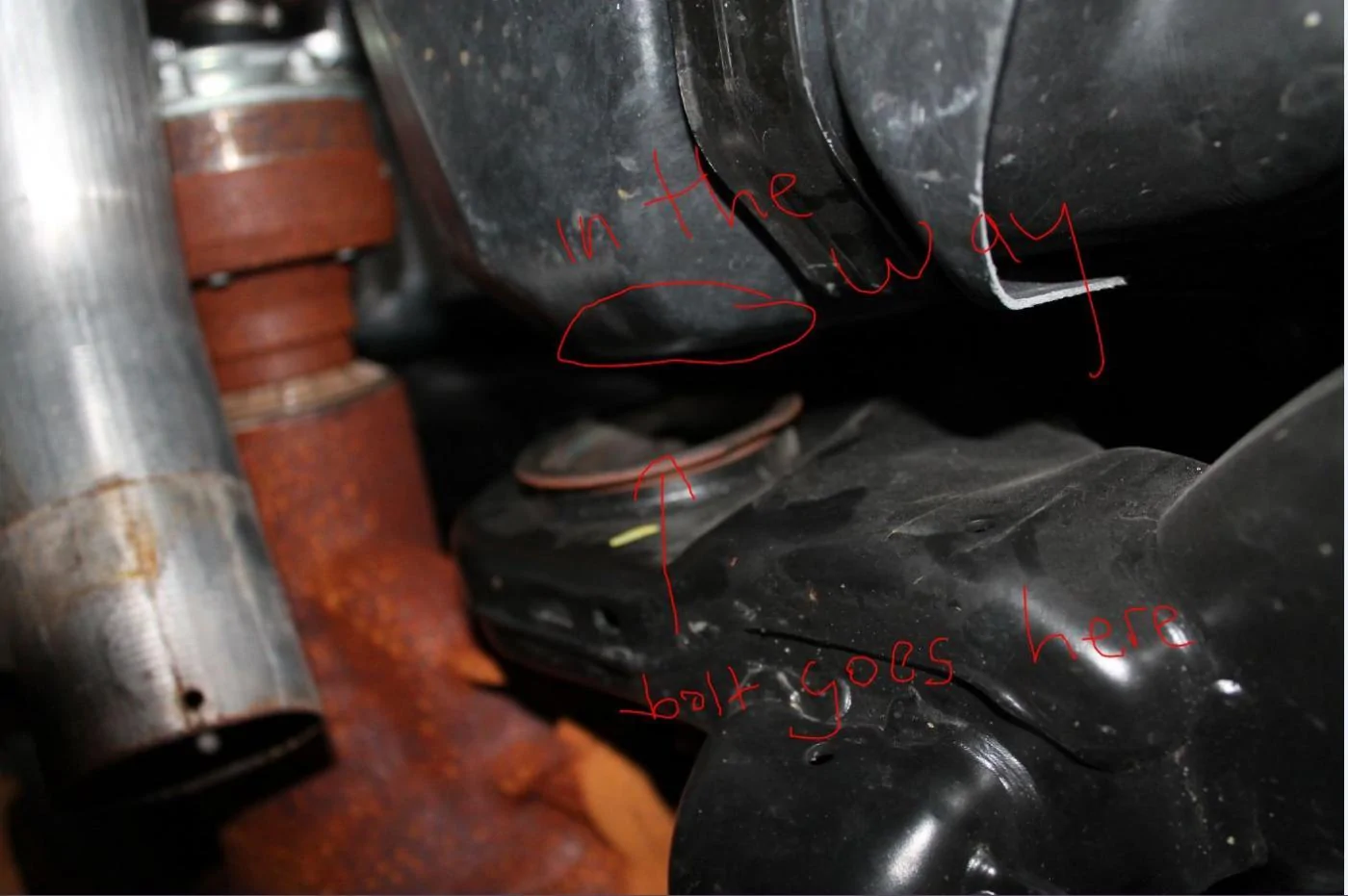

While the above may sound straight forward and simple, there were a few tight spots. Namely, the (2) front bolts are tough to get to. I had to remove the exhaust to allow clearance to swing the ratchet here. As the bolt comes out, it will pinch the ratchet in place and won't allow removal. So I had to remove the ratchet and loosen the last few turns by hand (luckily it wasn't too tight). Even tougher is when the kit is installed, 4 bolts replace the original 2, one from the front and one from the rear. The front most bolt is short and has the support puck on it. Getting this set up in requires moving around the subframe to gain clearance. Both for install and even more so to tighten and torque the bolt. After installing all of the BMR equipment, I used the Steeda alignment kit to get the IRS back up and connected to the car with minimal movement. Still needed an alignment, but it wasn't too bad, would have been fine on the roads and normal driving.

BMR diff kit components

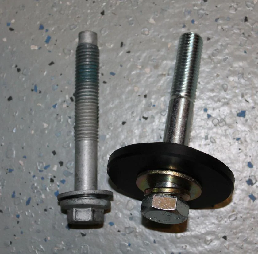

Rearward bolt comparison, Stock vs BMR

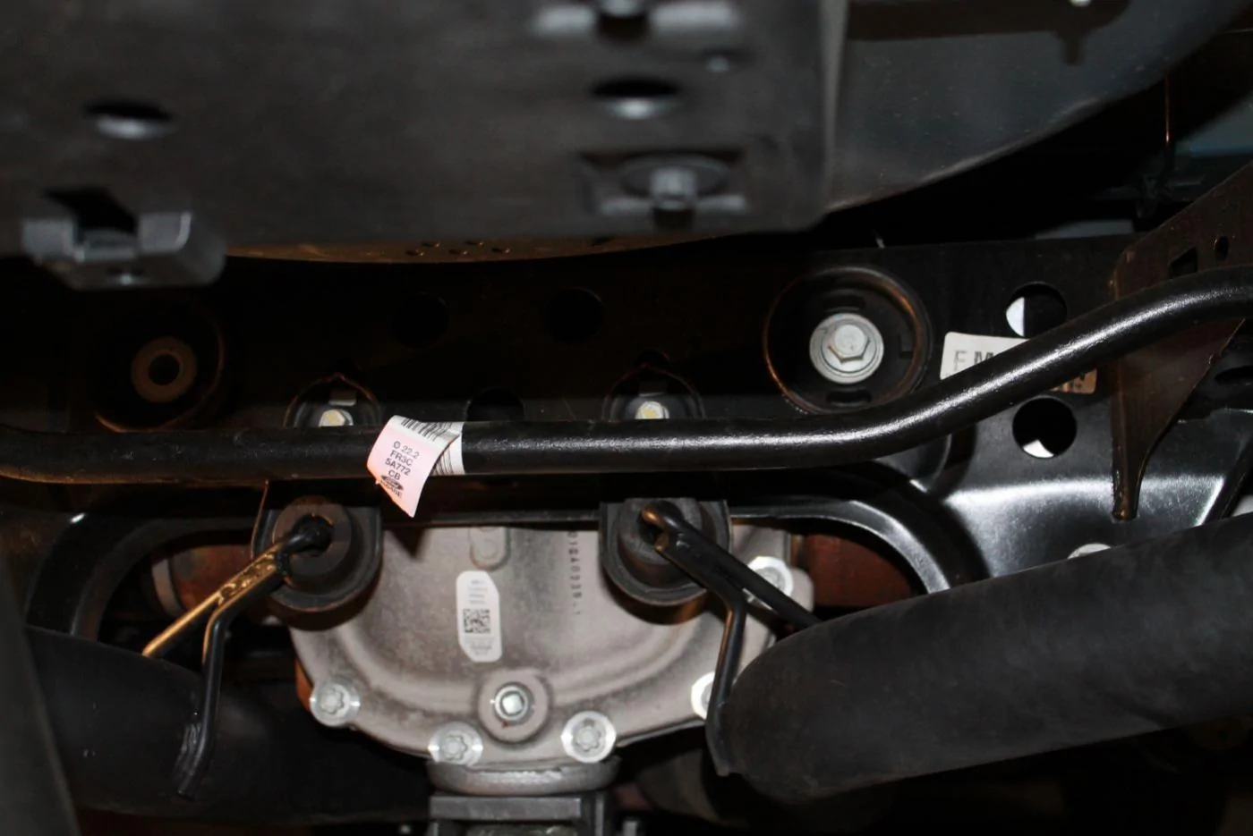

Rear bolts, driver's side removed passenger side stock
Frontmost bolt location (Driver's side), it was difficult to even take a picture of the location, let alone get the bolt in. You can see the removed exhaust as well as clearance issues. This is with the IRS already substantially lowered, had to move the whole IRS towards the passenger side to get in the driver's side bolt and vice versa.

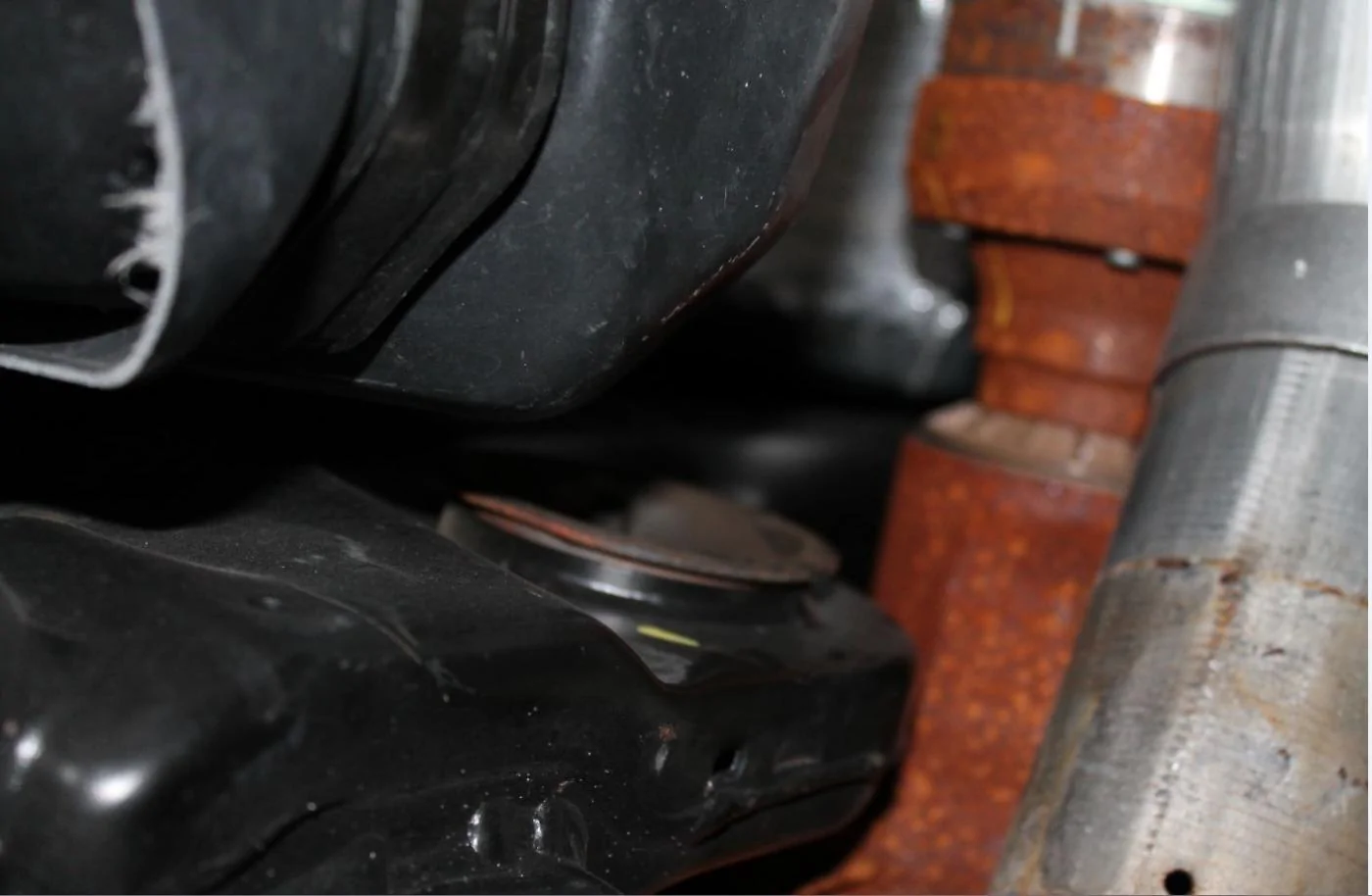

Passenger side front most bolt location. Easier to get to for me, not sure why or if the geometry is different on this side. Did passenger side first then had my buddy hang pull the IRS towards the passenger side to get the driver's side in.

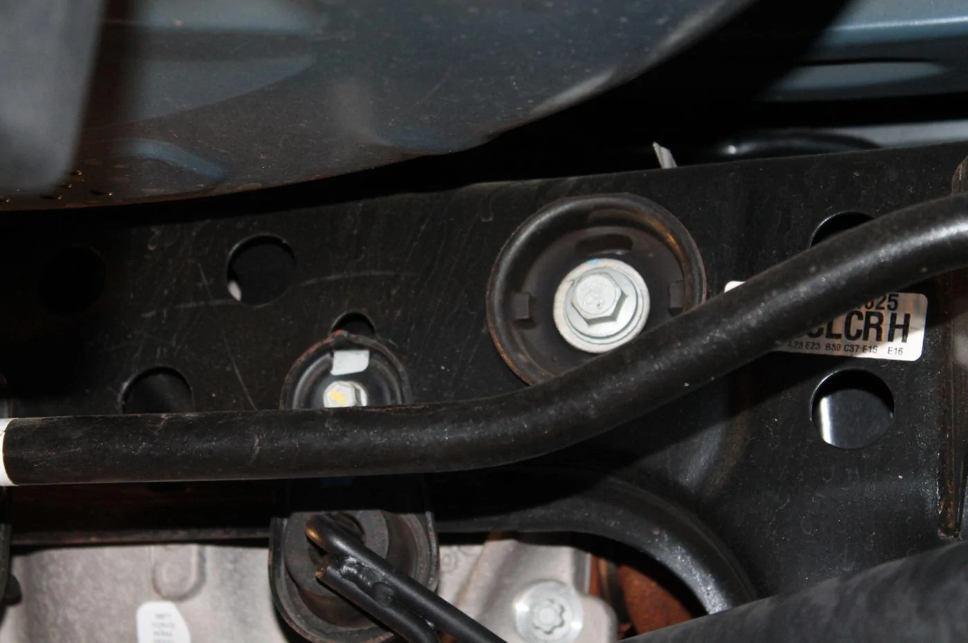

Stock rearward passenger side stock bolt installed.
