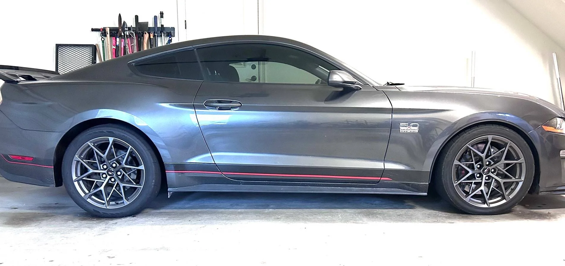

I have a Whipple plus the mach1 HP fender trim so the front looks lower than the rear. I’d like .5-.75 lower in the rear and I think it would match better.

2018 GTPP A10
Here is the issue. This is all stock PP1 springs.
