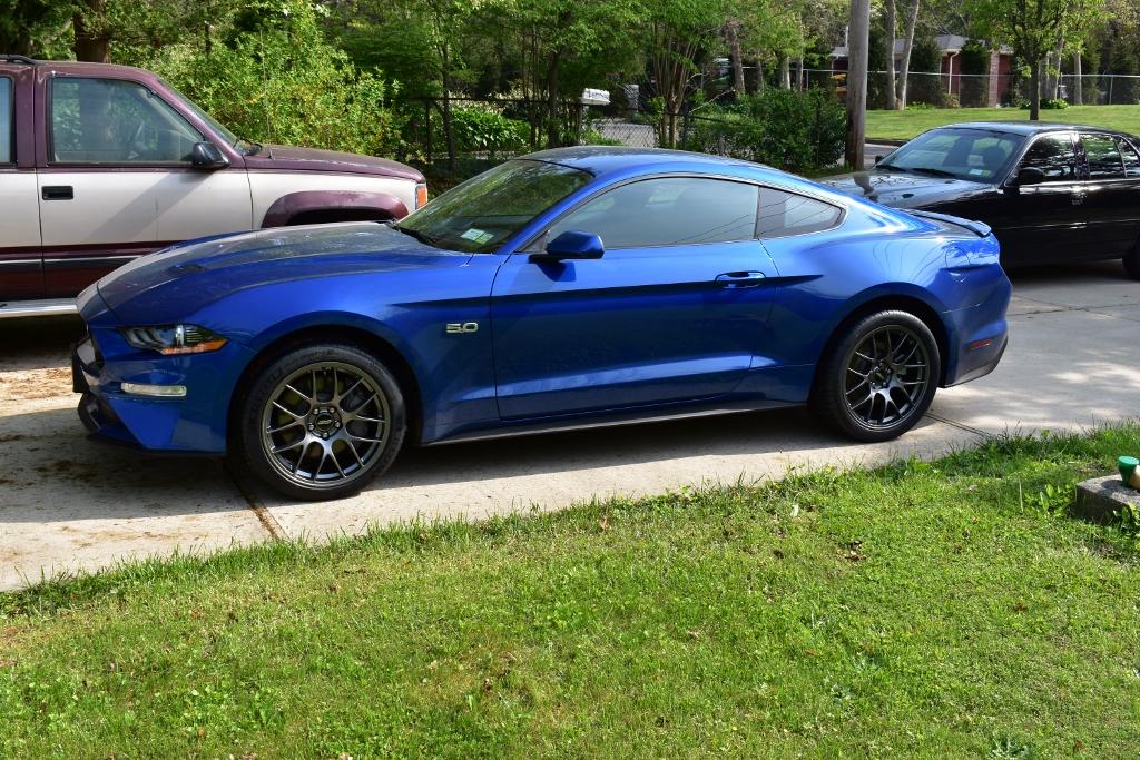

I don't know if this helps.....I used the Steeda drag springs. Drop is 1.25" front and .5" rear.

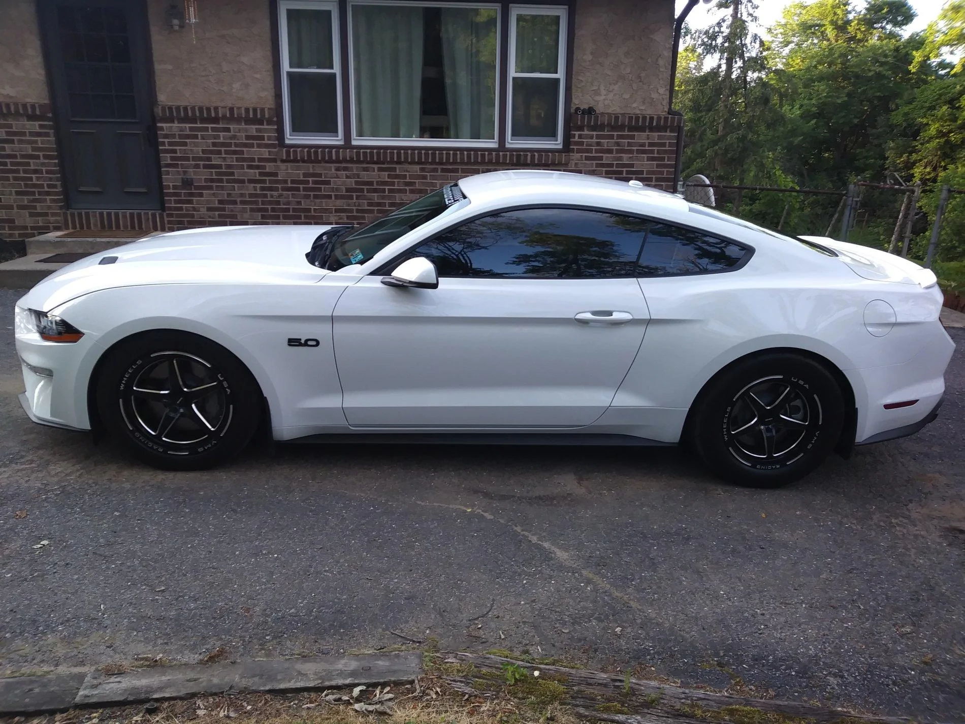

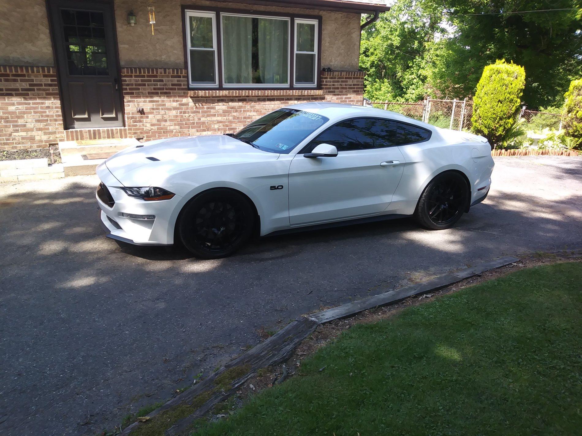

I have bmr drag springs in my 19gt. It does have some rake
91gt331sc
Dec 21, 2018
122
87
Bethlehem Pa
Chris
2019 mustang gt, 2017 mustang gt
With amr wheels, 275/35/20 front. 305/35/20 rear.
91gt331sc
Dec 21, 2018
122
87
Bethlehem Pa
Chris
Drag wheels are 28" front and 305/45/17 (27.9") rear

Nice man I appreciate the info. Do you daily the car? How’s it ride off of the track

Springs work great and still handle pretty well with full size wheels. Not sure how well they would work with extra weight of a power adder up front. I think most people go with minimal drop fronts for that setup
