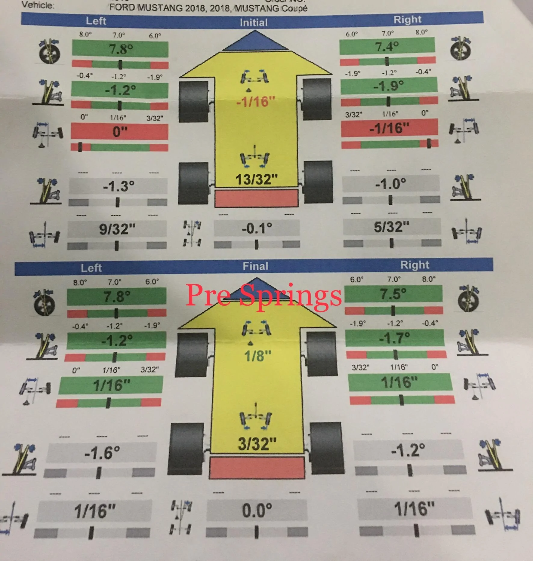

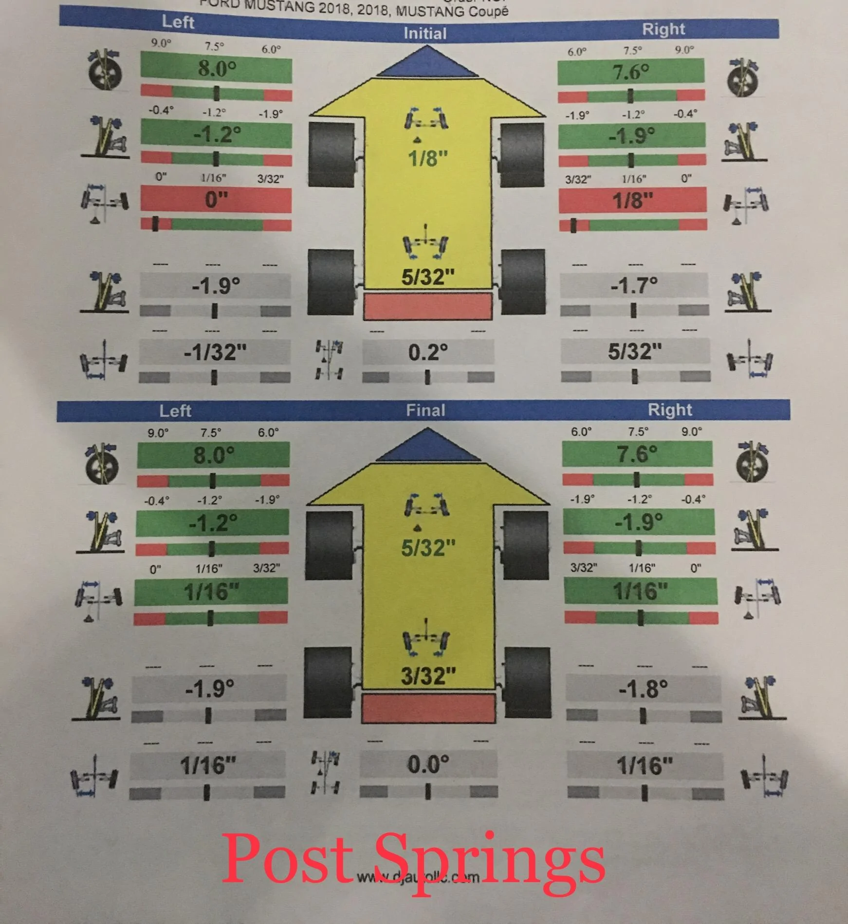

Im interested but do not want to make any performance of the car worse. I want it to be as good or better at everything it currently does. if thats possible. my concern is camber as im a mostly a straight line guy and -2.5 camber is not so good. stock seems to be at -1.5 so i would like to be able to keep that.
I just got my alignment done today. The pre spring picture are the results after installing some BMR suspension parts. The post springs is what was done today.

Thanks! I'm installing on Friday, bought the steeda alignment kit aswell to ensure everything goes on properly.

17 GT350
Odd how your camber is uneven. I would buy camber plates.
