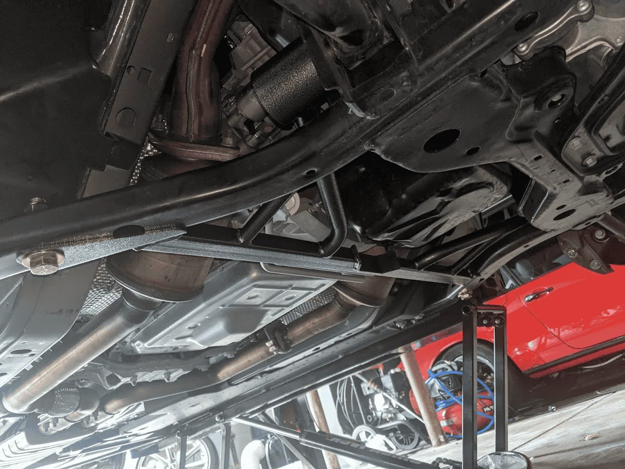

I have the Ford Performance Track Pack suspension with camber bolts (resulting in the -2.5 deg camber). It's pretty stiff. Any firmer and it ceases to be practical as a daily driver. I realize lots of serious track setups are running -3.5 deg with camber plates, but again, not ideal for street driving. Having installed one of the BMR K-braces on my GT vert, I can see how it could theoretically reduce caber change under load. The loaded lower control arm is pushing back against the front sub-frame rail. Any flex of that mount/sub-frame will have a positive impact on camber (reducing negative camber). The K-brace triangulates the lower control arm mounting point with the sub-frame, and ties the two from sub frames together. Again, just wondering if anyone installed one of these and noticed any changes (improvement) in tire wear.
What I'm seeing from BMR's CB006 pictures ties the subframe rails together laterally without allowing relative lateral movement. The other two mounting points appear to be bushed, so there's still going to be some lateral movement even if they use polyurethane bushings.
There might be a smallish outside tire camber benefit in hard cornering, but I doubt it to be worth much more than a tenth of a degree or two out at 1g lateral. Keep in mind that as the outside tire is trying to push everything inward, the inside tire is trying to pull everything in the same direction as well, so your benefit becomes the difference between these effects rather than the outboard tire's improvement taken in isolation.
Norm
I installed one on my '17 GT vert. There are no bushings. All four mounting points are metal to metal.
Metal to metal would not change my estimate of a tenth of a degree outside camber improvement by enough to matter. It's a diminishing returns kind of thing where the first amount of stiffness increase buys you more improvement than subsequent stiffness increases. After considering a poly bushing case, there isn't much room left for camber improvement here by going full-solid.
Norm
You shed some light on something I completely overlooked, lower control arm bushings. I should've thought of these when I installed the FP Track Pack last year. Yes, I definitely agree the poly bushings would help more than the K-brace. However, the K-brace is cheap enough, and so easy to install, I'll probably throw it on too. I do think it helped to reduce the "jiggle" in the front suspension on my convertible (understanding that the vert is more flexy than the coupe).
Norm
Generally, braces like these improve the chassis response characteristics. I agree that it won't make much of a difference on the camber of the tire, but it may improve the feel of the car in a way which makes it beneficial. I have the straight across brace (it doesn't tie into the front mounts like this one). I think it might tighten things up a bit, but it's difficult to really know without a proper back-to-back run on a course I'm familiar. That will never really happen, so I carry it around to make me feel good.
