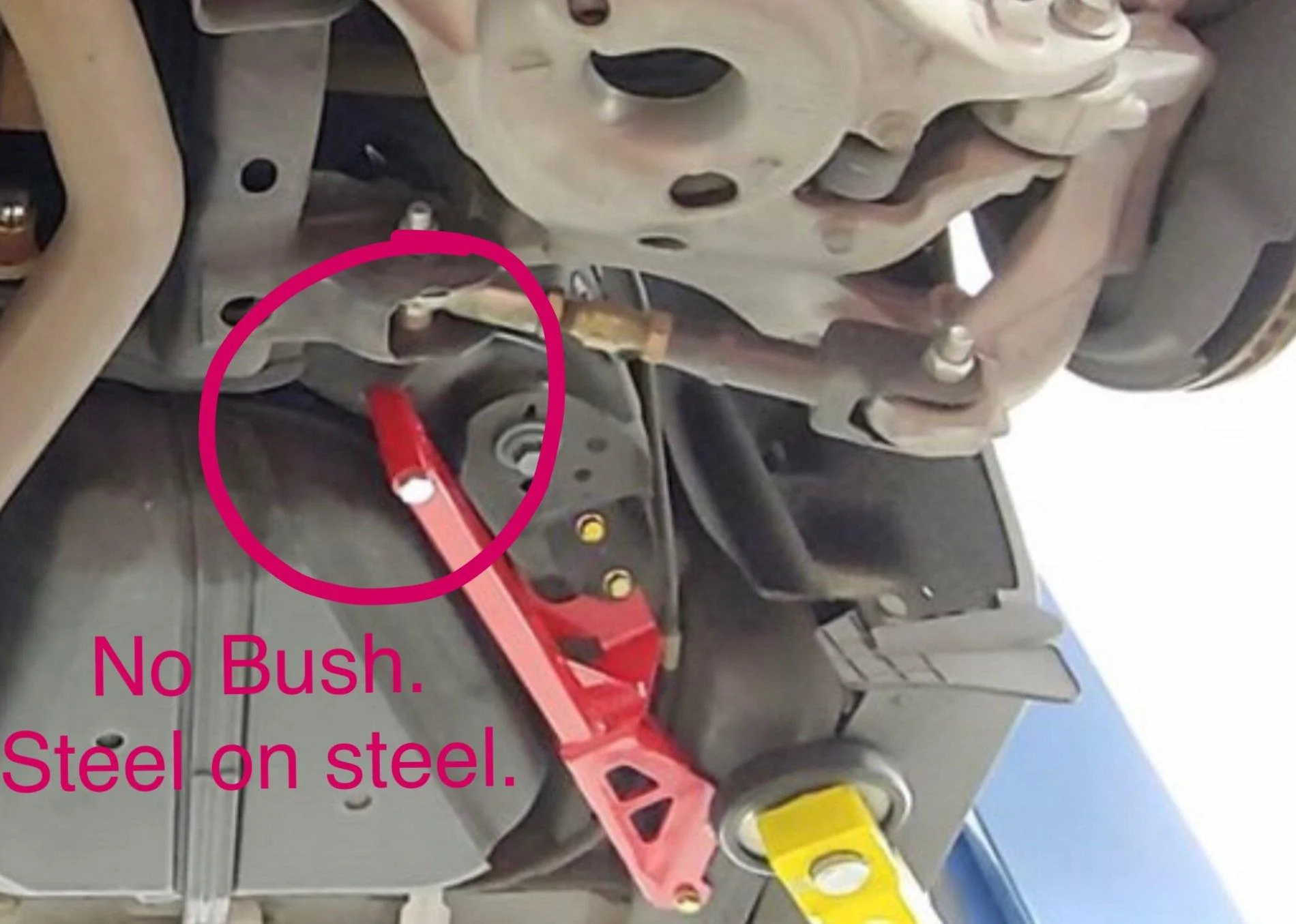

I could be totally wrong here but my understanding (based on what I can see) is that the CB762 does everything the CB005 does, but slightly better.
Having said that, the CB762 (IMO) is likely to transmit “some” noise into the car, although the level of noise will be entirely dependant on the other mods you might have in the rear already.
Eg. If you have a more solid diff-bush, I’d expect the extra noise transmitted into the cradle to be sent more directly into the vehicle.
In summary...
If you’re worried about NVH and already have other “noisy” parts in the rear, go CB005
If you’re more or less stock, the CB762 might be just fine.
If you’re already at “race car” noise and need more stability, just do it.
Pic below of why noise might be transmitted into vehicle more easily.
I’d be happy to be schooled in the matter by @BMR Tech though....

@Burkey we've gone way beyond my understanding already lol, but agree the metal on metal should as a result of logic mean it'll increase vibration
