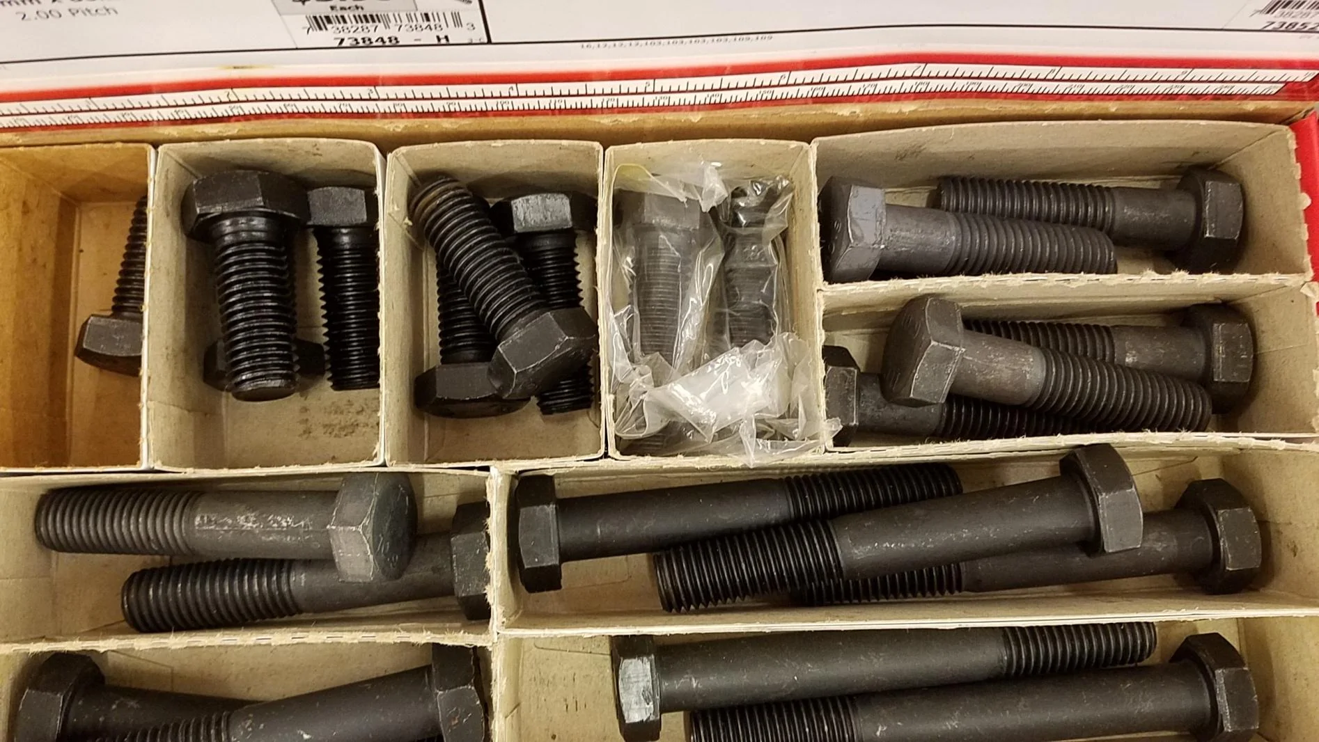

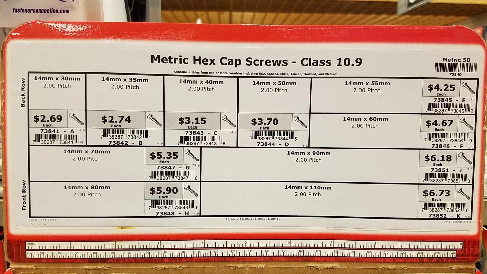

Found this at my local hardware store. These are 10.9 grade.
Doing the math it's around $30, and that is without washers or sleeves.

Right diameter/pitch. Wrong lengths. Maybe you can use 110 instead of 100.
I've got mine all torn apart. I need to see bolt orientation and what not.
Yeah, they're not cheap. I found 115mm just need to know what that means exactly.

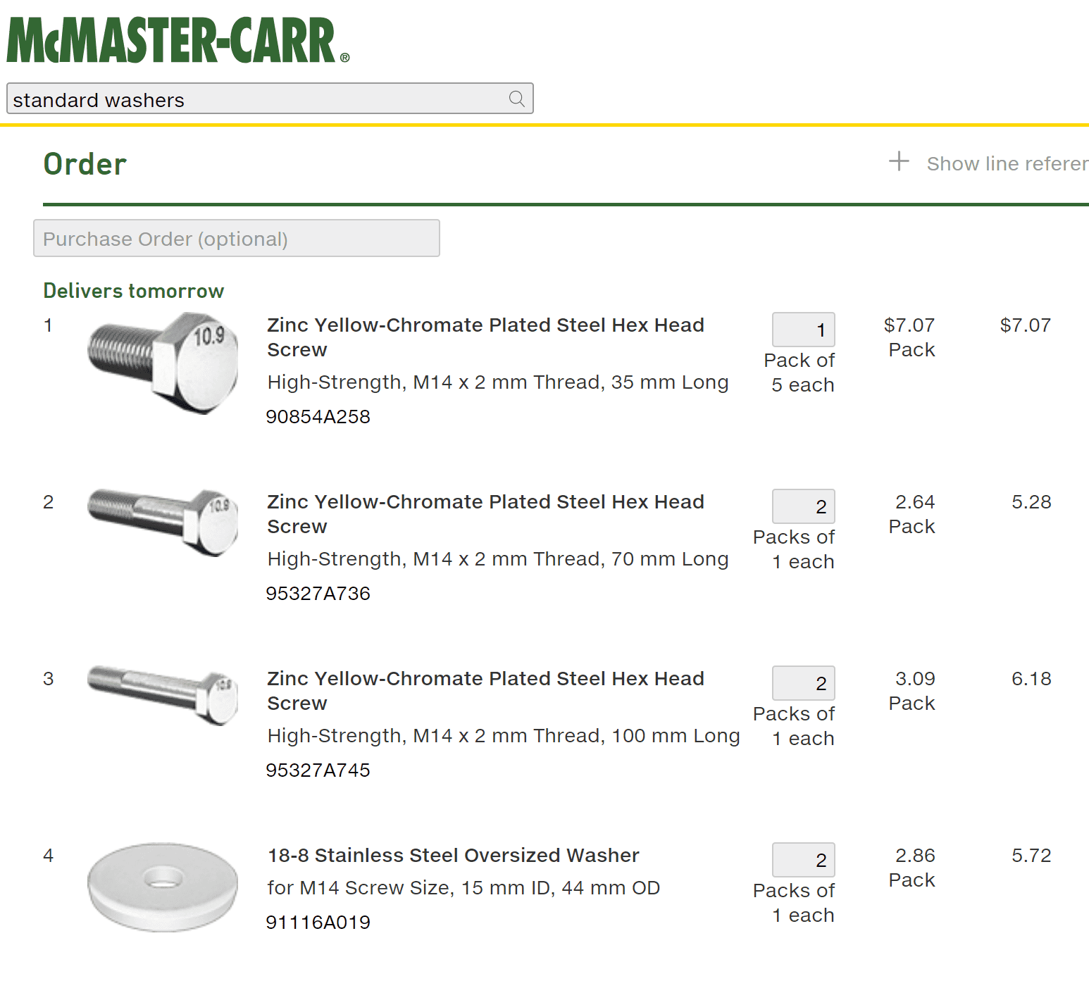

Here is a McMaster order I started working on, $24. 3 extra bolts of one size. Price and selection is better than local, but it is hard to be 100% confident that everything is right.
The complete BMR kit is nice and comes with a lot of stuff. I can see where the pricing comes from now.

Because the BMR instruction said 35, 65, 100mm IIRC. Hard to be sure of all this.
Actually, it's not really nice for us to reverse engineer others' work, but hey, we tend to do that. :lol:
https://www.bmrsuspension.com/siteart/install/BK050.pdf
No mention of a 35mm or 65mm. I talked to Kelly on Monday. 100mm and 120mm. 4 bolts. 2 m14x2.0 poly lock nuts, 6 washers. That's it.
Looking at this further, I wonder if you don't have BK054 or BK051 which do come with 3 sets of bolts. Quite possibly what you're looking for.
