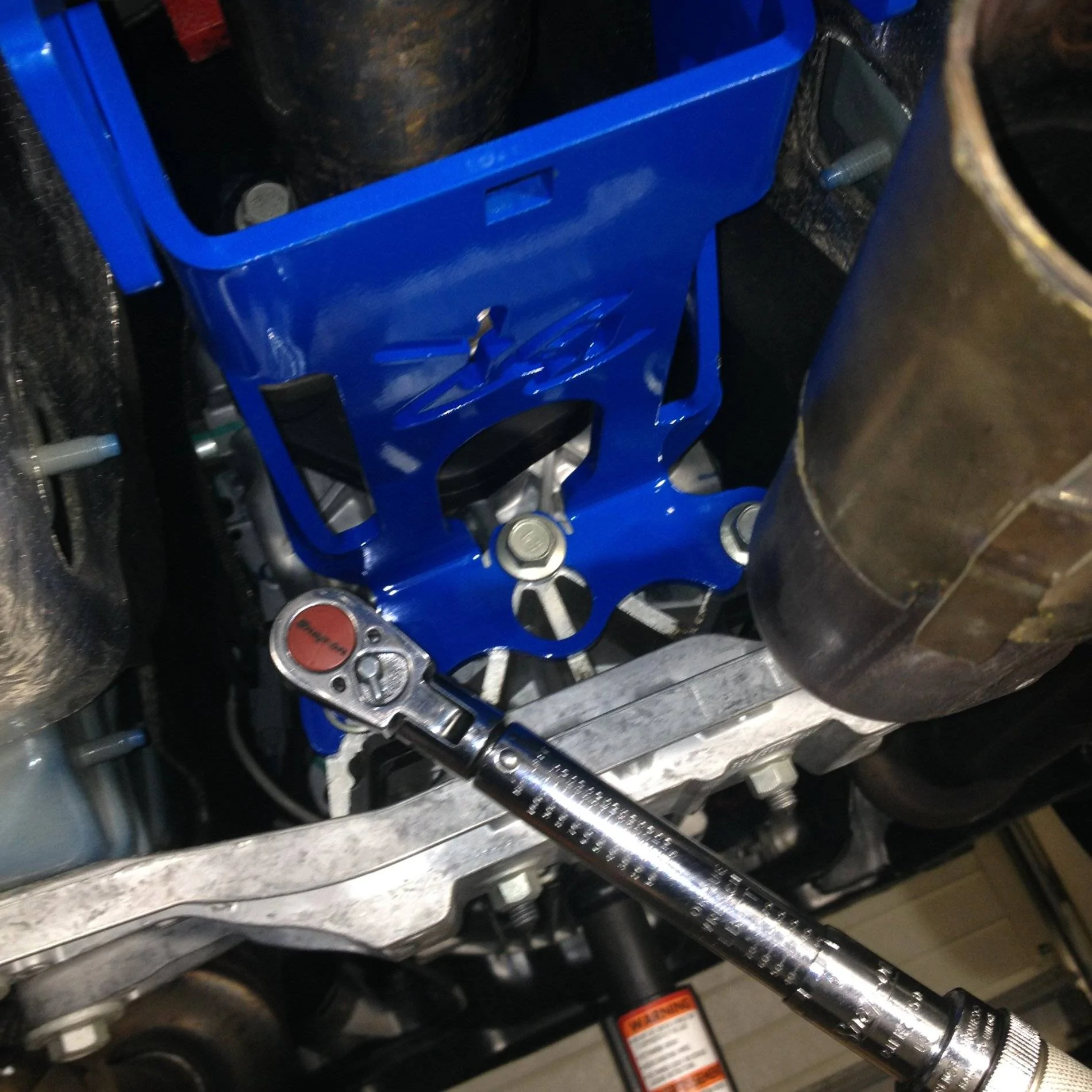

A quote from another thread I answered. "Installed mine, no hoist. Biggest problem I had was the tunnel boot dropped along with the shifter as the rear shifter body mount was removed. It was hard to refit from under the car. I wedged the shifter so it wouldn't drop from it's own weight while installing the Blowfish bracket. One of the few mods I've done with really noticeable results. Made sure bracket was aligned, raised and clearanced as close to tunnel as possible so shifter was in original position and there wouldn't be tugging on the tunnel boot. OEM shifter is fine now although it could use a white shift knob for accent."

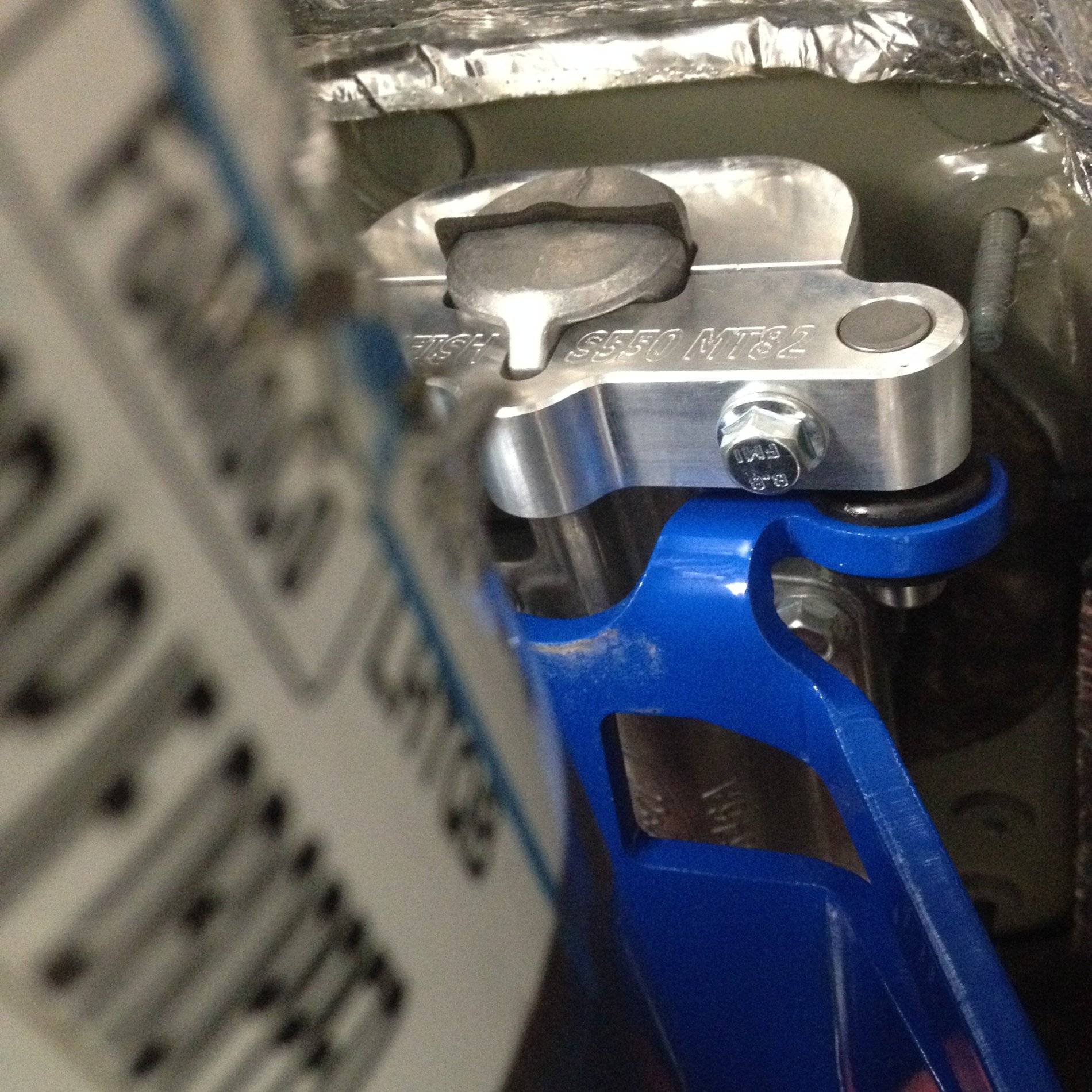

So I had done basically as Blowfish suggested. Just make sure the weather seal "boot" is still fastened to the floor after the install or engine heat and noise will get under your console. The boot has a double lip that must be positioned with one lip above the tunnel hole and the other below. If it falls down while installing the bracket it is very hard to reinstall from underneath with a screwdriver and pick as there is very little room to maneuver the tools.

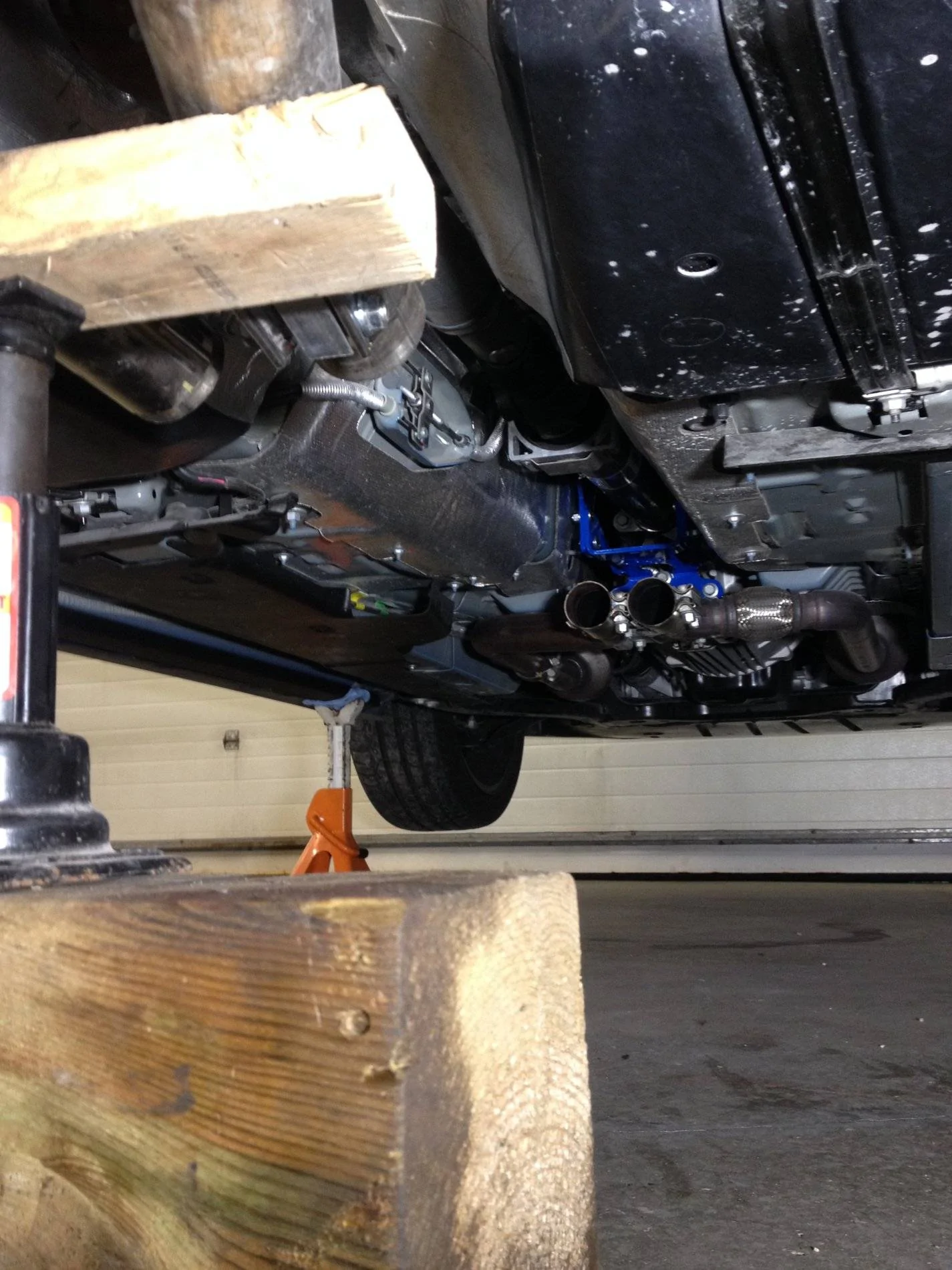

You can see in the first picture I used a support with just light pressure under the trans just in case loosening the 3 mount bolts, it wouldn't let the trans drop or shift. 2nd pic you can see barely just to the right, part of the boot lip I was mentioning. I also smeared a bit of silicone grease into the pin grommet.

Previously installed Steeda H-Pipe removed to help with Blowfish bracket install. Also installed Steeda full length, low profile jacking rails.
