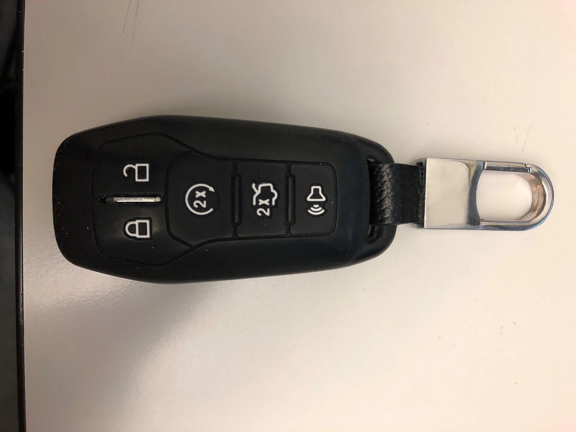

I have a 2018 key programmed to my 2015. As long as the remote is the same frequency, it can be programmed if you already have two programmed keys. The easiest way to figure out if it's the same frequency is matching the button combo on the keys (5-button VS 4-button, with remote start VS without remote start, etc.) Other threads and members have said that the key's FCC ID needs to match, but that was not necessary in my case as only the button combo and frequency needed to match.
Thanks Kasavias! I found a 5 button one for $57 so it's worth a try especially since you were able to get yours to work. Definitely prefer the new keys over the old rounded ones
