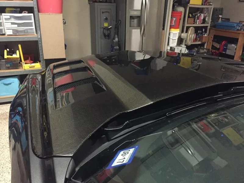

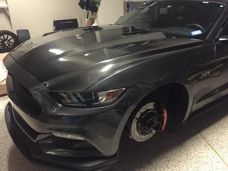

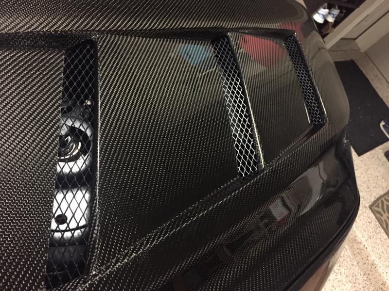

Hows your hood vented?
You still have cowl and battery cover?
Or just using standard vents?
I have an Anderson heat extractor hood, battery cover removed, but still have that cowl under the windscreen wipers. Should I try remove that as well?

Totally dont know w your hood. Think your hooooood is gooooood.
If you pull coping:
Tape yarn on back edge n watch the flow change on your way up to 120?
Thats what I did. 30-60 it sux back in, after that its out...but my lower grill out too.
