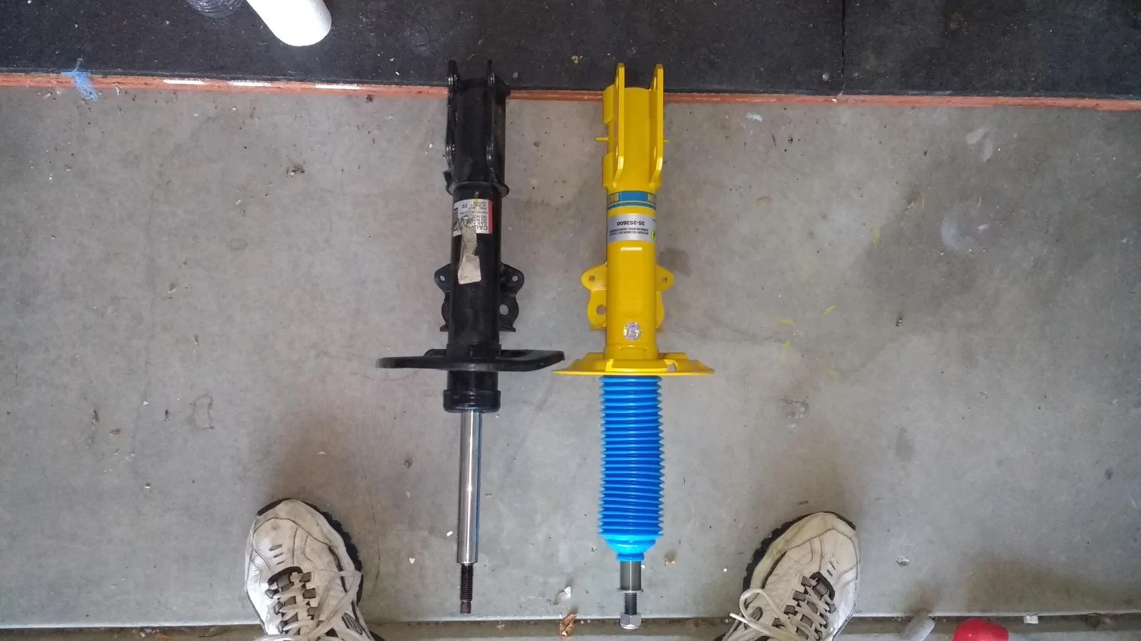

2015 Ecoboost Premium PP M/T Competition Orange
Here's a pic of the dampers side by side

When did these come out? I would have gotten them. But I agree, wait until you get the springs. Why do the same thing twice?
