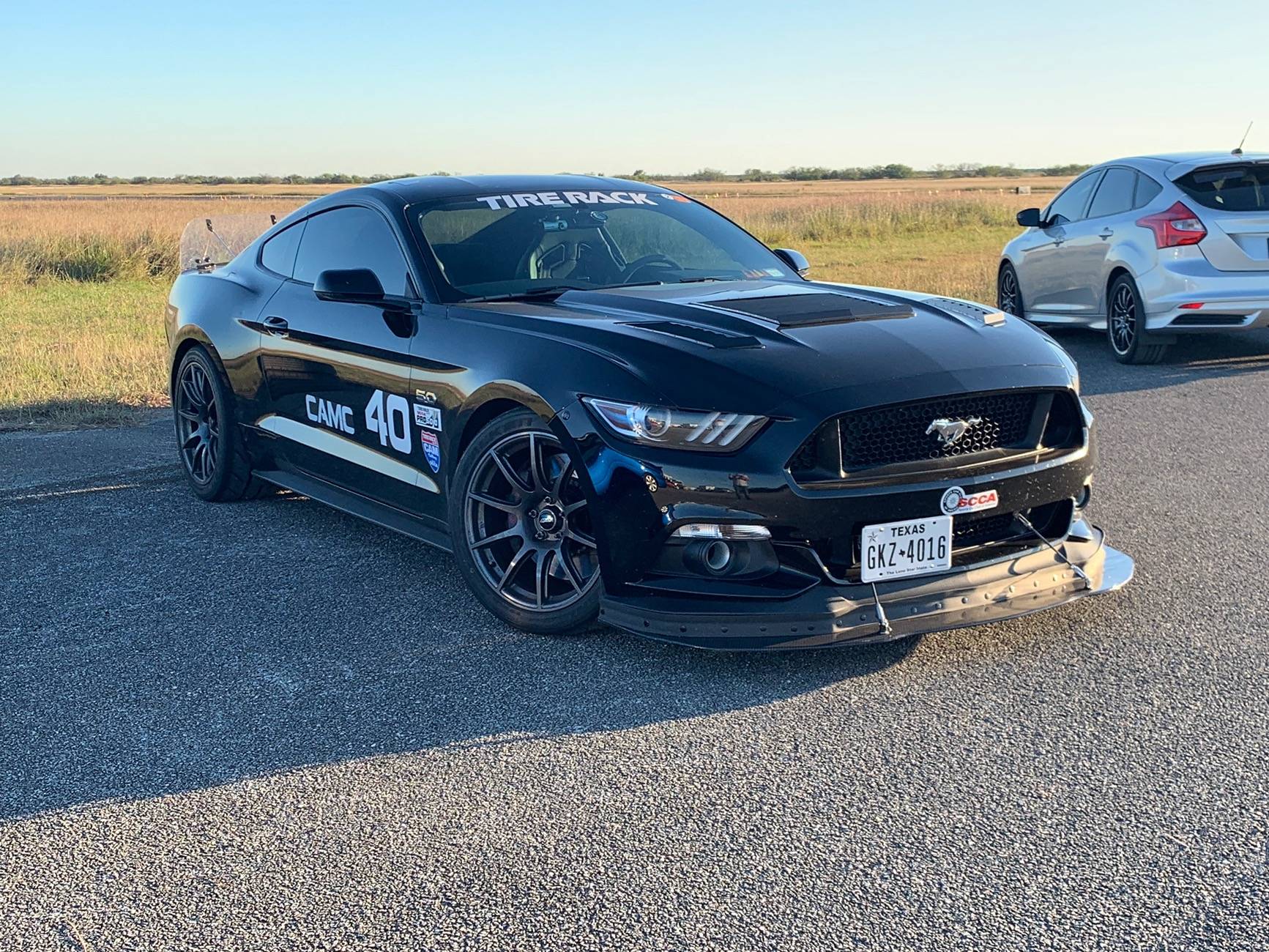

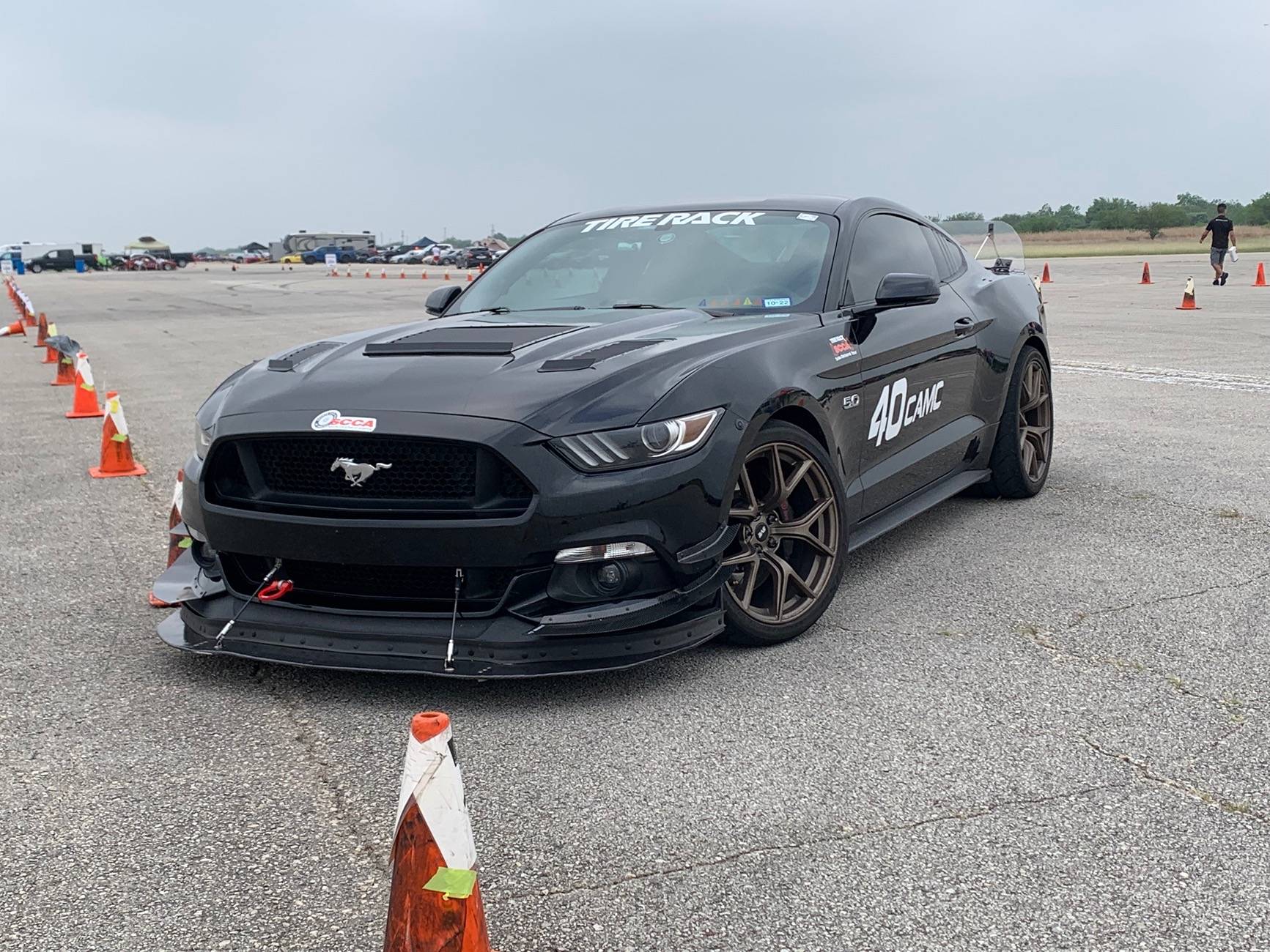

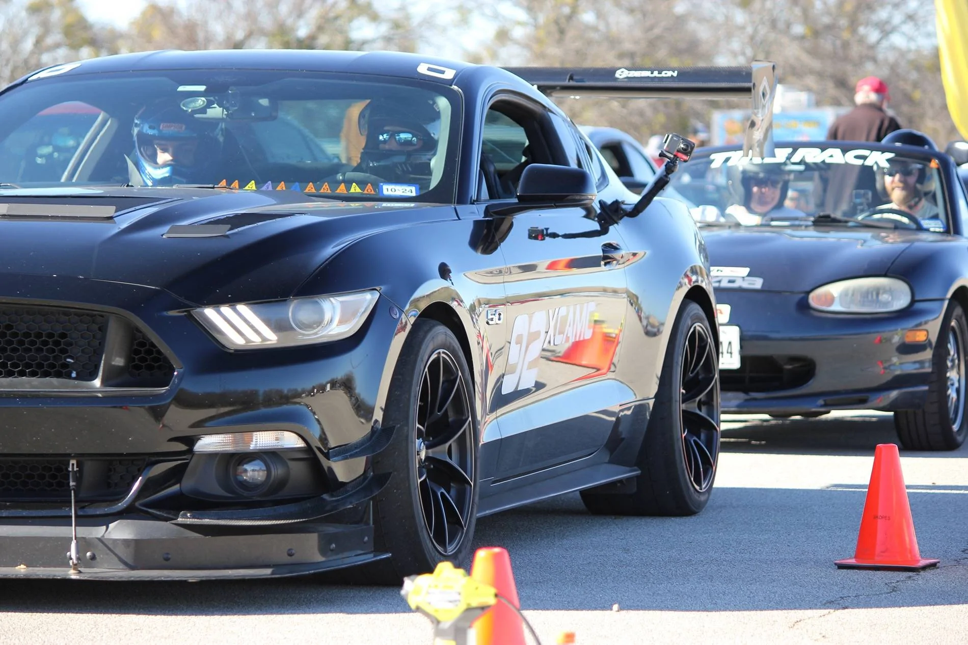

Apex SM-10 19x11 Anthracite
SVE 19x11 Bronze (LMR)
Apex VS5RS 18x11.5 Black

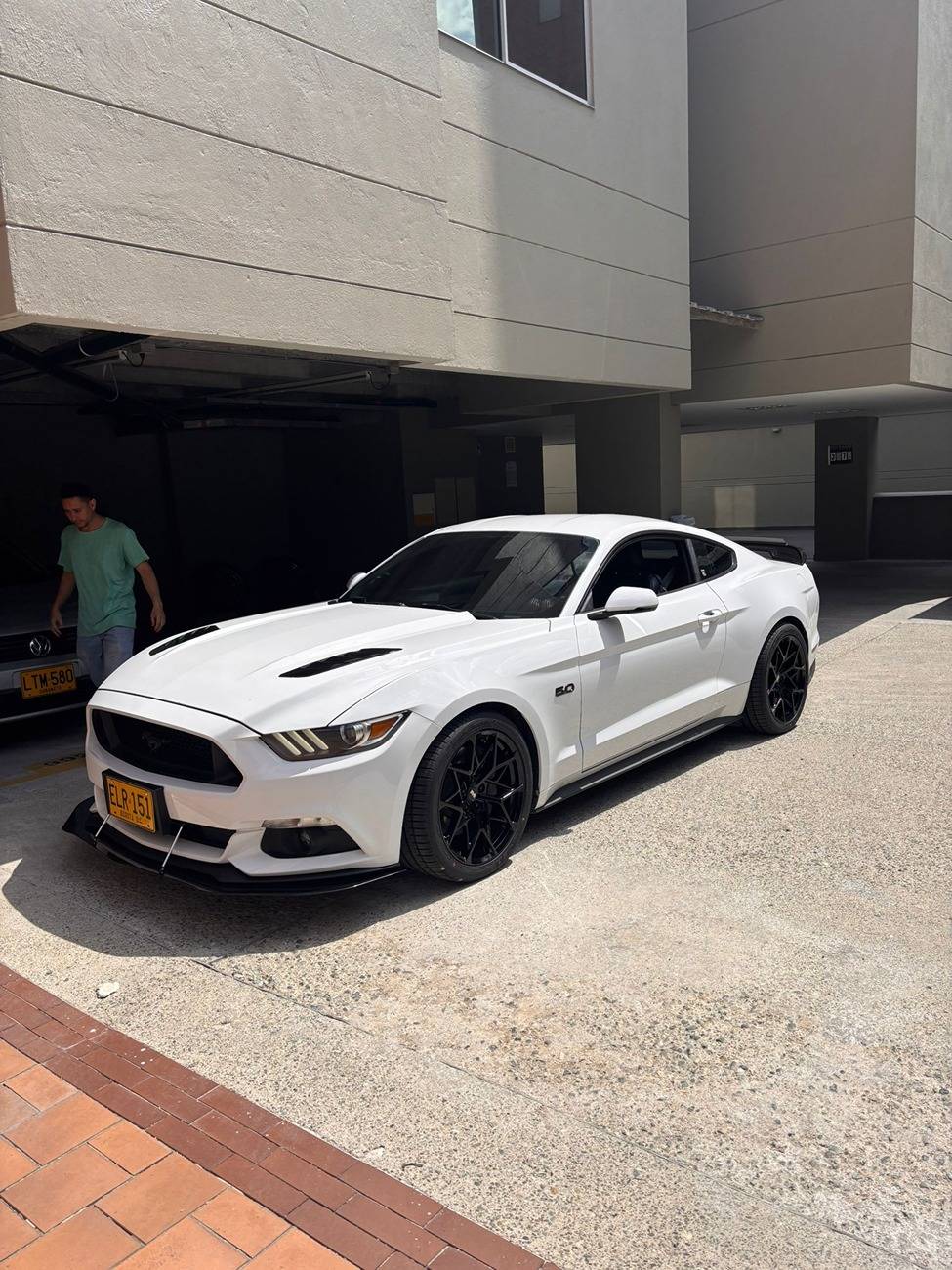

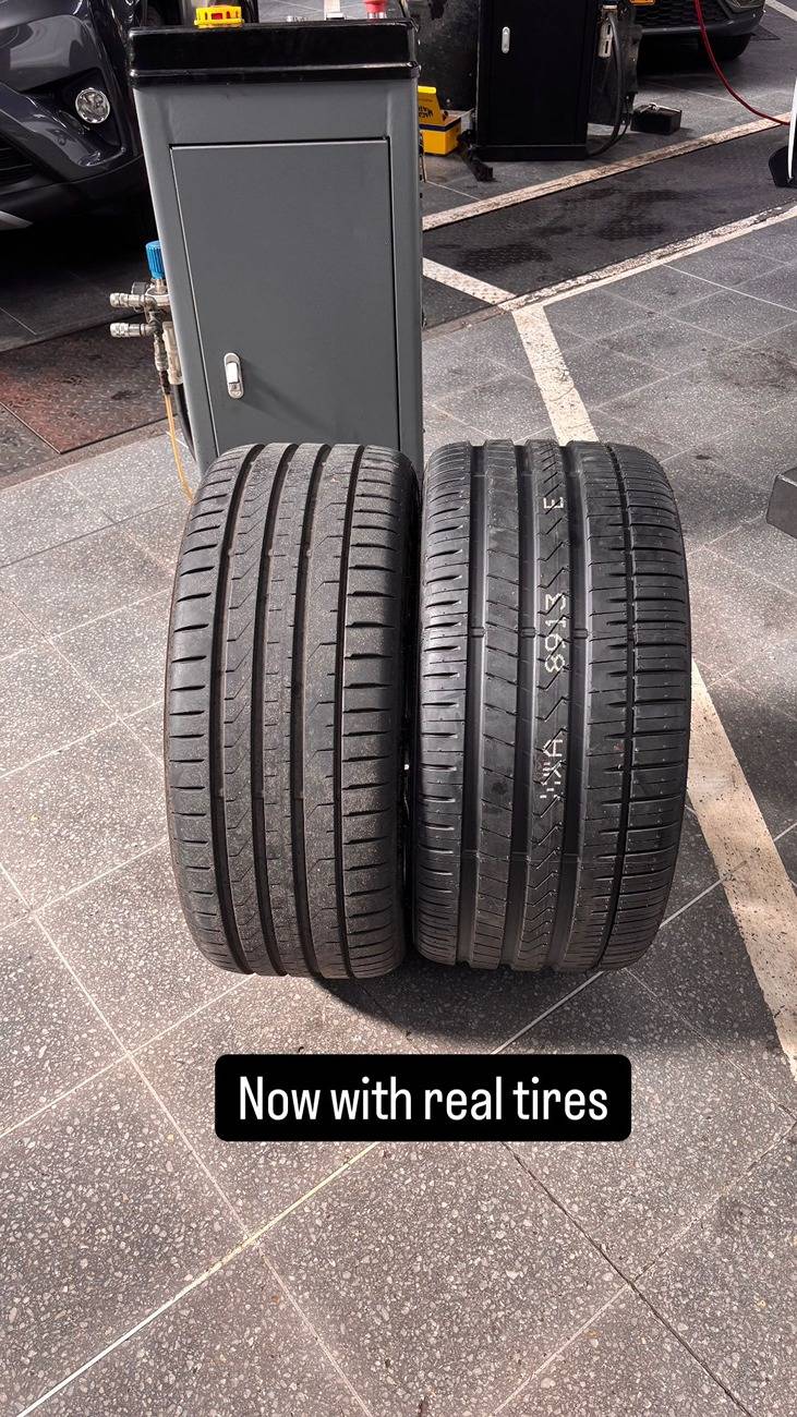

I looked at wheels for like 4 months before deciding on the LMR MHP1 19x10 squared with Falken FK510 285/35r19. The lighter wheels were noticeable in a sense that the suspension works better and is smoother on rough roads. I'm the type of guy that doesn't mind spending money, but I am sure that I am getting the best dollar-to-value. After looking at all the cast wheel options and flow formed. LMR was the best choice. Even thought about doing PP1 replica wheels from AM muscle with spacers, but I always ended up at LMR for just a little more money. Even the other flow formed options weren't in stock or they didn't have the correct size and offset, so it was always a compromise and only saved a little money. I mounted them up a week ago and took it on mountain roads. I love having wide tires. But now I have a little bit of tramlining so I have on order the PP cowl extension brace and PP k-member brace. If that doesnt do it then I'll do a BMR 4 point brace up front. My suspension is tight bc its all new, so I think the tramlining is caused by all the extra grip on uneven roads, is causing the chassis to flex and subtle alignment changes. I'll update next weekend after I got it all installed. Just wanted to give you my full experience. Hope this helps.
