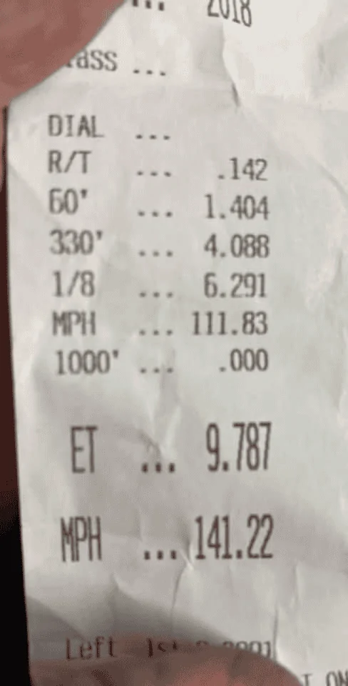

Andy,
If you give our build team a call - they can point you in the right direction. Our Silver Bullet just ran a personal best 9.787 ... which is also made for the streets.

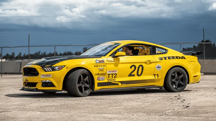

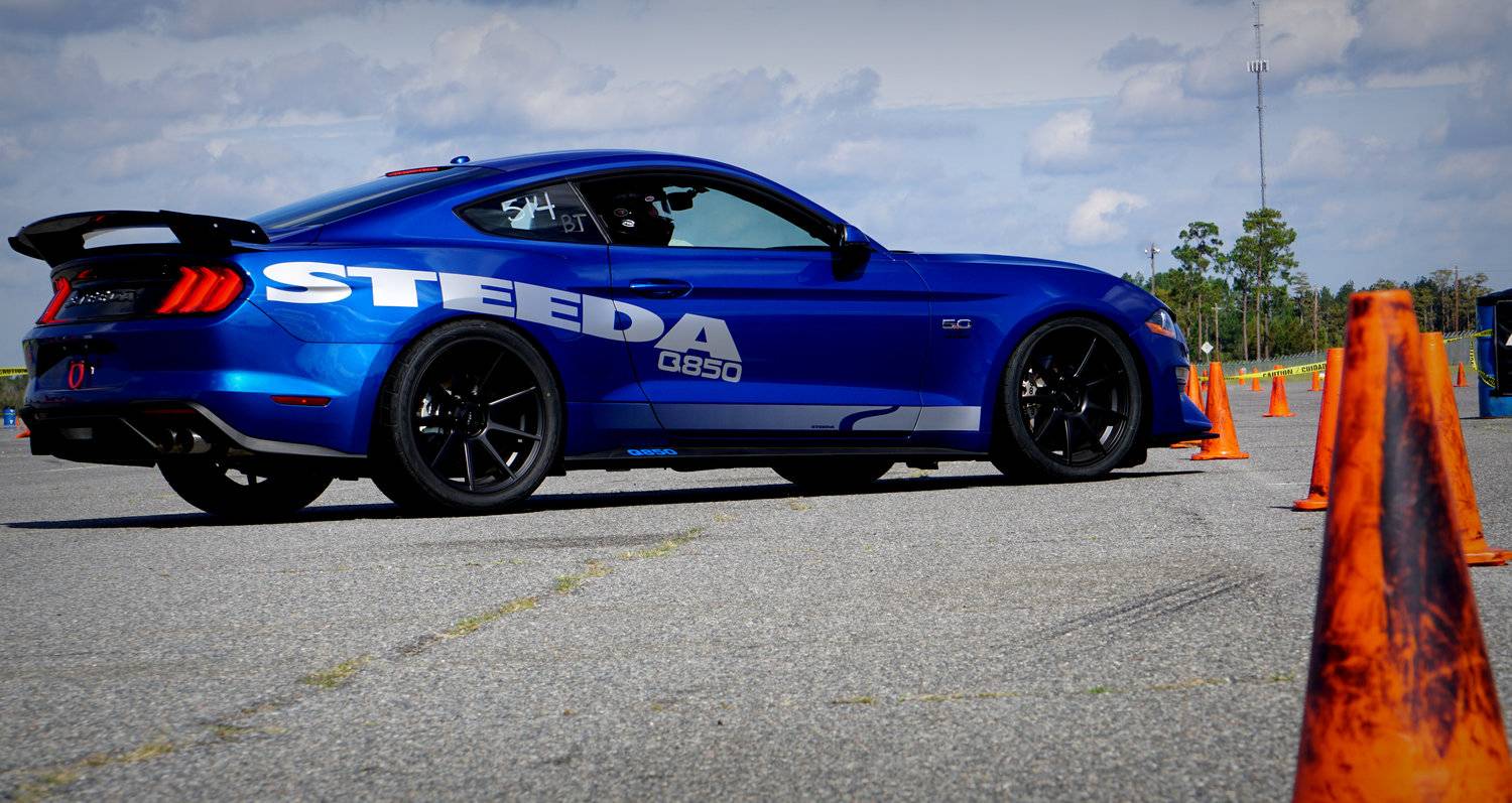

We also have our track set-up ... we can blend the best of both worlds :)
