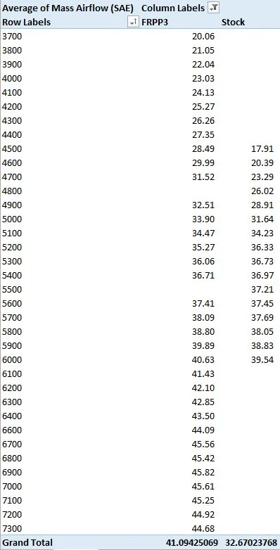

Do you have any dyno results of that? I'd be interested to see this "gain in low end torque" because all I've seen is losing some 20-30rwtq until 6000rpm.
Just LOTS of logs between Stock and the FRPP (Ford tune).
Attached are MAF airflow compares. GT350 is on average using 2-3lb/min more of air below 5k, they just about even out at 5k (which is why you don't see peak increases in torque) and clearly you can see how it flows past 6k.
