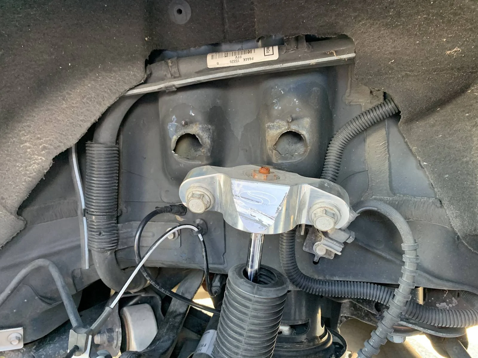

It's definitely been a while since an update has been posted here. The car is still around and still causing me headaches.

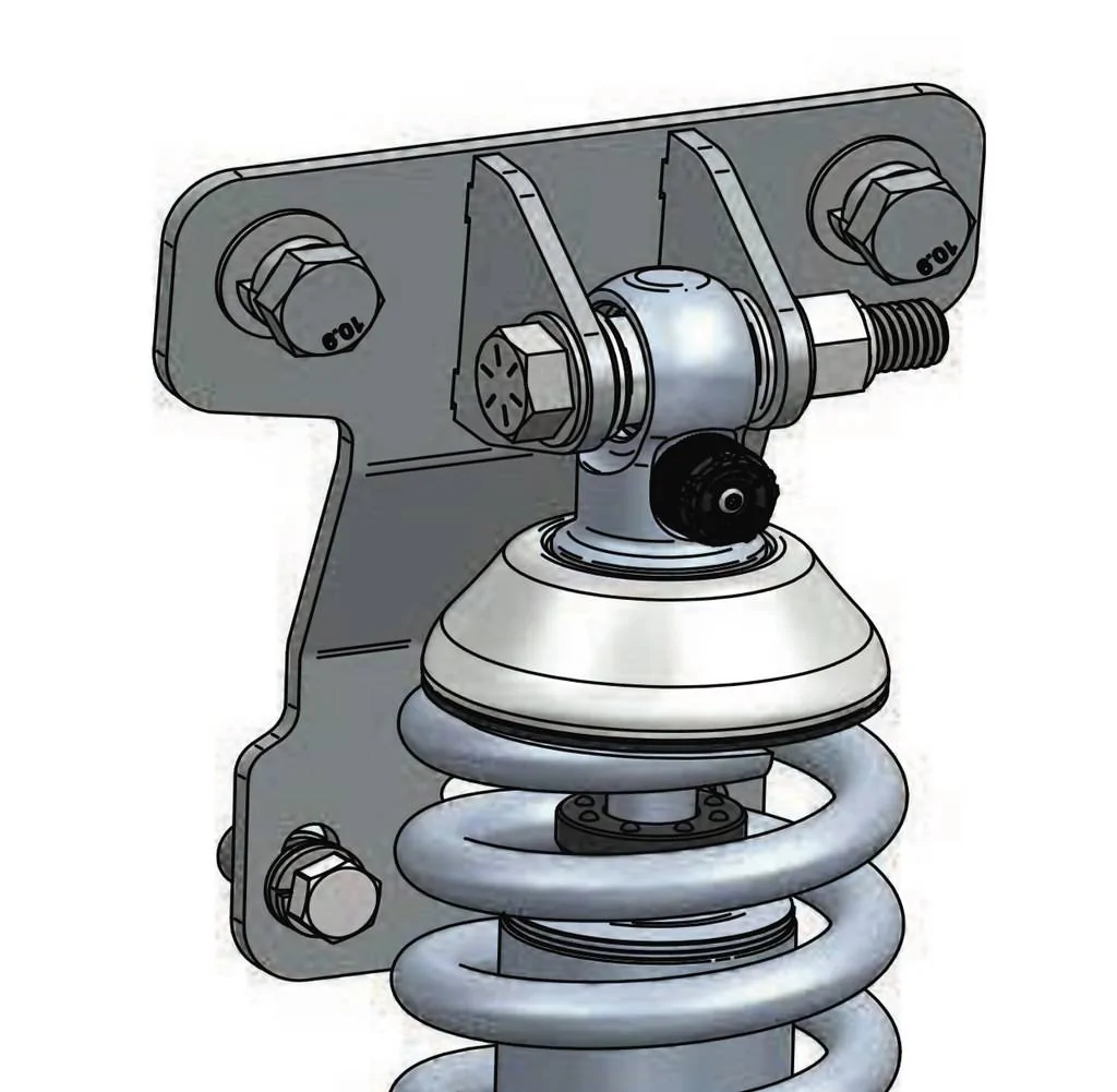

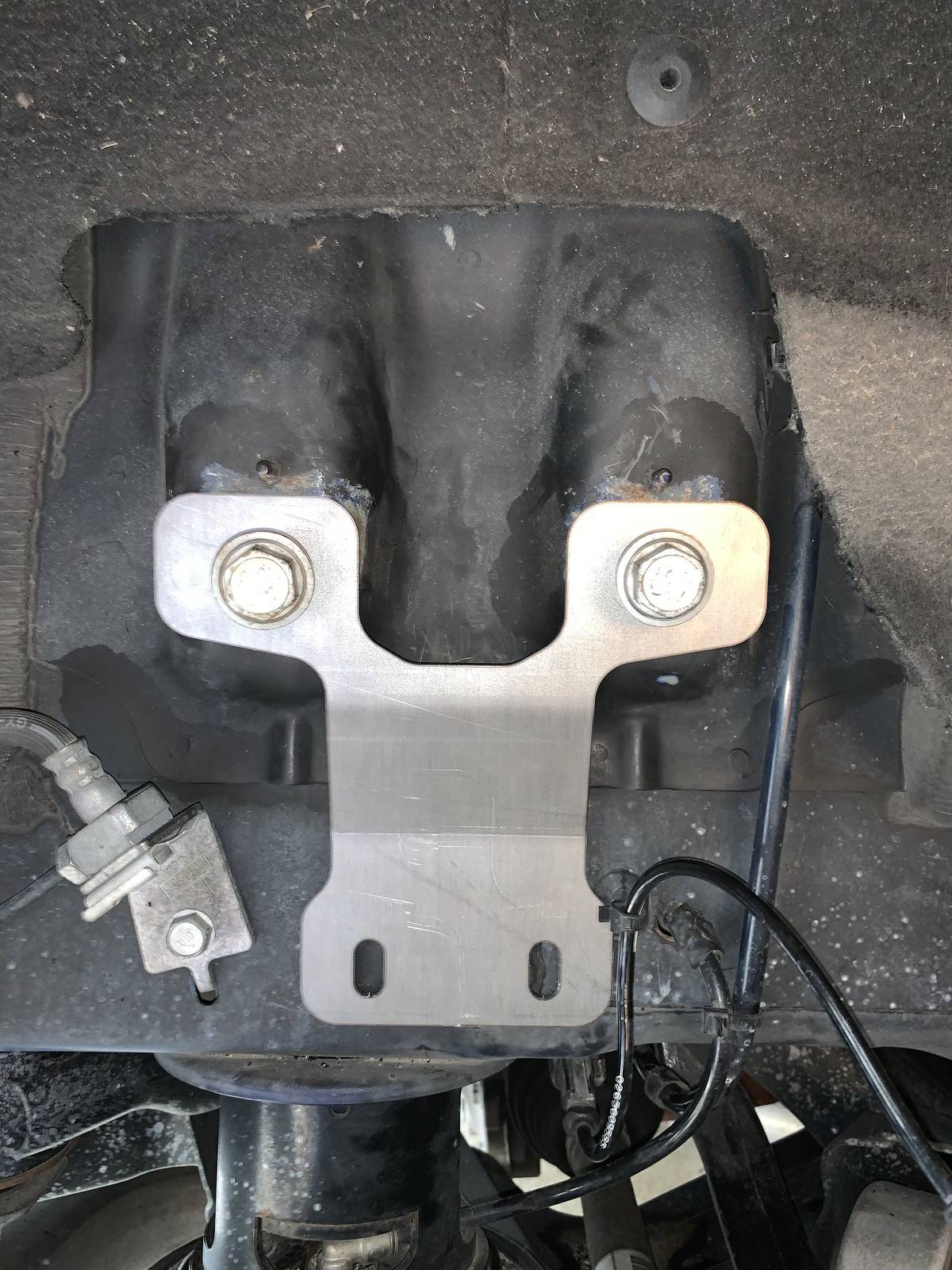

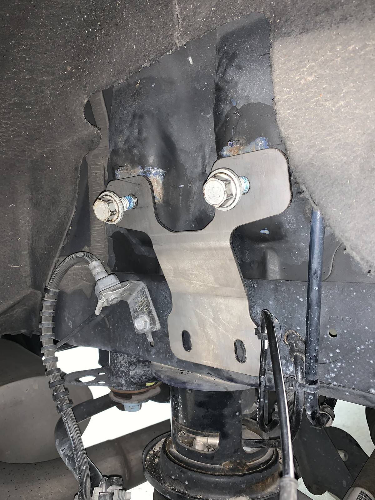

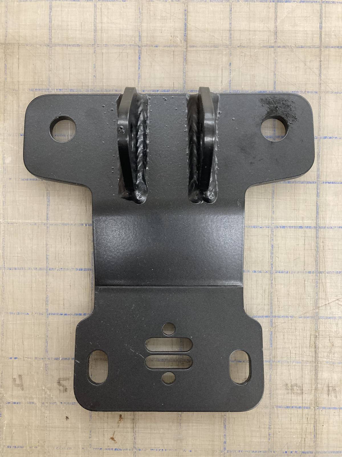

I had an issue where my rigid shock mount caused my bolts to sheer out of the body. I can confirm no metal on metal contact ever happened; I am thinking most likely dampening caused the issue. I've been working through an update to see what may fix the issue since no one really wants to touch it from a service/speed shop standpoint.

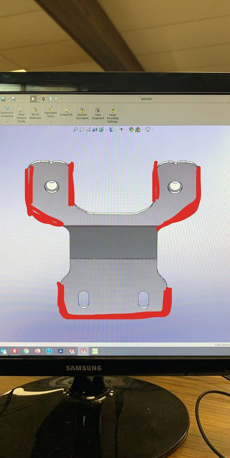

The design is pretty similar to RideTech's upper rear mount for their true coilover conversion. Instead of only bolting the play into position my goal is to weld this new plate (shown in the image with red scribbles) in position. Instead of bolting directly to the top of a coilover, the goal is to use any standard/factory/factory style upper rear shock mount with any factory shock replacement; i.e. BC coils, Airlift shocks, Viking, etc.
The biggest issue for me specifically is being able to transfer the fix from the passenger side (unphased by the issue) to the driverside (with pulled out nuts).
I've gone through a couple different design iterations at this point already but I should be getting something squared away as a permanent fix this weekend. Most likely overkill but definitely don't want to run into this issue again.

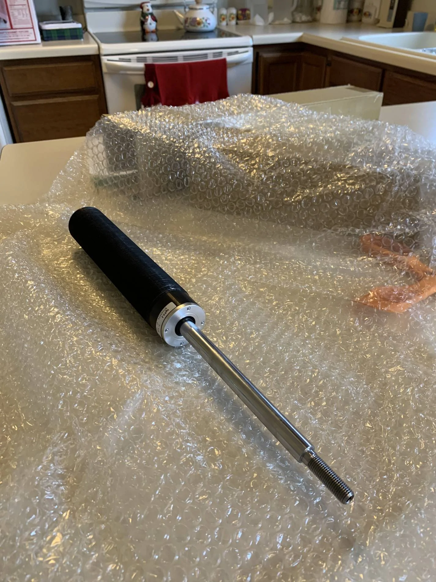

Your pic of the shock on your kitchen counter threw me for a loop - I think we have the same house, LOL! Is there a walk door leading into a double garage to the left not seen in the picture by chance?
I even had the same stove until last year. Crazy.

This is funny! Actually no; there is a wall to the left and of the other side is the living room. My house is a TriLevel and its oriented into the side of slope. The double wide, double deep, (28'w x 44'd) garage is half a floor below and 30' behind me in that picture!
