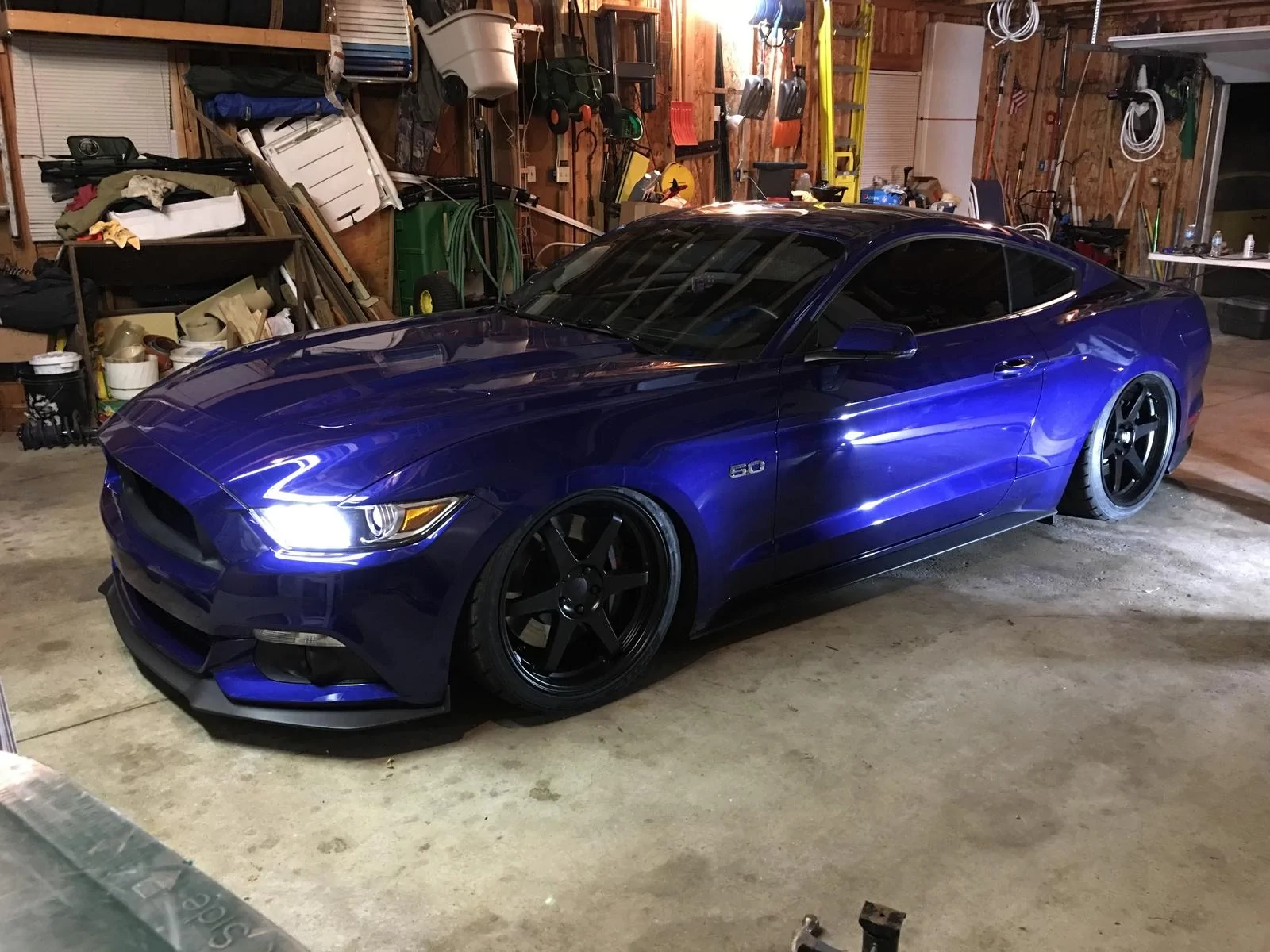

I finished the Airlift Install in March of 2017. I ordered the spoiler and roof visor as well. I had to have the spoiler painted. I opted to go with Gloss Black. I did this because I was planning on getting the roof and hood vents wrapped Gloss Black as well; this has not happened yet.
Summer 2017 was fairly quiet for mods again. My ride height is fairly low and eventually I blew out a stock rear shock mount. The stock mounts are absolutely garbage. The stocks were replaced with the Steeda Billet mounts. These have amazing build quality. They fit NEARLY perfect. The only gripe that I have with them, they do not sit in the EXACT same position as the stock mounts. They force the top of the shock down about 1/4” lower than the factory mounts. This means not being “as low” and that’s something important for me being on Airlift suspension and all.
First Photo with the wheels before installing the bags:
First photo with the car aired out on in the garage after checking for all the leaks and on the alignment rack. This is also the first look at the ride height:
Some may be interested in the air setup. This is all that can really be down. The manifold is mounted on the rear of the cross bar. The tank is mounted on the bottom of the cross bar portion of the unibody. All the airlines are run under the carpet in the car or directly out of the car under the side liners. The compressor is mounted to a board that I made that has carpet and velcro to keep it in place.

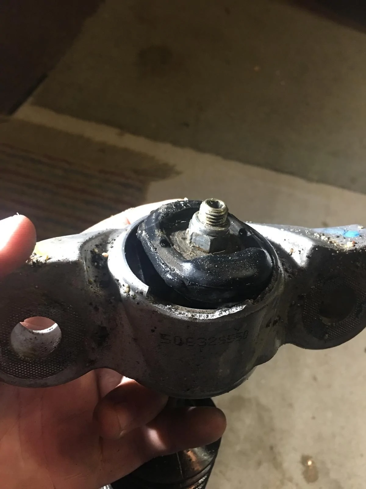

I mentioned some shock mount issues up above. It looks like I hit a bump in the road that was just aggressive enough. At the time I was still running bump stops. This and my ride height could have been the cause of the hat blowing out on the mount. I did NOT want to risk it happening again so I got the Steeda Billet Mounts.
Some carnage:

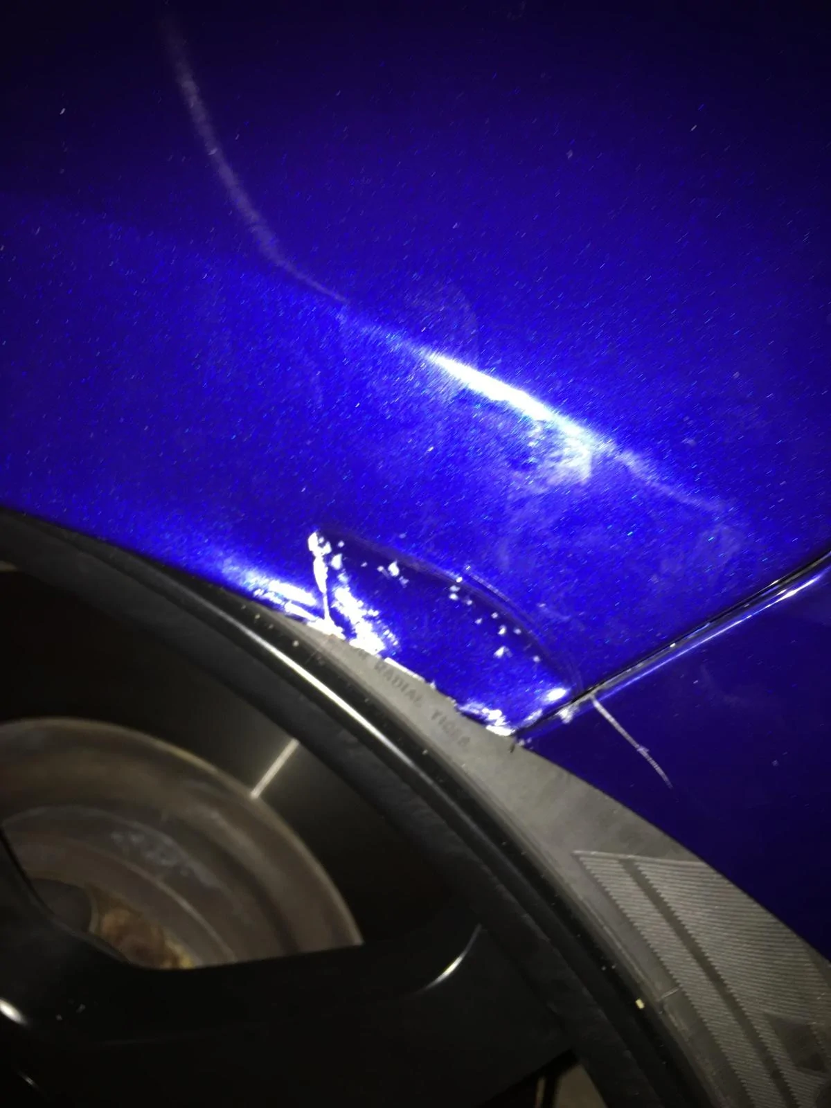

About 5 minutes after the photo above, I had one of the worst things happen to my car. The biggest fear most people have with bagged cars is ruining their fenders. Well, it happened to me. I had the car bagged for about 6 months at this point. I had been doing some photos while I was on vacation in Minocqua; a small-ish vacation town in Northern Wisconsin. I have a family vacation home that I go to on holidays as a place to relax and get away.
I must have aired up with the wheel slightly turned and the tire caught the inner fender. This pulled the fender down and cracked it. Instead of trying to have the fender fixed (difficult because it is aluminum) I decided to purchase a new one and prep it by rolling the inner lip completely flat. I had this one painted off of the car and installed it myself instead of paying the shop to do that. This ended up not looking the greatest color match wise so I would get this resprayed in spring of 2018. I noticed there are two versions of the Deep Impact Blue. There is J4 and J4L. The "L" has a lighter basecoat which isn't super noticeable by itself but when it is near the non "L" version, it really stands out. Here are the photos with it cracked and painted the second go round in spring. I had it painted on the car this time but did NOT have them blend into the door. I have plans to get CF fenders but could not stand the fender being extremely different in color.
