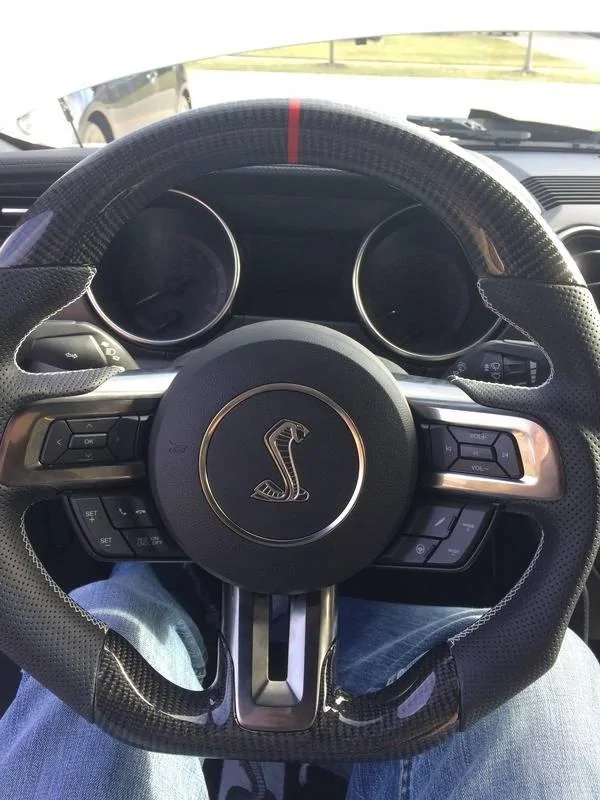

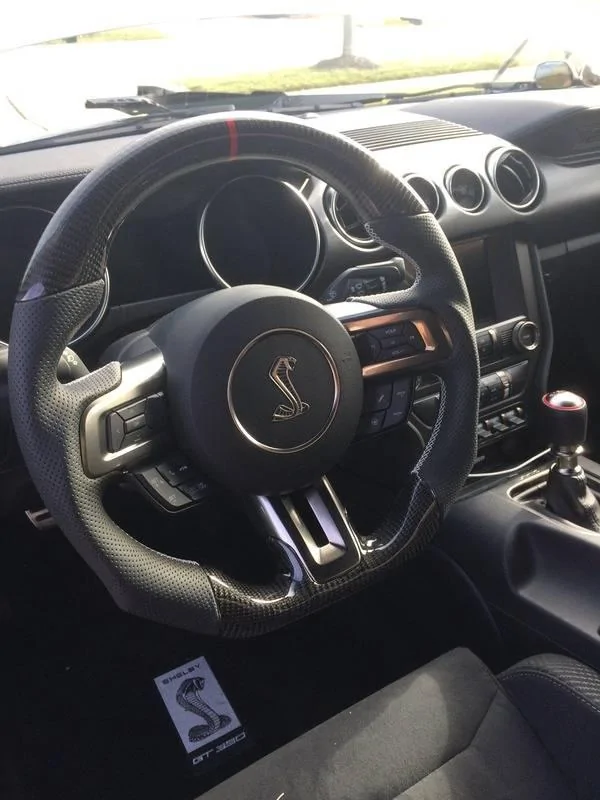

Hi,Just finished installing:
Ordering process
- Smooth. Communicated directly via email. Stayed in touch throughout the process. Took longer than initially advertised—COVID
Wheel
- Very well packaged; no chance for damage
- The CF and leather are extremely good quality (flash makes it seem brighter than it is)
- Stitching is also a work of art

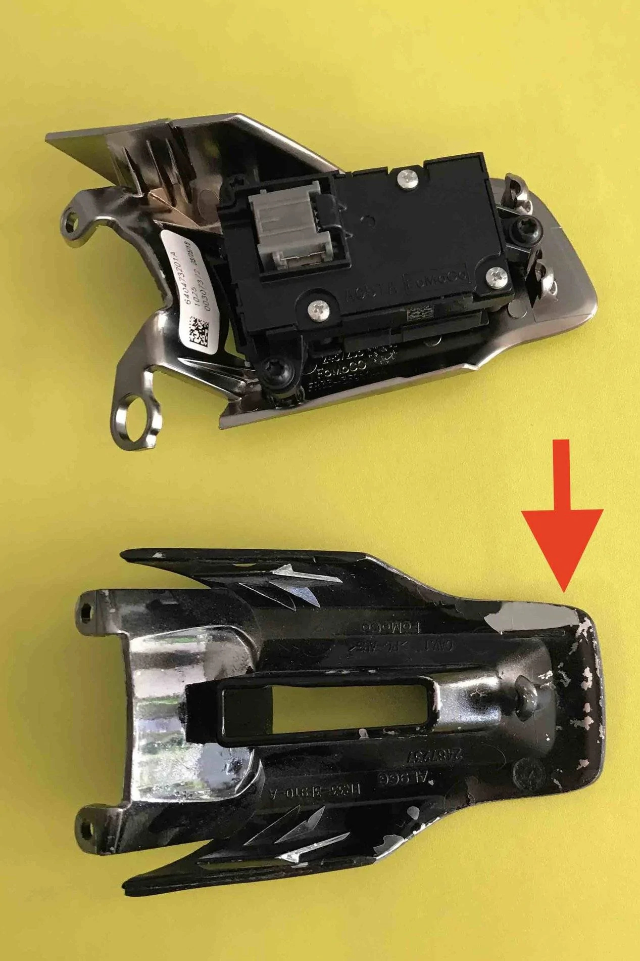

- One exception. Although overall craftsmanship is outstanding, the lack of attention to detail on the backside of the parts is irritating. They cannot be seen, but it would still be nice to know that something so well crafted is perfect “inside and out.” OEM up top. Beith below. Used touch-up paint prior to installing--OCD

Edit: Notice the gap at the top between the airbag cover and the rear cover. This is the point about a less natural fit. Will have to remove and reposition the rear cover to get the right fit. Hopefully, my retainer spring Kung Fu will be stronger the second time around...

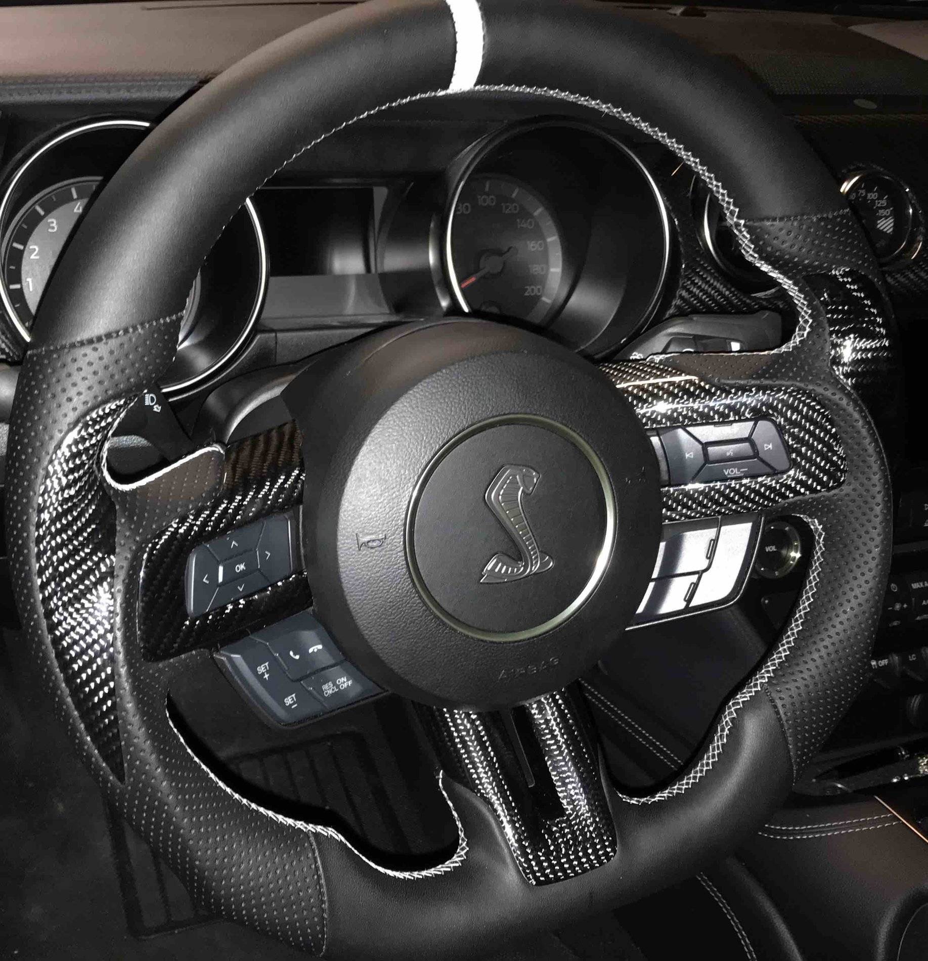

Did you compare the weights of the original wheel and Beith performance? As I said, I am surprised how much heavier it is compared to stock...
