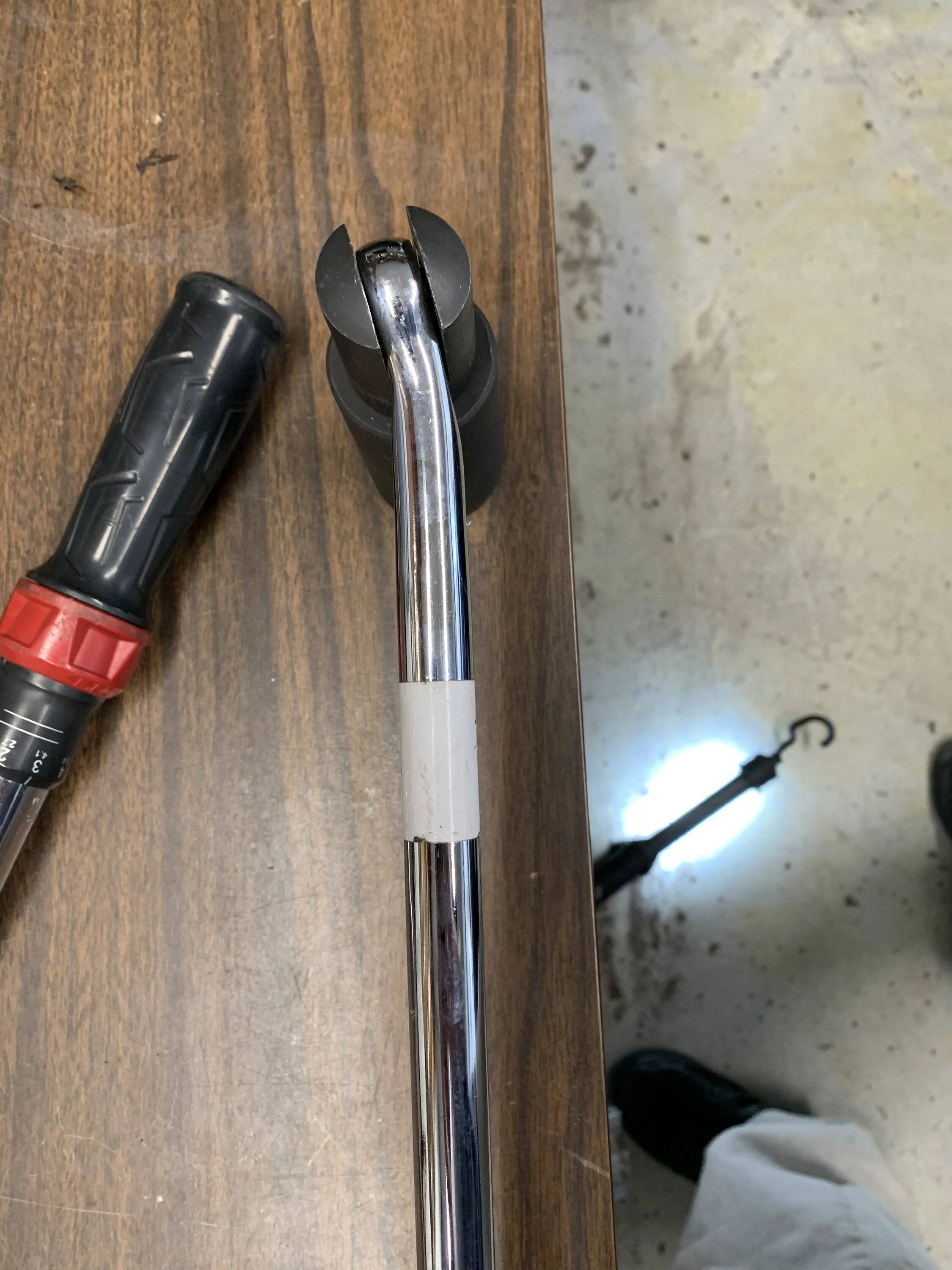

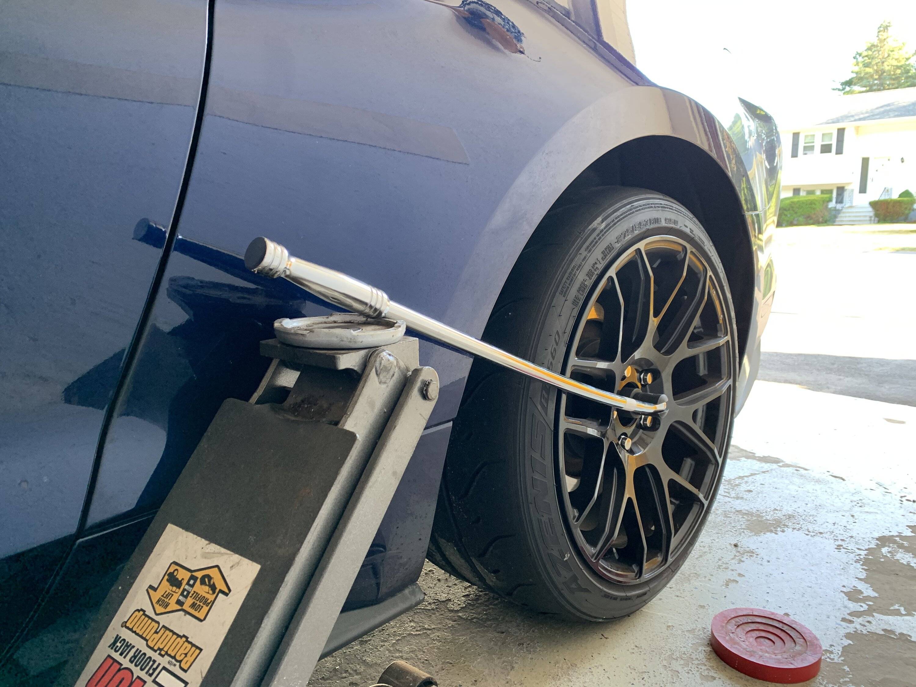

Clean the threads, apply lots of threadlocker red. Torque them till the bar breaks.
It’s not the bearing failing, it’s the nut getting loose. Launching the car loosens the driver’s side axle nut.
edit: my car sees over 100 launches every summer, I’ve had the nut come loose 3 times on the same wheel bearing now.
