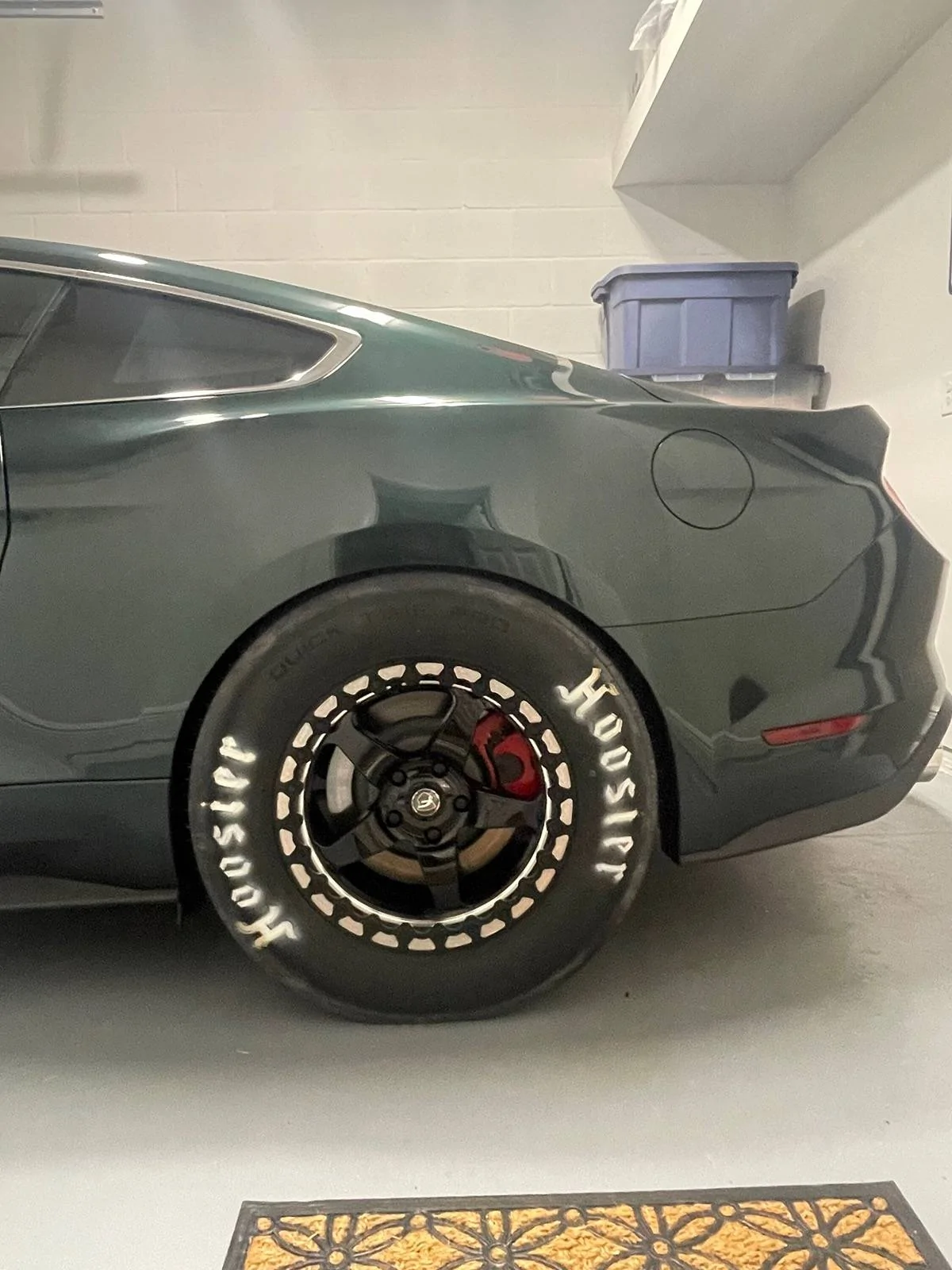

FYI, my Hoosiers took 3 1/4 oz of weight, but they’ve been super smooth. Highest MPH on them has been 116.41. The ET Streets were also super smooth up to 122.85 MPH.
Will you be running radials or bias ply?
My longest highway drive on The ET Streets with skinnies was 110 miles. The Hoosiers fill up the gap in the wheel well better than the ET Streets did. See comparison pics here.
