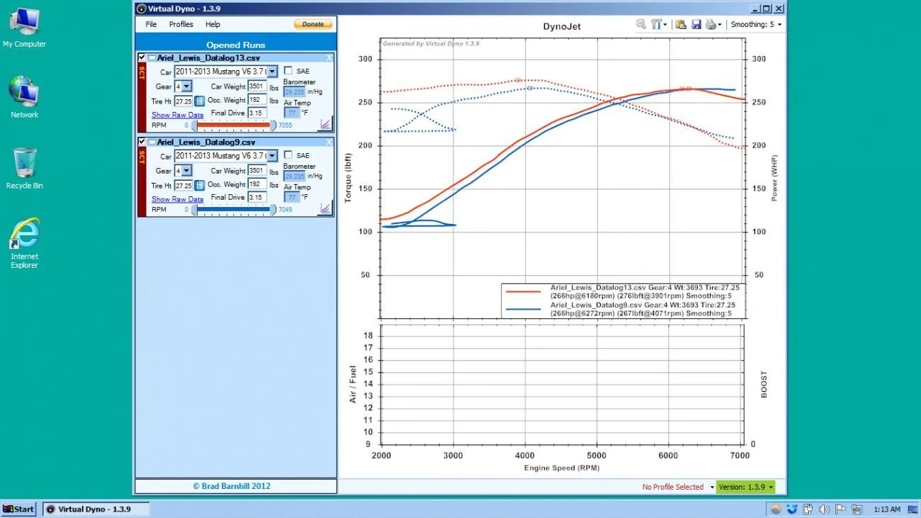

After some minor datalogging looks like I'm close to where I need to be (if I'm not there already). Same disclaimer as above (this is a Virtual Dyno, there are different variables, yadda yadda lol). HP numbers are about to same as log manifold tune but driveability has been further polished and shows even more tq gains down low after a few runs.
VERDICT: With shorties peak power/torque is reached sooner which results in a much more pleasurable daily driver. You will net a few HP and major torque down low along with nice midrange. I would imagine longtubes would gain more in both maximum overall HP/TQ in comparison to shorties but the gains would be more linear (with hp/tq being closer together) vs fat torque curves. Here is a graph showing my latest datalogs. Even those these are not exact numbers, this should definitely give an idea on where you will be gaining with these mods.
Red = Latest tune/datalog
Blue = Log manifold tune/datalog
There's good tech shared from many in this thread, new sticky anyone? :cheers:
