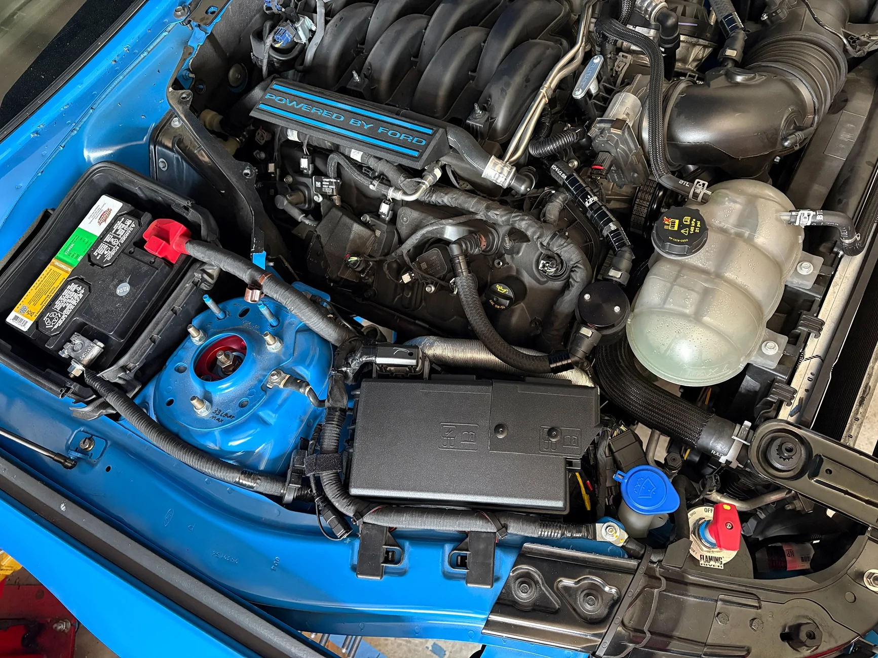

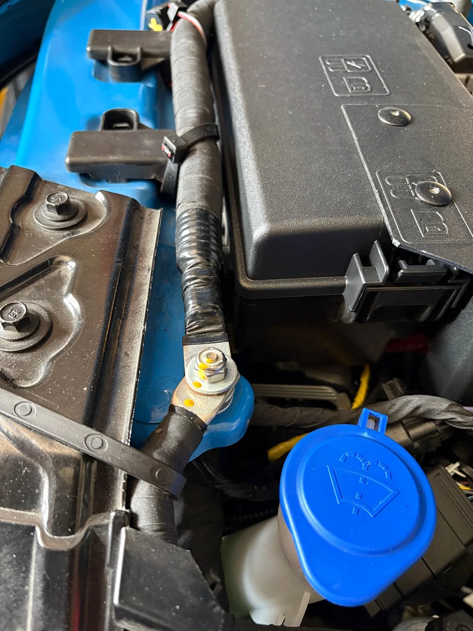

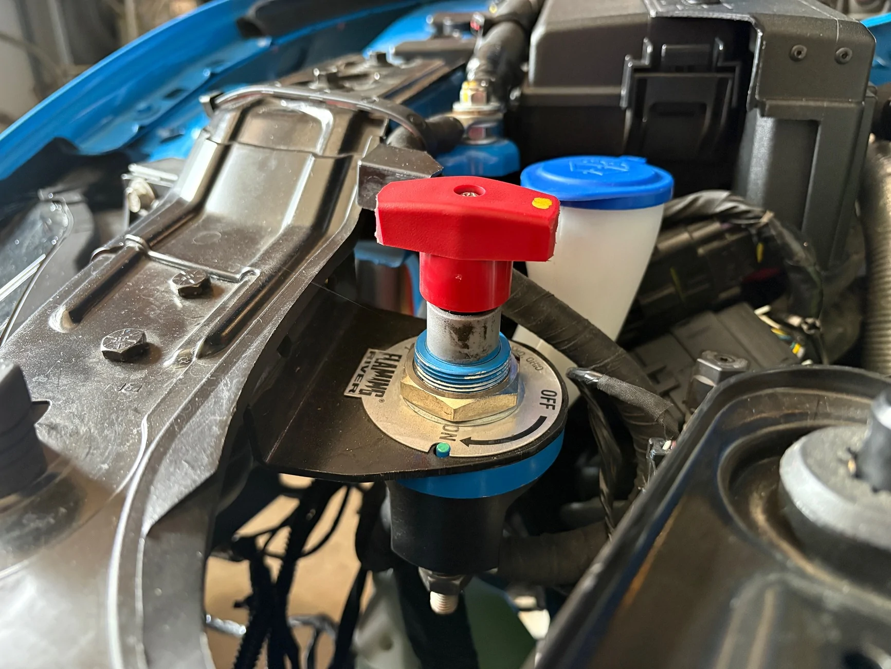

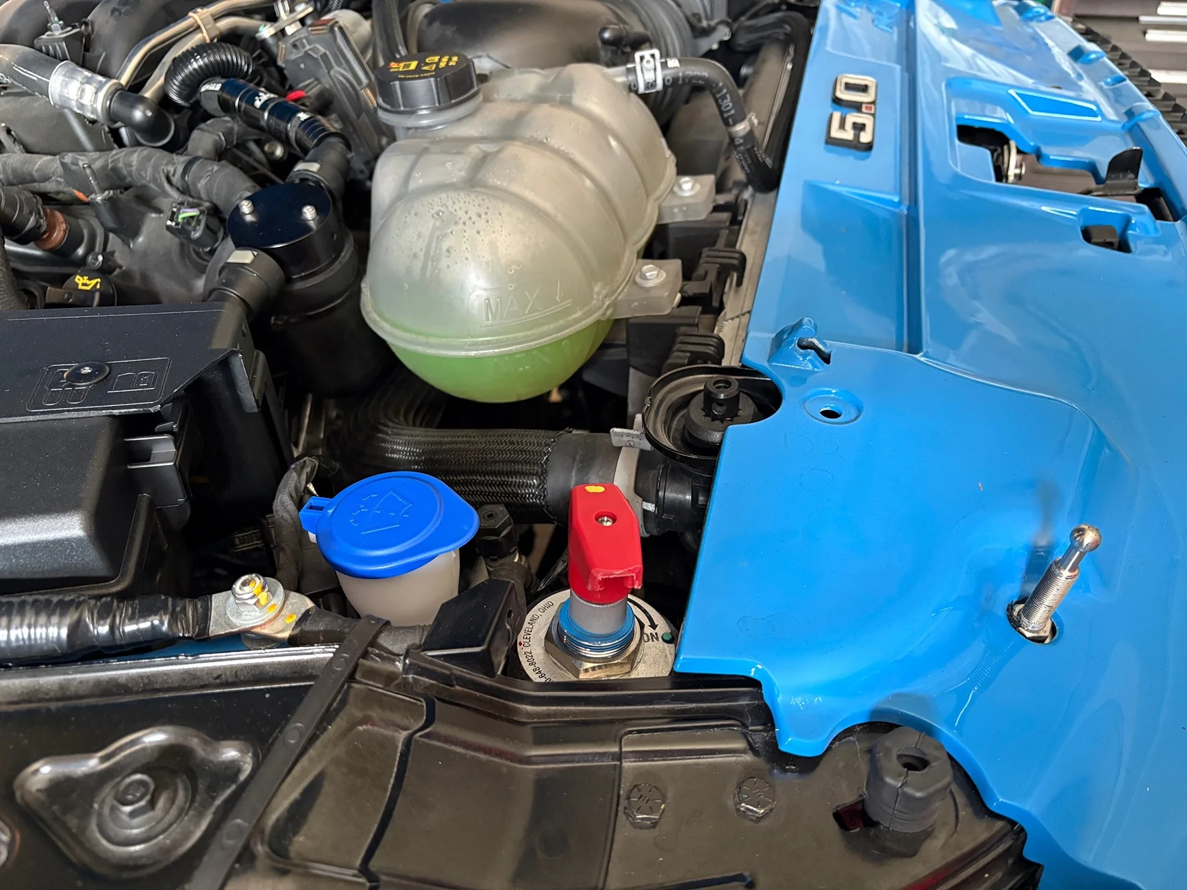

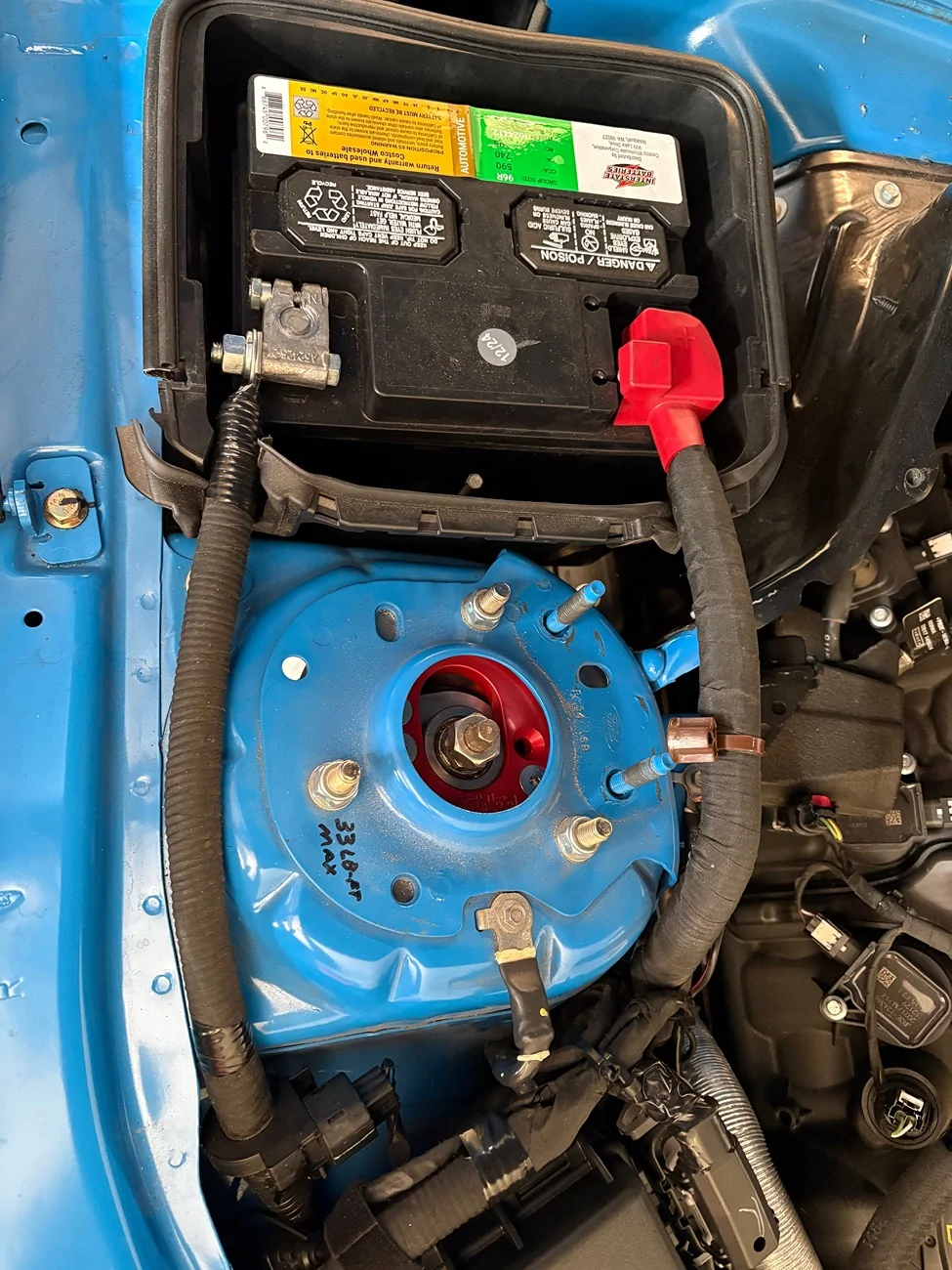

I'm using a Flaming River 500 Amp Big Switch for my quick disconnect needs. I made a new negative cable from the battery to the switch input and flipped the original negative cable over and connected it to the switch outlet. (I made a jumper from the switch outlet to the fender tab junction, next to the washer fluid cap, so I didn't have to mess with modifying the OEM negative cable.) Packaging is tight and be aware if you reverse the "direction" of the original negative cable, the BMS sensor coil has to also be reversed (ask me how I found out, ha ha.)

...Note, the battery tender plug in the second image can be wired before or after the switch, I don't know how the BMS system works well enough to know if it matters? Reversing the orientation of the BMS sensor was challenging because of the way Ford's harness supplier used so much tape.
