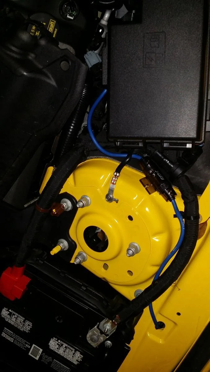

Does anyone have a picture of the power wire connected to the battery and how it's routed around to the firewall? I really want ideas so I can connect my power wire...

Not my pictures, but I had them saved from another thread on this forum. The power wire hooks up on the positive terminal, you need to completely take off the nut, then slide on the power cord and re screw on the nut.

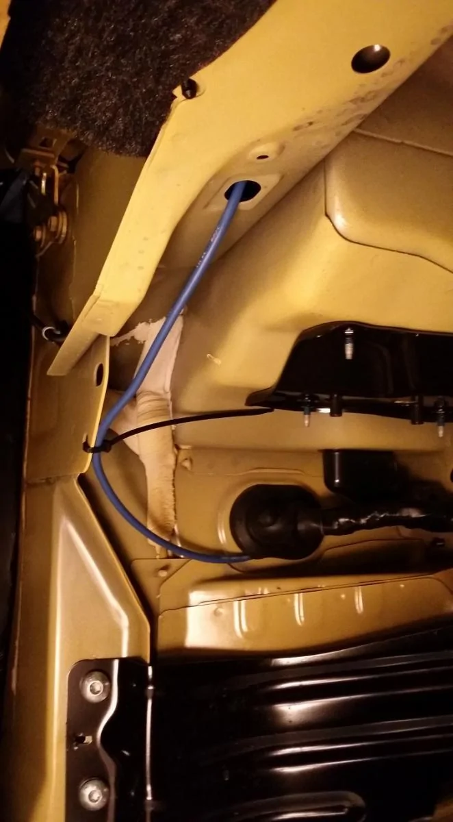

Hooking up to the fuse box seems way easier than connecting directly to the battery as I had originally planned. The thing that concerns me from the pic above is where the power wire enters the wheel well. Couldn't the wire chafe with the metal and short out?

Yes you are correct. I have mine wrapped in plastic wire loom which came with my amp install kit. I think it should do the trick.

Hooking up to battery
what are you guys tapping into on the control box. I don't see an easy way to tap the battery positive terminal. But is it safe to use the control box without running the risk of blowing a major fuse? Anyone have pics of what they tapped to get their power. :kickrock: thanks in advance
