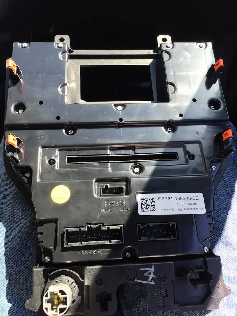

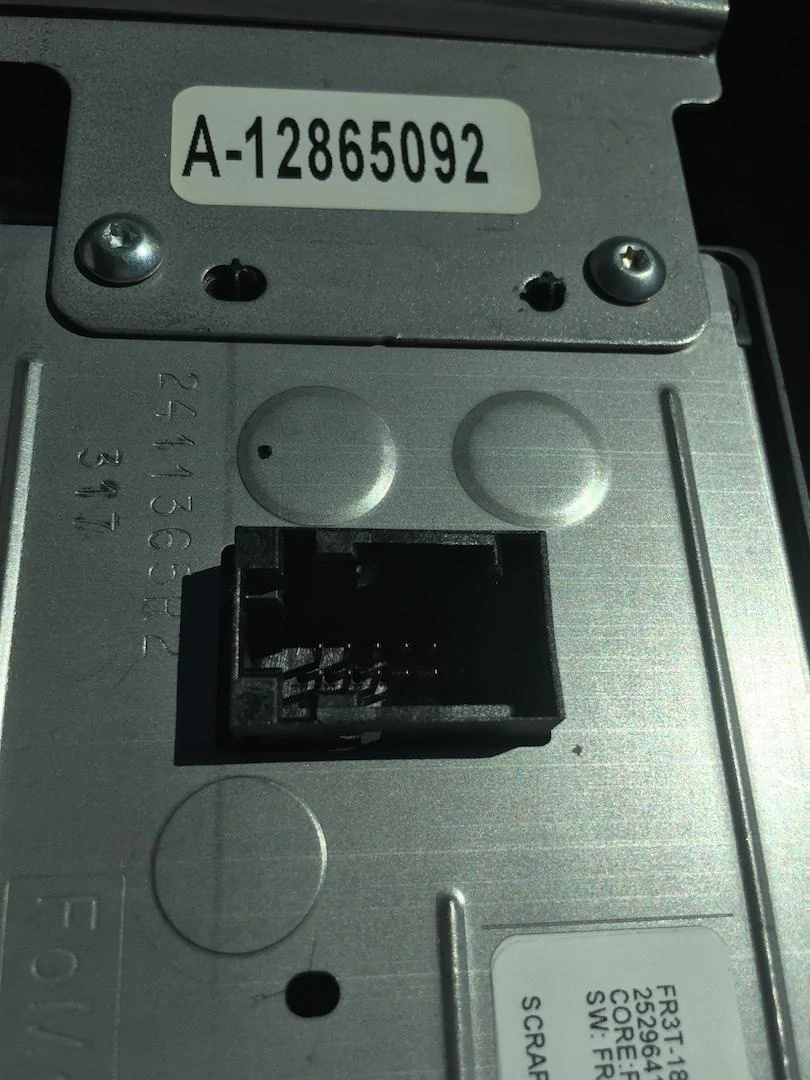

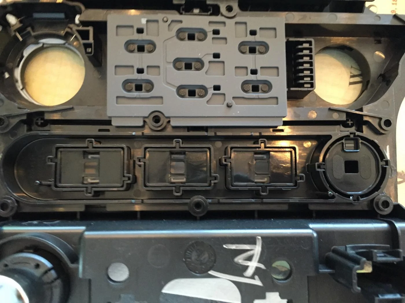

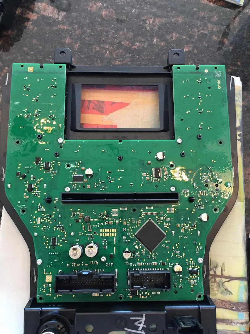

So you guys wanted to see more of the base model center stack? :D

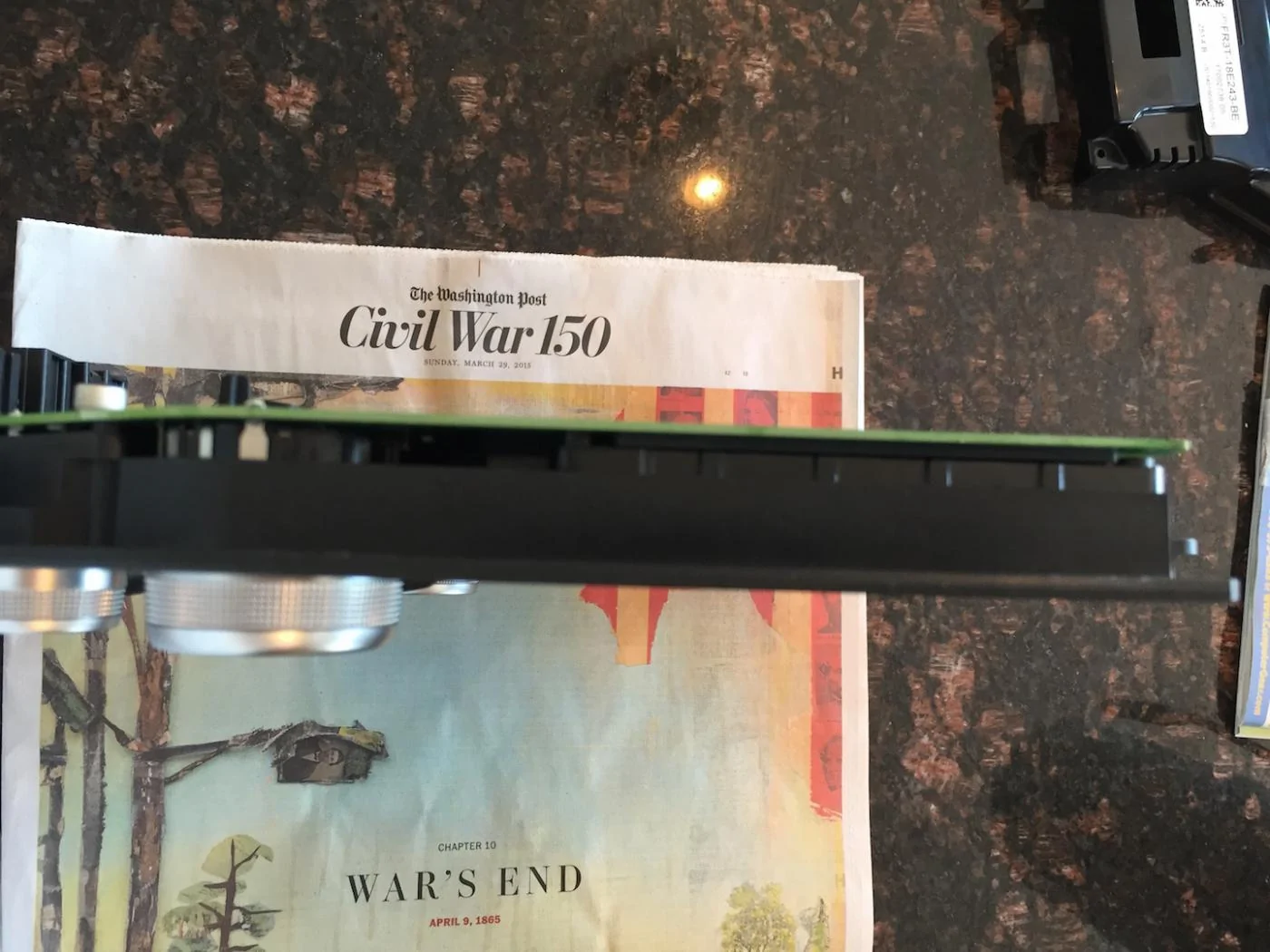

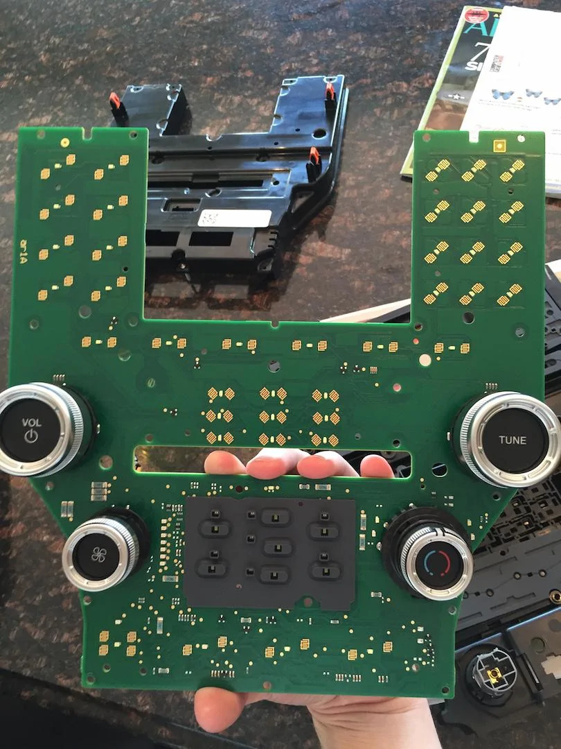

Unfortunately it is all one board so aftermarket companies will need to have climate controls on top of the push button start. The nice surprise though is that the base model buttons are not attached to the board! There MIGHT be a way to get the toggle switches on the base model!
Cutting the board might not be the best option... There really isn't a nice partition of electronics like I was hoping there would be.. I think it would be possible though to fit an lcd screen in front of the board by removing the buttons and mounts. There is about .75" of space between the board and the face of the bezel.

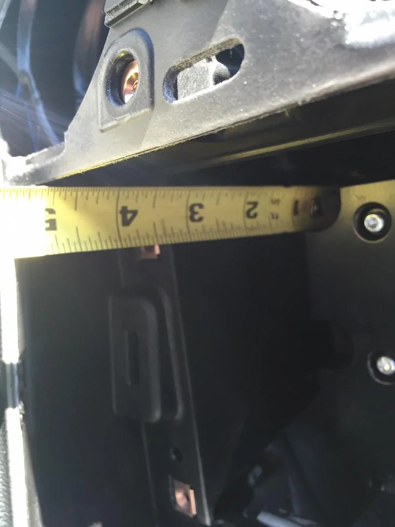

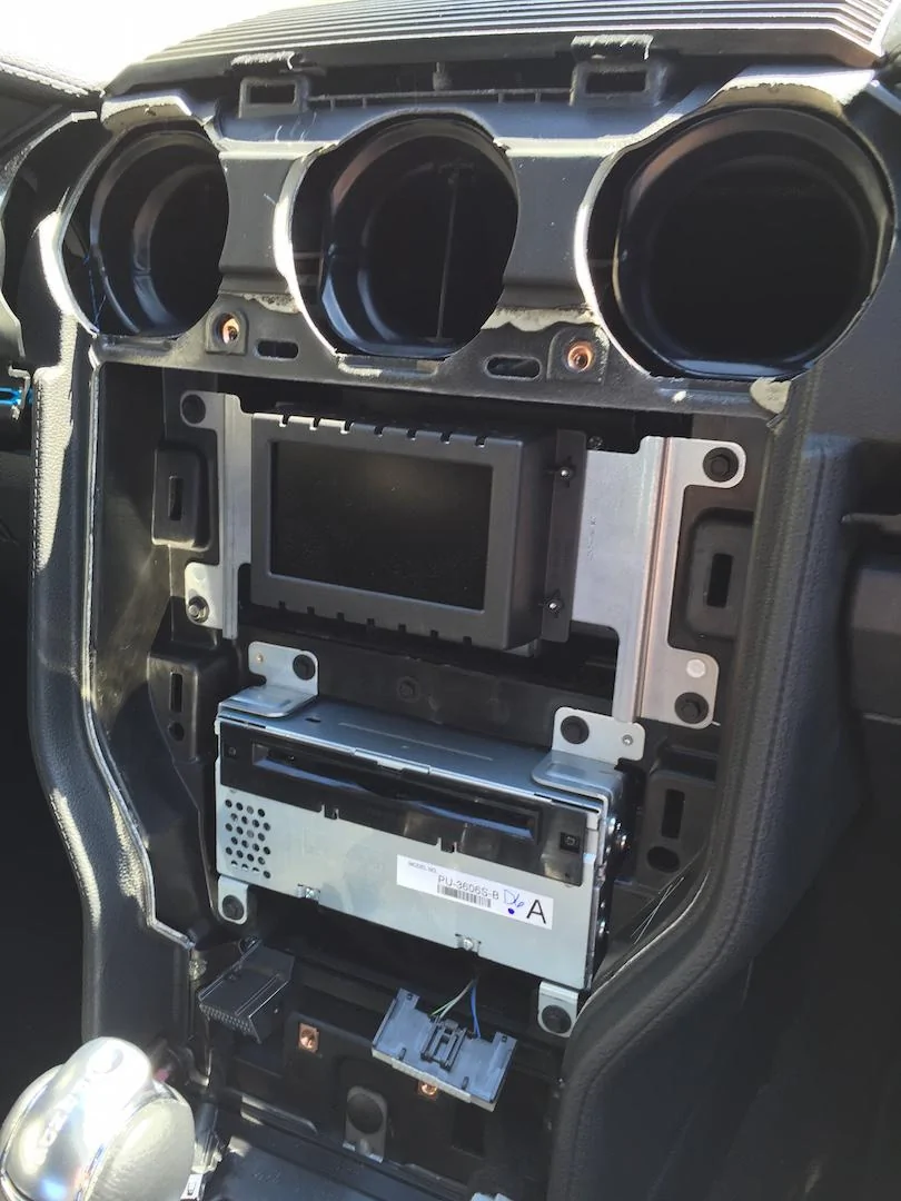

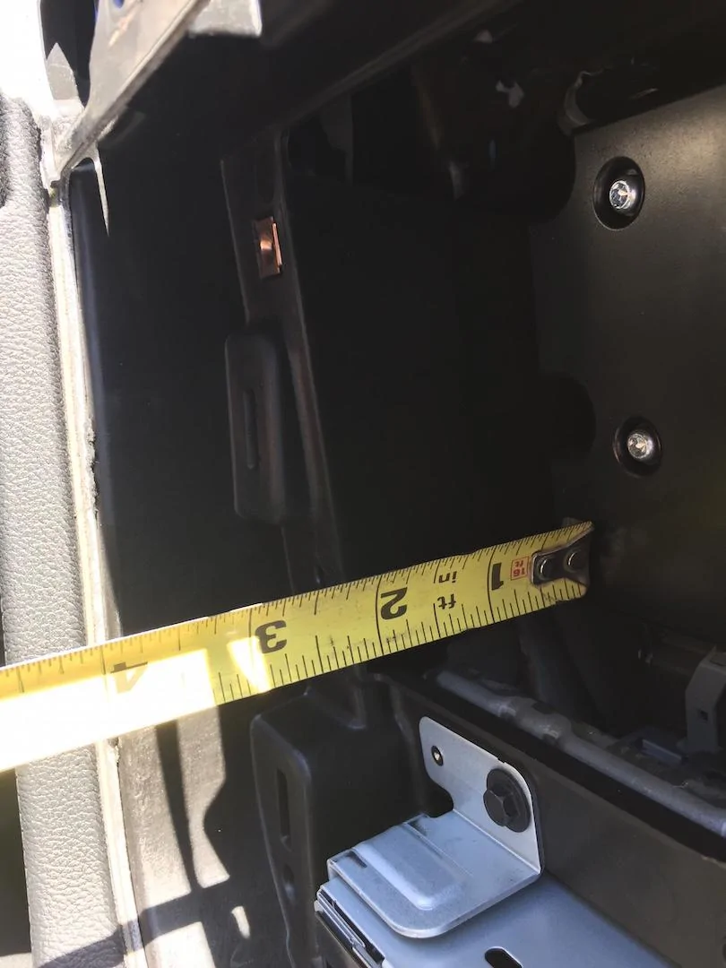

Now onto dimensions for a 2 din unit... In order to have a 2 din unit in place of the screen you will need to relocate the sync module. There is only about 3.75" between the module and the panel. With the module relocated you will have 5". You will need a shallow 2 din unit.

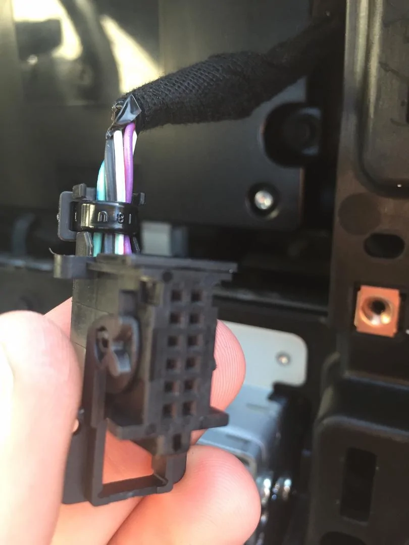

I took plenty of pictures of the various connectors. Towards the bottom there are two pictures of the base model 4" screen.

I don't think we will have a problem with nothing being developed. Aftermarket companies did it with the 11-14 generation which had the same one piece circuit board design. The issue is going to be the lack of options as only a few companies will dive into this and the time of their release. I am not expecting to see anything until at least 2016.
