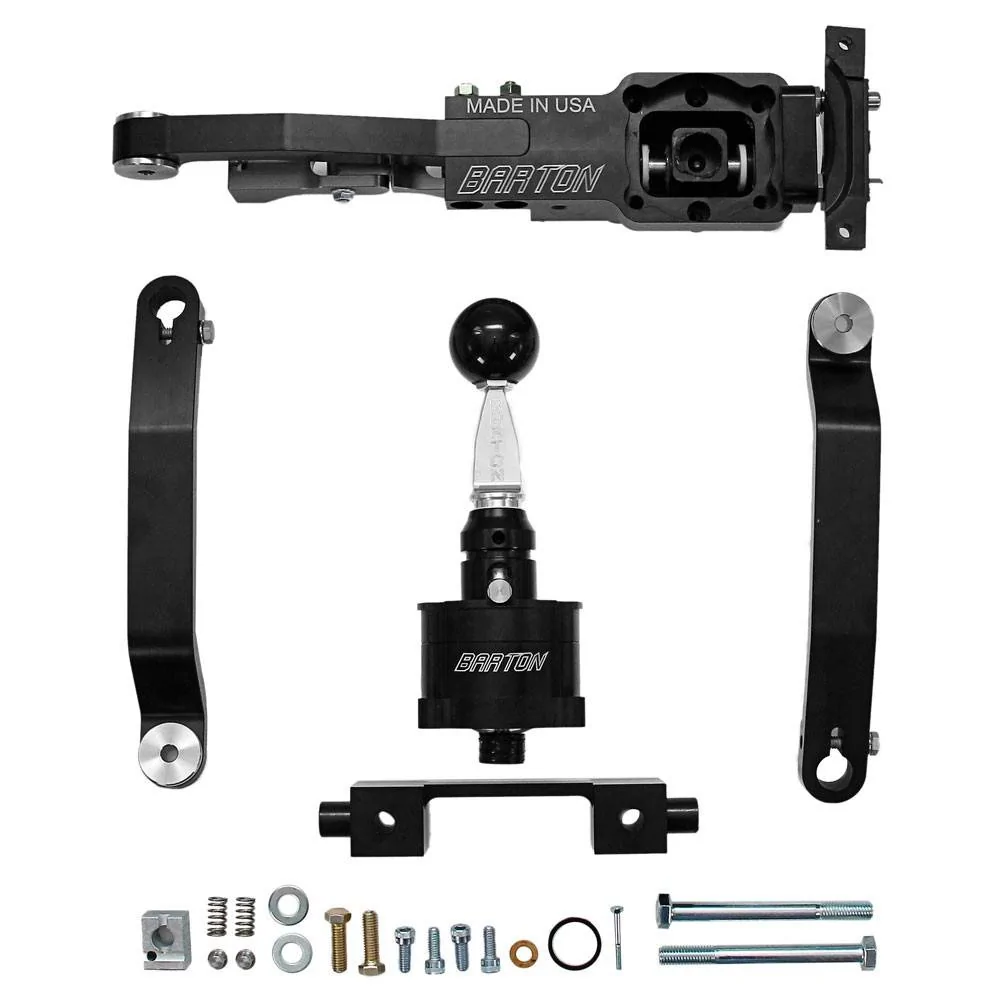

I’ve had it on my car 2 years
installed it at 1k miles on my car, I drove my car from Bozeman Montana ford to Ohio, 500 miles in I called Barton and asked for a short shifter
he said we have a ecoboost only option he recommended just released, gave me 15-25% off too. It was like 350 shipped. Was totallyfair
paid a guy 100 to help me install it from local mustang fb group.
Barton saidhe recommended body so I did body, no regrets. It’s crisp smooth no nvh.
Oh yeah, before fully assembling, try the shifter with the 2 optional springs, and without. I put all together went around the block and there’s 2 optional stiffness springs for left to right throw.
It was so stiff it felt like a workout
drove back, ripped it apart tossedsprings in trash and no regret. It shouldn’t feel like a curl machine to go left and right in the shift gates
I like an easy throw, don’t want to be flexing biceps to shift lmao.
Bottom left of pic those 2 springs by the square
fuck those things
Pic isn’t exact shifter but those components match

Thanks for your help. The main reason for me to get a barton over MGW is the fact that barton has those removable springs to make the shifter lighter with the reduced throw.
It kinda baffles me as this shifter seems to be the only one to have a GT version at all, and I totally missed that as there aren't too much people mentioning this.
