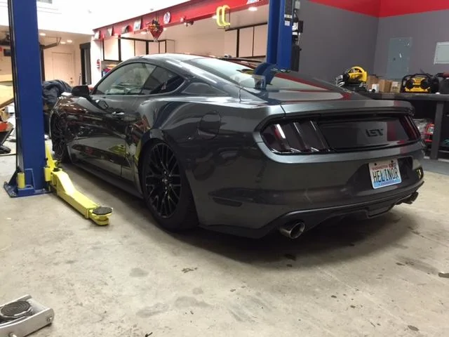

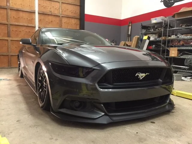

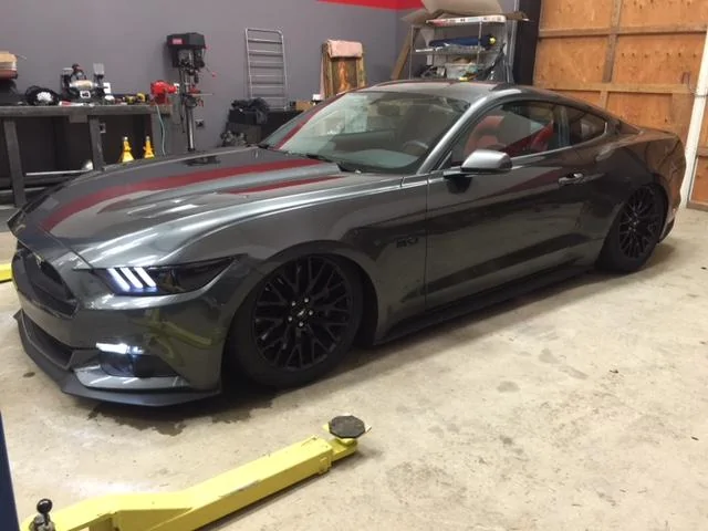

Finally after 12 hours of work shes almost done. I just have to wrap up a couple small things but she's working properly and sitting pretty. Love the ability to adjust everything and have the comfort/performance of coil overs.

Looking great Hellinor! Glad to hear that you are happy with the air so far, let me know how it handles after you rack up some miles!
