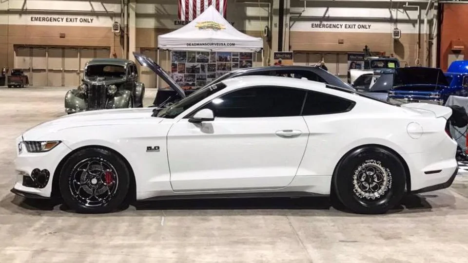

No doubt does the car look so much better with the 15 rears and 17 fronts. Is there a performance benefit for using the 15" rears/tire over the 17" rears/tire combos?
Do you have Instagram? I've seen this picture floating around with no owner tagged.
