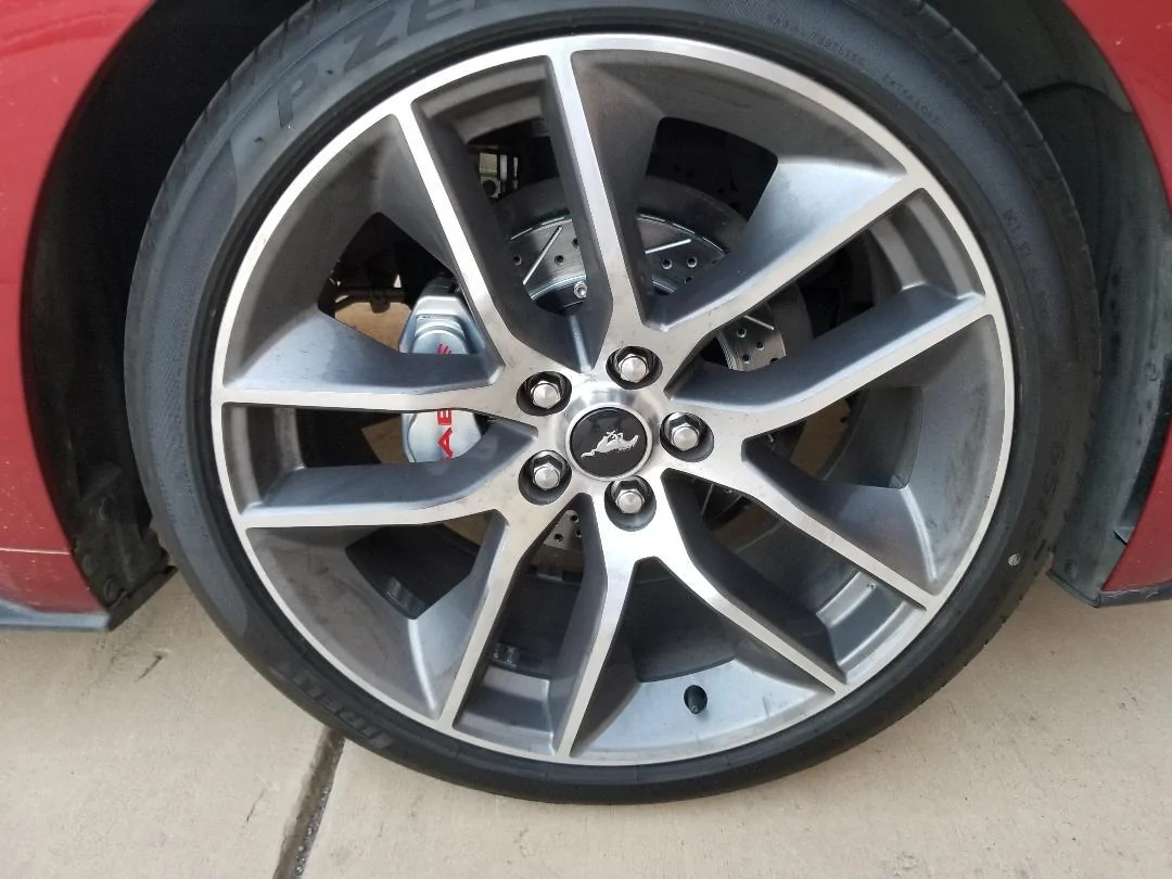

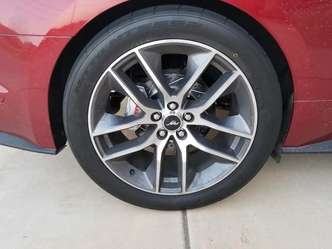

Just finished the install on my car. I used Goodridge Stainless steel brake lines. Overall, pretty straight forward job. I had a Capri Vacuum Bleeder which made the job much easier.
The weight/size difference on the front was significant. I can see how these save a 100lbs between the front & rear. The quality of the kit is top notch.
In terms of feel, I'll need to drive them around for a week to slowly break them in. They don't feel too bad but definitely noisy. We'll see if they quiet down with some miles.
I tried to test fit some 15x7 rims I had lying around from a 99 mustang v6. They actually fit but the clearance between the caliper and inner rim was a little too close to consider safe.
Hopefully that drop in weight and rotating mass will equate to 2-3 tenths in the 1/4.
