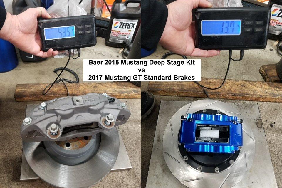

I know we always talk about it and people ask all the time, so I thought I would post a pic of a side by side Brian took today of the kit going on our 2018 Mustang GT. This is standard non pp gt brakes, and the baer. Double that each side, and then i'll do one of the rears tonight!
30lbs a side on the front! Very nice!

anyone know how much more the PP brakes weigh?

The rotors are 33lb each for the PP cars but the calipers are a couple #'s lighter. Overall I think they are a few #'s heavier.

The weight savings on those drag brake kits are awesome, but can they emergency stop the car anywhere near the stock system? Report back to us on that please Terry

they stop at 160 at the track, should be good on the street, we daily'd them on our 15 car

But 160+ at our Mexico track is alot different than 160 at a NHRA track. As much as we want the weight savings. The ability to stop is more important. So back to the question will these stop as quickly as the stockers. Do they have a more aggressive pad with the same stopping ability with the tiny rotors. we are not talking road racing. Were talking the just in case something runs/pulls out in front of us. :eyebulge:

Are you asking if 11" brakes will stop as well as a 14-15" 4/6 piston front brake? Cmon, clearly the terminal stopping distance will be longer. Will you be able to stop in an emergency at normal driving speeds? Yes. Will you be able to stop on a dime while going 160 on the street and a deer runs out in front of you? No. Neither braking system will do that for you.
These brakes should provide all the stopping power you need, biggest difference is they will get hotter much faster so repeatedly putting them to max effort is not going to end well (autox/road course).

I can tell you from experience (I tried the aerospace version for a few weeks) that the drag brakes do not stop anywhere as well in a panic stop as the standard or PP brakes. They do fine for normal driving and stopping at a track where you have lots of room to slow down but following another driver with better brakes at high speed is dangerous unless you are leaving lots of room. I ended up pulling off the drag brakes for street use and buying the Eradispeed 2 pc rotors instead.

not a fan of the aerospace, started with those,
the calipers are a 4 piston caliper, so they are good brakes, however, the standard brake on a 15 is the same as an 11-14 brembo, so they are big

I've been going back and forth on doing these but that is shaving so much weight off the front that it makes it hard to pass up. Did you get a chance to weigh the rears?

rears are 16lbs a side

Has anyone weighted the stock non PP rotor vs the Baer eradispeed rotor? want to know the specifics on savings on just rotor alone.
EDIT: NVM just found it. Was hoping saving on Eradispeed rotor would be more than 4lbs per corner.
