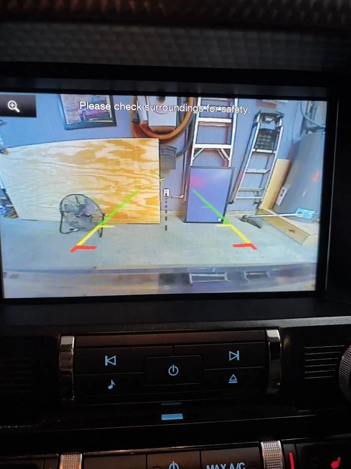

I recently purchased a 2015 EB that had an intermittent backup camera display. I found where the TSB had been accomplished (although I have my doubts). I did an inspection of the wire harness and found no problems. I ordered a backup camera with decent reviews from that huge online store.
I replaced the camera and it works very well with one exception. The parking guide lines point up at an exaggerated angle. I made certain the camera was seated properly in the housing and tried again with the same results.
Can anyone tell me if this is something that can be solved with FORscan to re-calibrate the camera? Or, is this a function of the camera (which for some reason I don't think it is).
Adding obligatory pictures.
Thank you!

Judging by that line position, it’s plotting against you …

I'm guessing the new camera has a different field of view than the factory one. I don't think the lines on the screen are any different, it's just that the new camera has a different fishbowl effect.
Ah - didn't think about that.
I did a quick search -
It appears that the stock camera field of view is around 170 degrees as is the replacement.

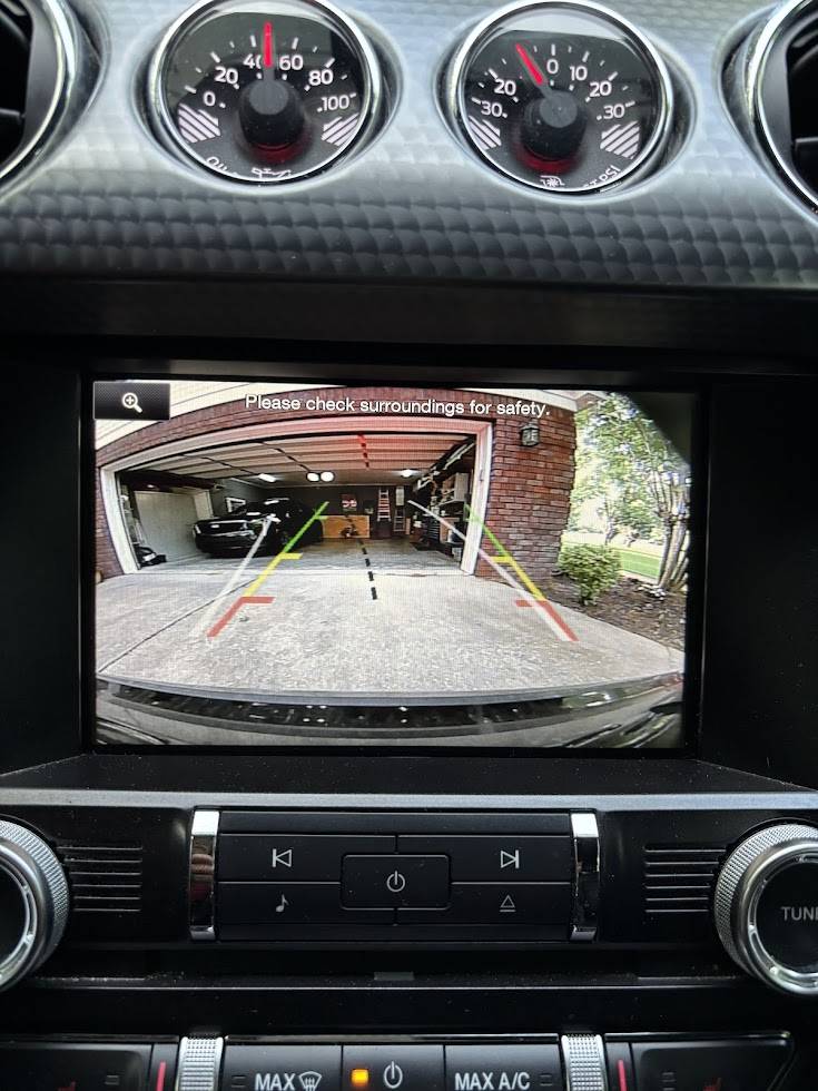

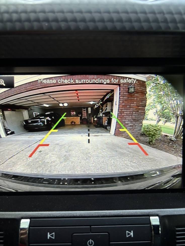

Greetings!
Follow-up to my camera conundrum.
I attempted to calibrate the camera with FORScan and was unsuccessful. I kept getting a DTC fault anytime I attempted a calibration or the LIN procedure.
I picked up a Ford part from the local dealership today. I asked the parts guy if it would need calibrated to which he replied it was plug and play and should not need calibration.
I installed the camera tonight after work and got a great picture but, no parking lines. I used FORScan to execute the "LIN" task (sorry - can't remember or find the exact verbiage). It's the one just under Camera Calibration and for newly installed modules. The "task" was completed quickly and everything looks good right now.
Thanks for everyone's input!
