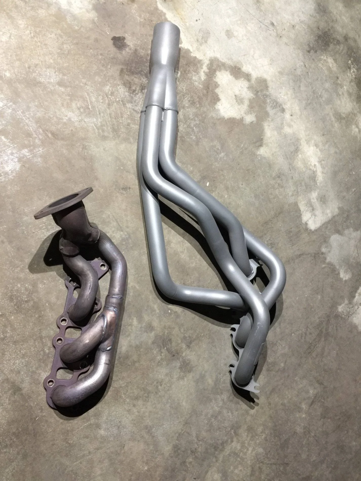

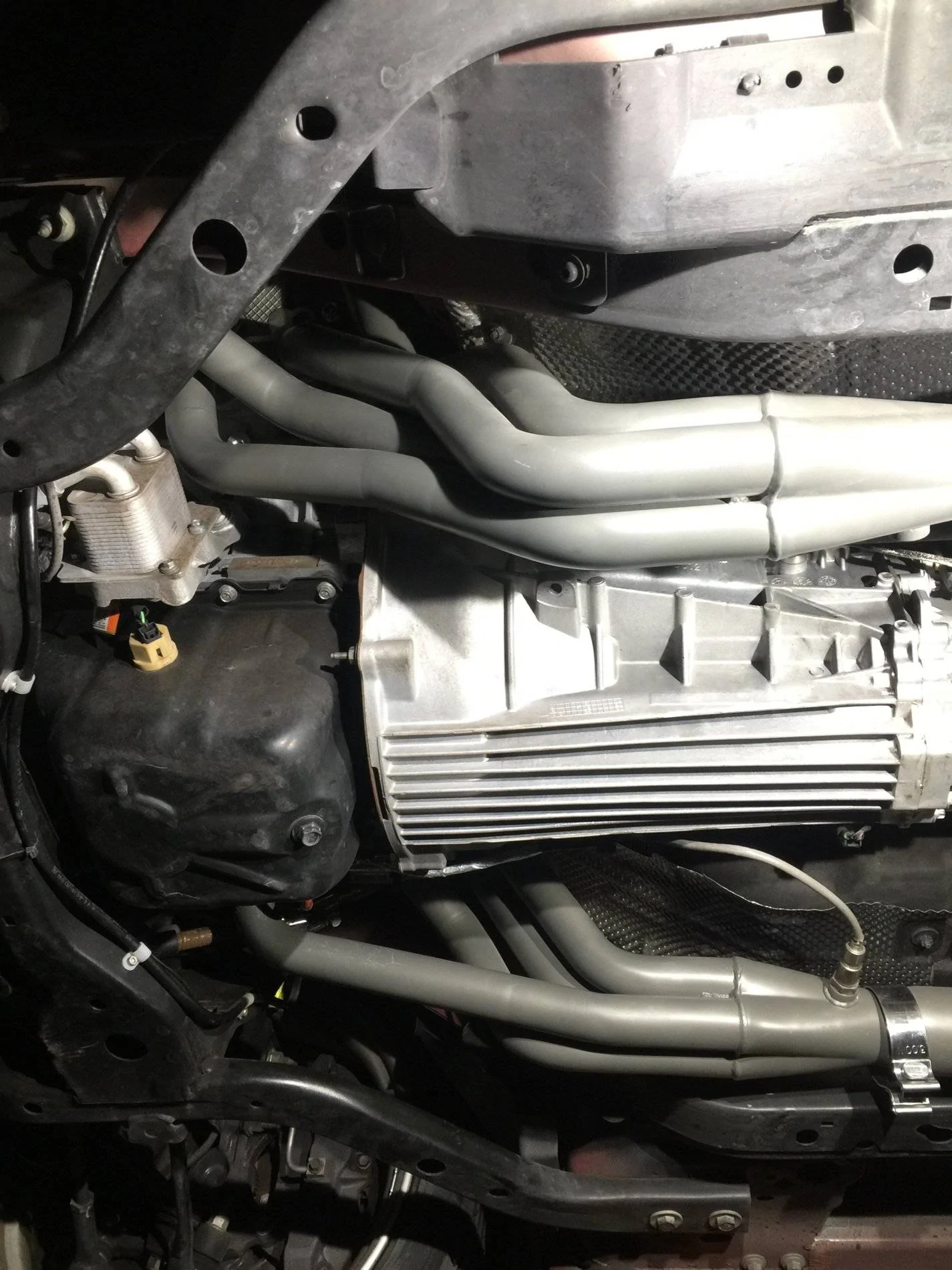

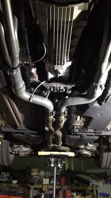

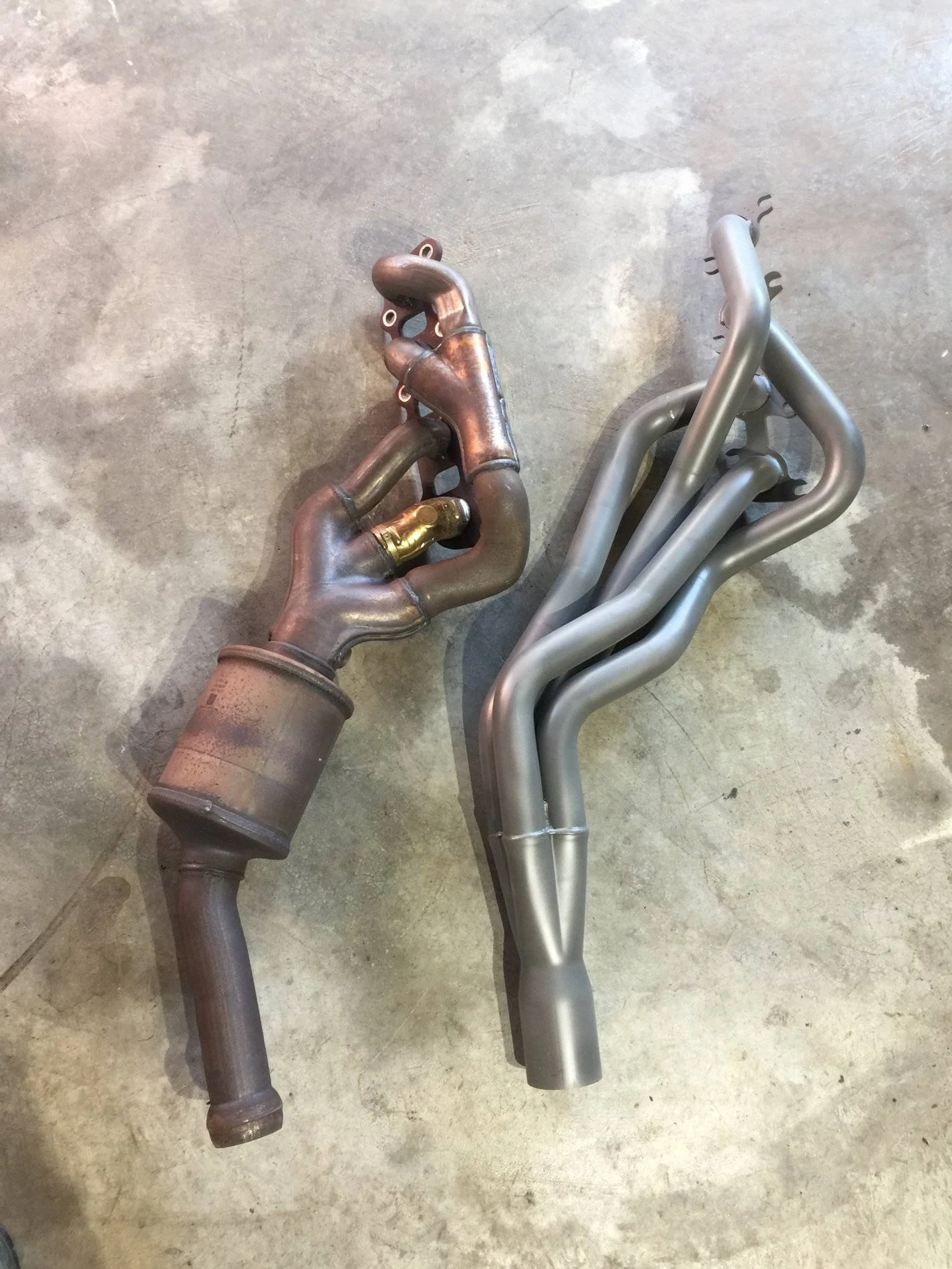

FIXR7
Dec 2, 2015
381
215
Perth, Western Australia
Peter
'93 Range Rover Rogue 351 powered, '17 Ruby GT, '99 XH V8-S ute, '69 Mercury Cougar XR7 S-code, '96 XH Ex-pork van
Ok I've been driving it now for a coupla weeks with just the poxy necked down factory exhaust connectors still in place so they're only about 2 1/8" diameter. Interestingly it took about an hour of driving to set a cat efficiency light.
First thing to note...it's too loud! 2nd... the high frequency rasp is terrible so, since I already had to eliminate those aforementioned connectors I will add some 15" resonators in their place. Performance wise, it's noticeably better and surprisingly even off idle torque is better. It has a more effortless feeling even with loudness which tends to make cars feel like they're having to do more for the same(or worse) result. I've gotta do some logs to see if everything is on track fuel wise but nothing has showed up on the gauge in real time. After that I've got a GT350 Intake manifold kit to go on.
