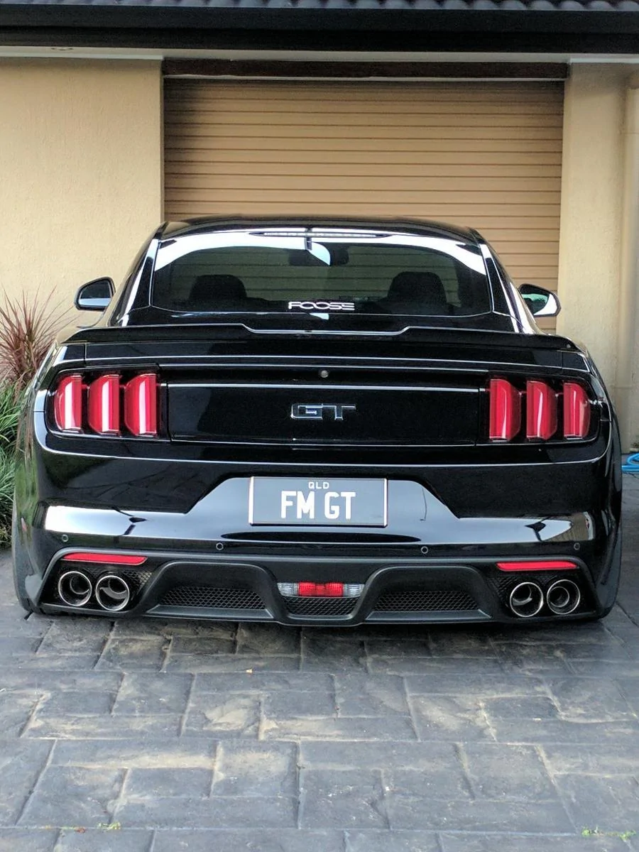

GT 350 Valance and Mufflers ....
Just had these installed GT 350 valance and Ford Performance sport mufflers ...and wow is all i can say the sound is perfect deep and throaty.
Before I fitted the system the car sound was biased to the front and dominated by the rousch CAI i have but now its more to the rear with the CAI sound audible in the the car under load.
There is no droning at all for me so :thumbsup:

Looks fantastic

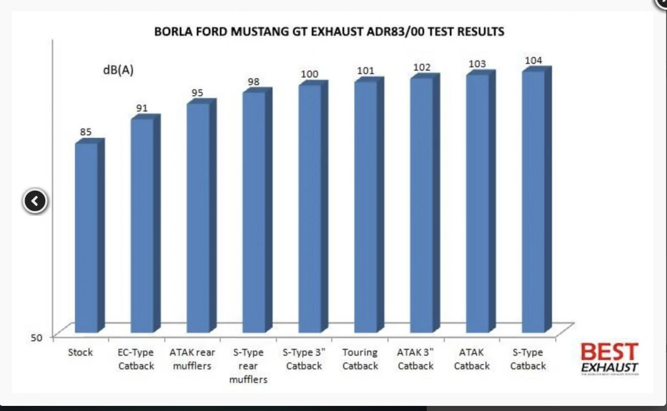

The touring isn't that quiet at all. Sound tests done by Best Exhaust

Just a footnote re the chart that has been posted the Dba figures shown are not quite correct as it is our understanding that not all systems shown were tested in accordance of the ADR test procedure. Some figures were plucked from other sources. Re the ADR standard test, this is the same as that EU test procedure. The test procedure is at 3750rpm and includes a number of factors that must be in place. Some of the figures shown are not at the 3750rpm level. Any questions or if you need further information please contact us on 03 9553 6915. Email [email protected] We are an authorized BORLA distributor. Unfortunately misinformation gets posted online way too often.
