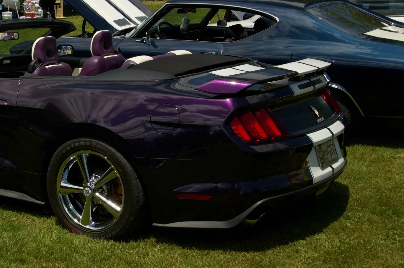

I went through what you are. I chose to drill additional holes because I knew that was the only spoiler that gave the appearance I wanted...then and "forever". If you are questioning going with another spoiler in the future, you can take a really hard look at what's available on the market for convertibles, and then maybe you will be able to determine as I did..."This is it".
There are some amazing 3M double faced tapes out there, and I've read where some folks have relied on it alone. BUT....if you decide to go that route, clean, clean, clean. De-wax, de-ceramic coat, or whatever is potentially on your vehicle before relying on that bond. Personally, I chose to drill holes in my "forever" spoiler, and I'm good with that. But if I went only with double faced tape, I'd purchase some 1 inch or 2 inch wide of the high-bond offerings to give the spoiler the best chance possible of staying secured.
Keep in mind...if you bond this spoiler really well, you will incur an even greater challenge should you decide to remove it later to replace with another.
