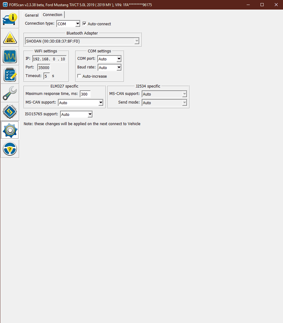

The settings that worked for us (nod to eddison here) are as follows, AFTER deleting your previously created/saved vehicle data.
FORScan v2.3.38 beta, Ford Mustang TiVCT 5.0L 2019 ( 2019 MY ), VIN_ 1FA_________96175 3_27_20...png

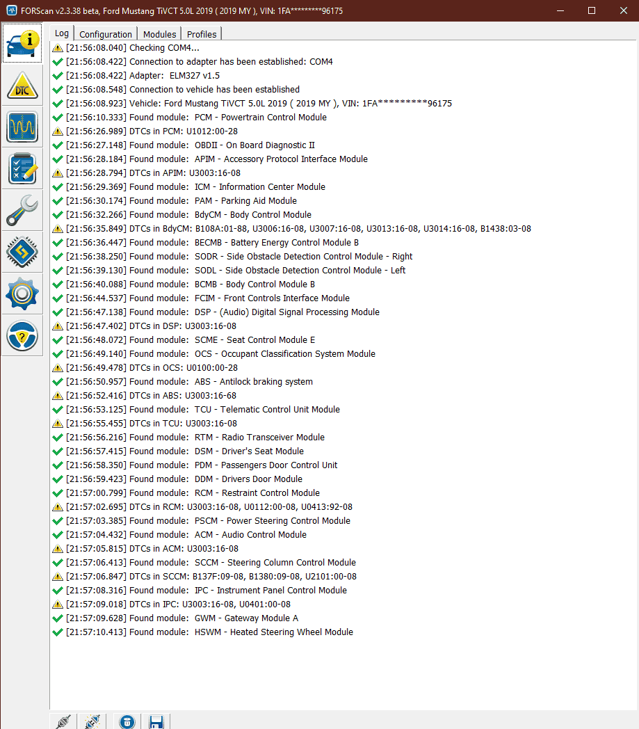

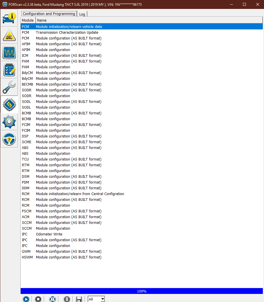

After which, upon reconnection, the connection scan should show this.
