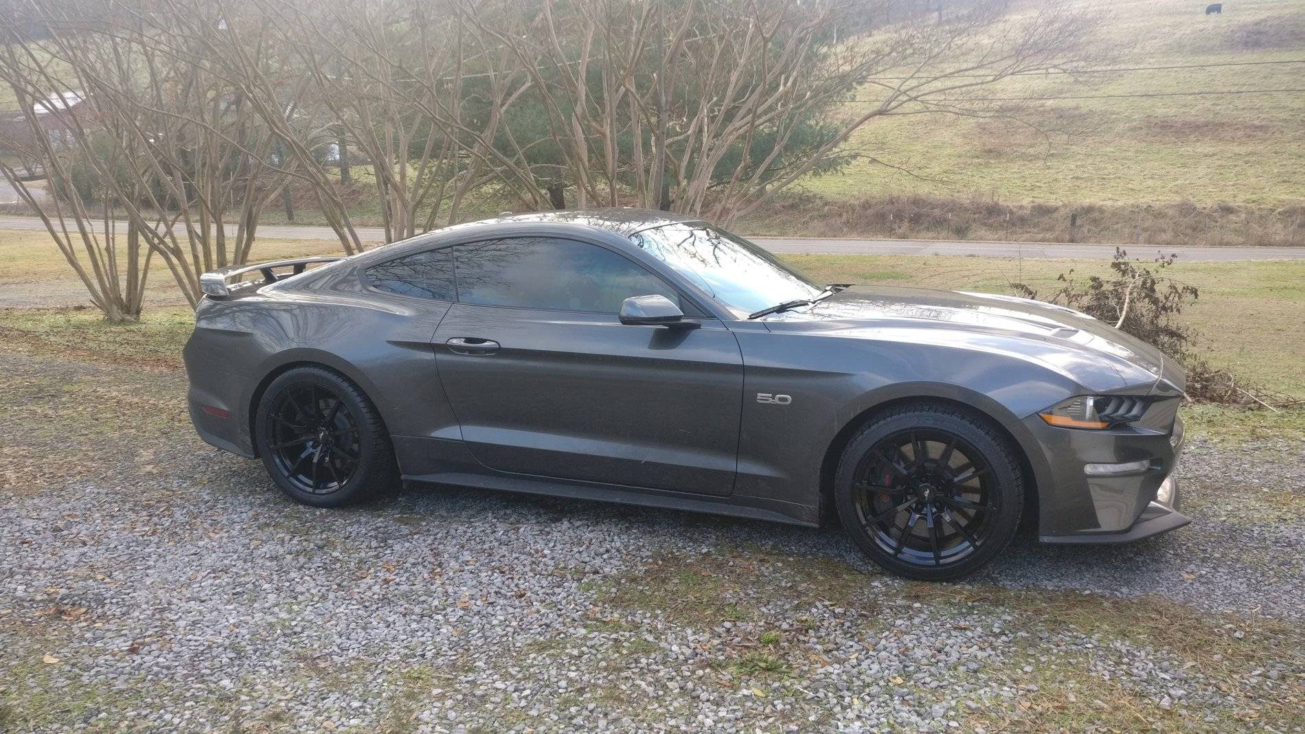

Stock height but plan to drop eventually.
Running the same rims but tires are the rear are 325/30-19 Pilot Sport A/S 3+ my fronts are 275/35-19
Close but hopefully helps some

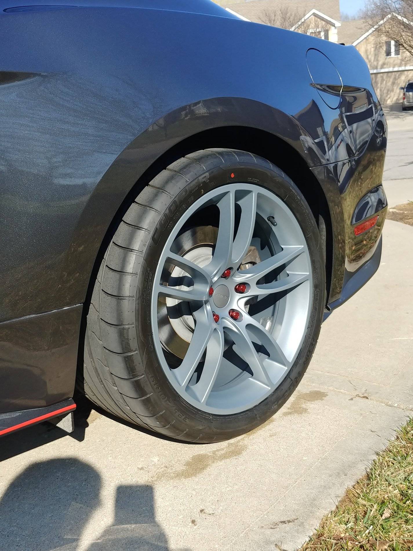

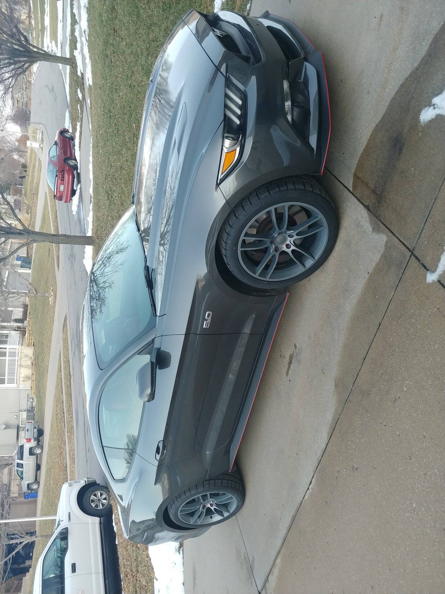

I'm running the same tire sizes 325/30/19 and 285/35/19, but Cooper not Michilens, and I'm not lowered, yet. I'll post some pics when I pull them from my phone (on the work 'puter now)

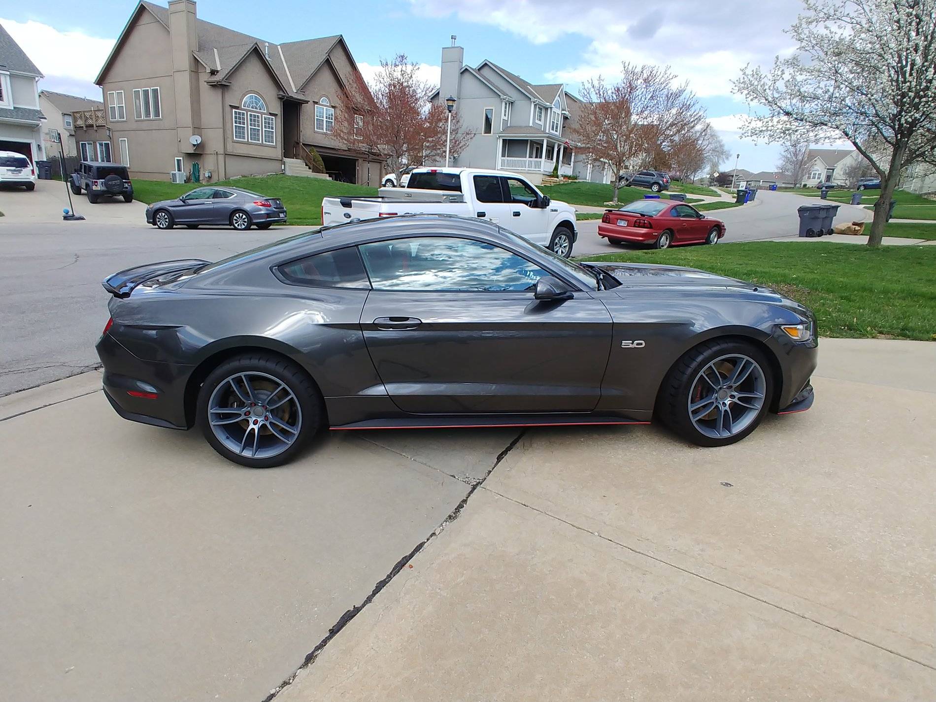

Finally have a chance to post those pics.

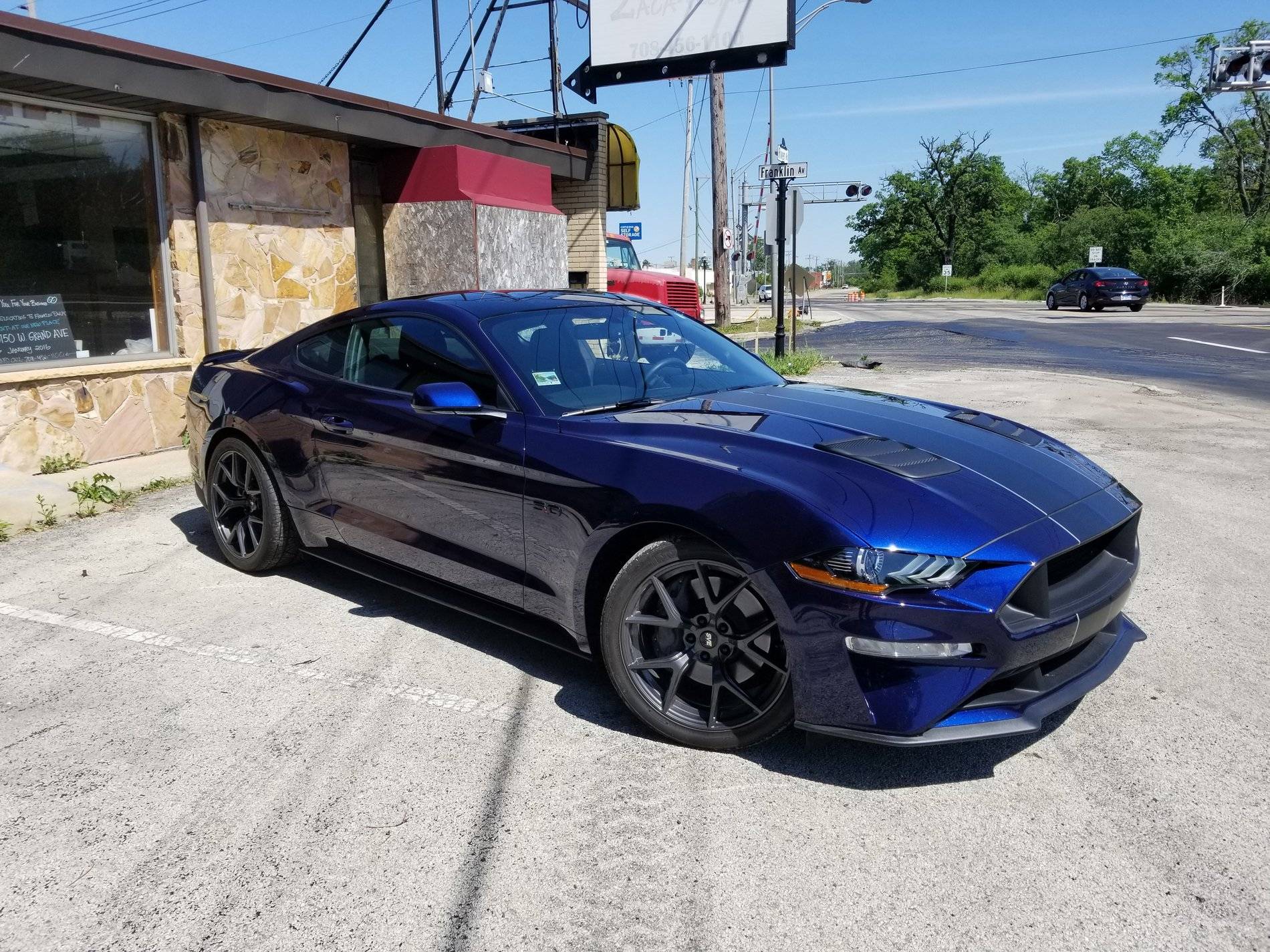

325/30/19 & 285/35/19 Nitto Invo's. Lowered 1.2"/.5" (drag springs)

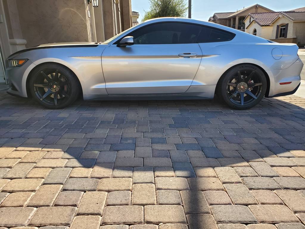

BMW M2 Mustang GT, MME GTPE

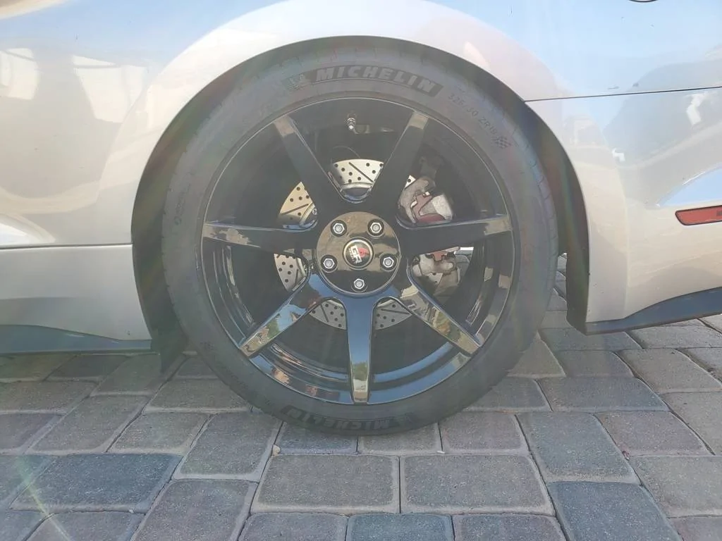

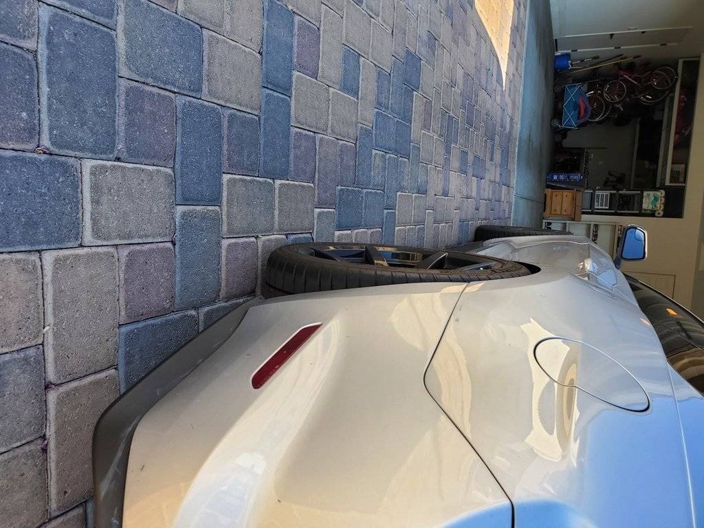

Springs: Steeda Ultralite Sport Springs Linear, about 1.25" drop front and 1" drop rear
Wheels: Project 6GR Seven R-Spec with PS4S 305/30/19 front and 325/30/19 rear
What is the width of your fronts? Also, do you know the specs of your fronts?
samd1351
Sep 17, 2018
107
838
1,489
Olathe, KS
Sam
2017 Mustang GT, 1999 Ranger
What are the specs on those wheels? My FG-08s are being delivered tomorrow and I am thinking about 325 30s in the rear (11" wide)
Fronts are 19x10 with a 35 offset and rears are 19 x 11 with a 50.
