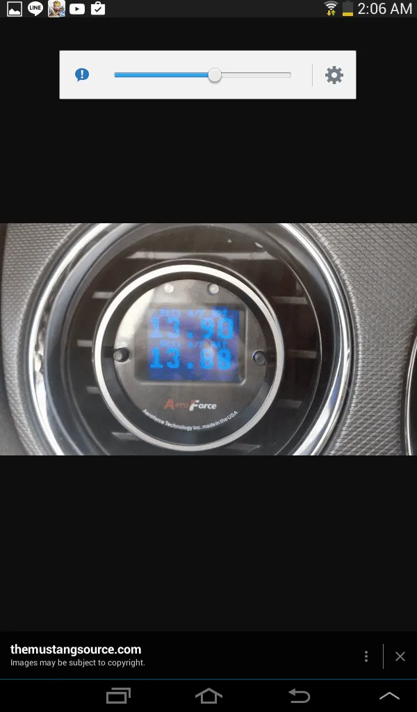

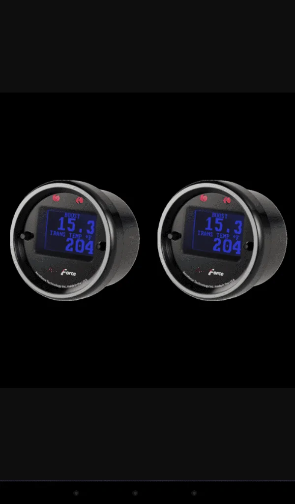

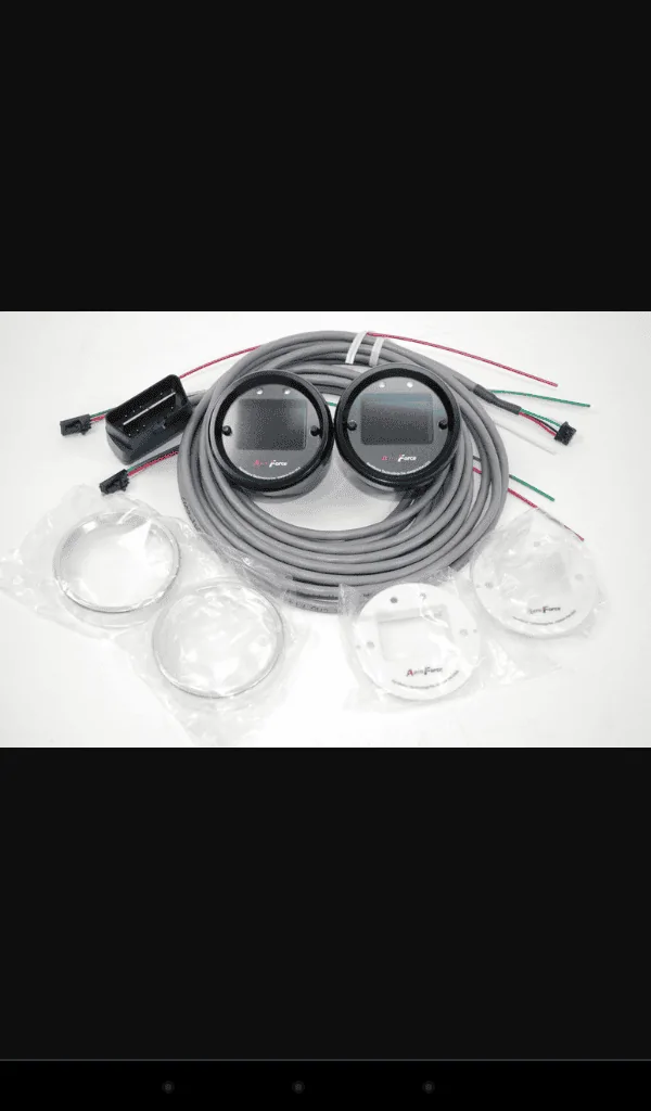

I thought about going a different route and not using the oem performance pack gauges. I was thinking of using the aeroforce II dual gauge set up. It can be had for like 399.00 and is easy plugged into odb II port. Only issue is roush hasnt made a heat vent gauge pod yet for 2015. Unless a different year might work or another vehicles like f150. The aeroforce II gauges can monitor tons of things all at once and is plug and play. So a performance pack set up would be achieved at no more than 500.00.

It won't fit in the dash trim from the performance pack?
