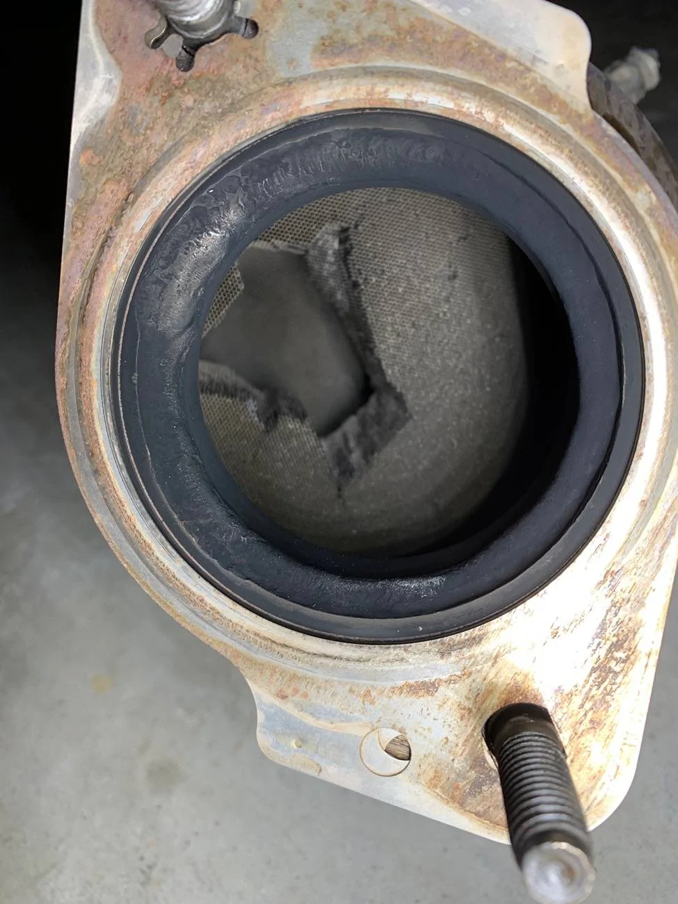

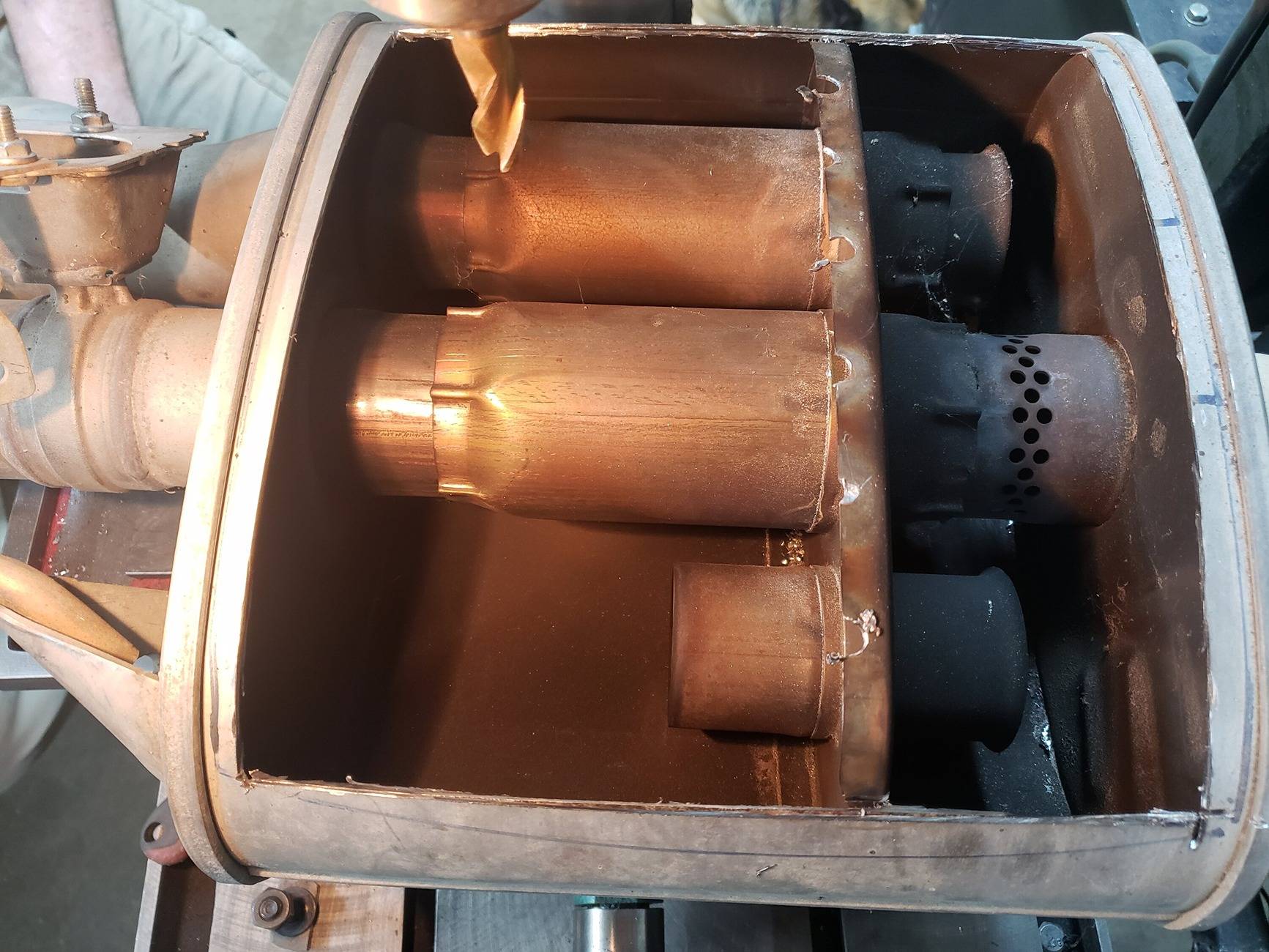

As general examples, attached are two photos.
In the first, a cat which has failed. In the second, the internals of a muffler/resonator.
If everything keeps leading you back to the exhaust, pick the closest point to the noise where there's a joint, disconnect and take a look.
An exhaust place might charge you an hour of labor to do this? Maybe two. But if they see something and confirm a repair is needed, then it's rolled into the repair bill. These shops see issues all day long. Maybe they can give some insight before going into the system.
