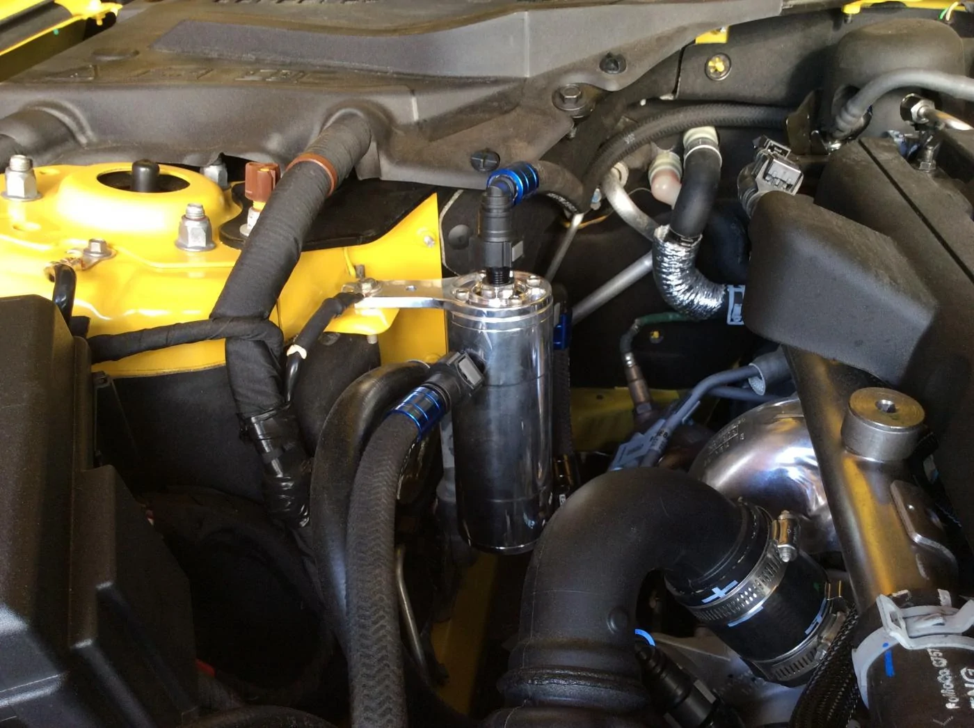

So I received my can from UPR very quickly (sent January 27th and received February 2nd) :)
Really easy to install, we will see how it works. Here are some pics

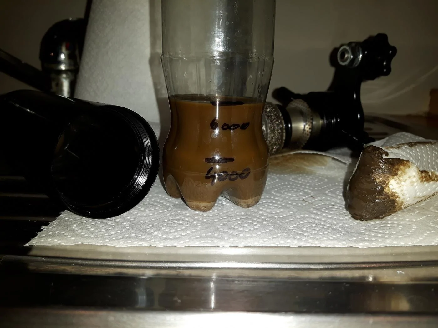

Emptied my UPR can again today, installed at 2500Km, first drain at 4000Km second at 6000Km. Also replaced the O-ring UPRSteve send me and cleaned out the gunk at the bottom of the can as much as possible.
I'm yet again impressed and will definitely add the new clean side catch-can asap!

Since my last drain at 6000km I couldn't resist to empty it again at 8000km. My observation was that it had less oil/blow-by in it than the previous time I emptied it after 2000km intervals.
Also the color looked like oil this time, not the brownish color like previous times, there wasn't any sludge at the bottom of the can either. My guess is that the temperature change from winter to spring might have something to do with it. I do have a slight increase of fuel consumption though lately.

Just a quick heads up,
As it gets warmer you will collect less overall fluids, oil, and condensation. So climate change is the exact reason. Also, cooler weather will cause your vehicle to run leaner and cleaner. As it gets warmer you'll run a little richer, and that's the reason for the MPG decrease.
The color differences between the summer result in the darker oil. Also, less moisture means less milky froth like you see in the winter from the additional condensation and moisture from the radical temperature variations between the outside air and the hot air the PCV creates.

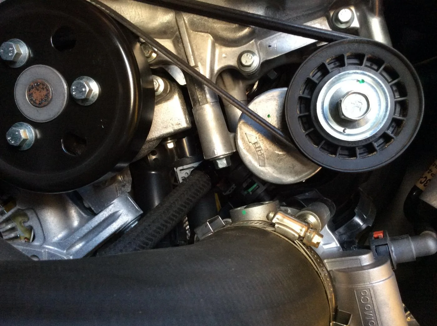

Especially connection nr2 on the manual would have been a drama without taking the intake manifold off as Adam suggests in the video. Might be just me, but I've no DIY experience whatsoever before the Mustang (did a cat-back, intake and catch can so far) and I had no clue where to search that 2nd connection. So the instructions in Adam's video on how to take the intake manifold off was pure gold!

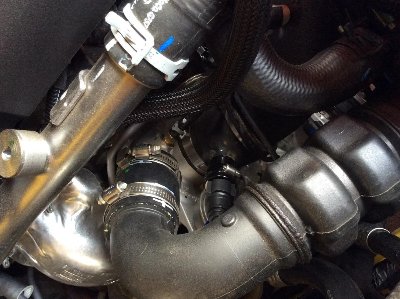

Connections nr3 and nr1 are much easier. They are at least visual without taking the manifold off (see photos).

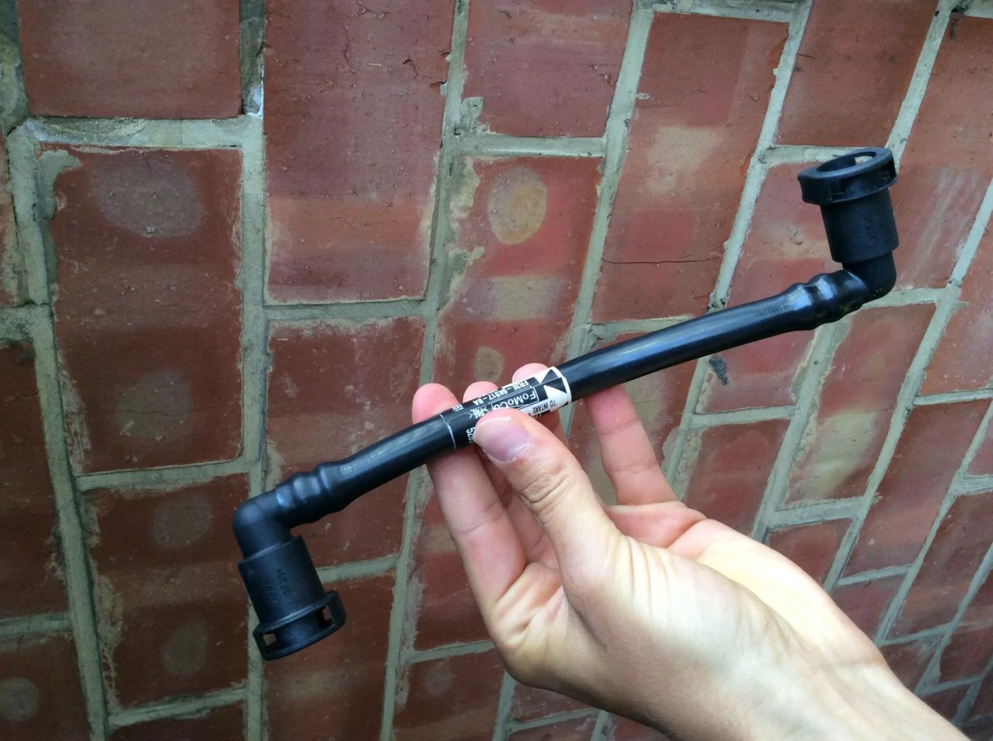

The other photo is the part that is stock behind the manifold that's replaced by the catch-can. The stock clips are a bitch imo. I'm so glad I don't need'm anymore, cause they are well... broken cause I'm an idiot. :frusty::headband: On the other hand: the clips on UPR's connections are awesome!
