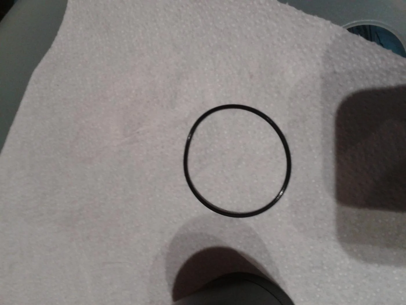

If the can seals, I would leave it be until you get the new ones.

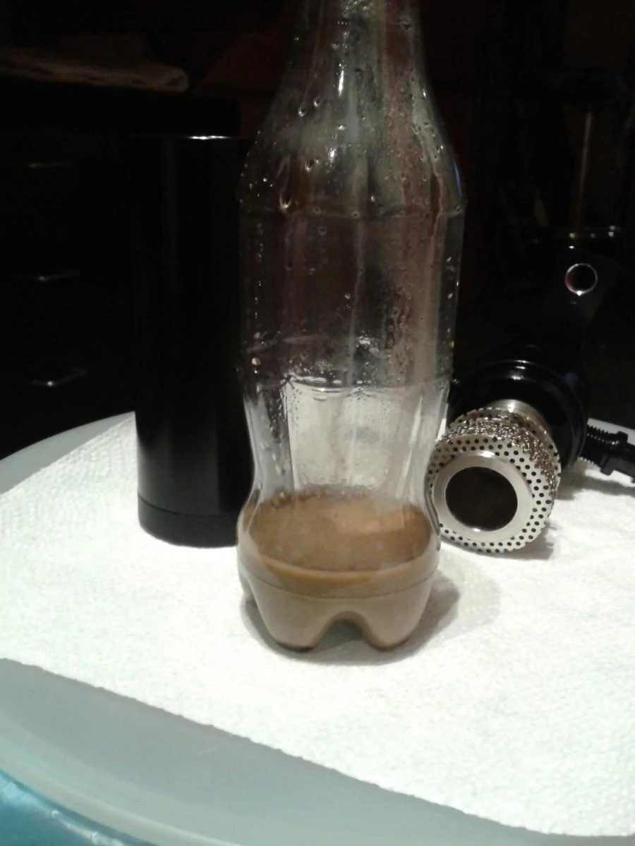

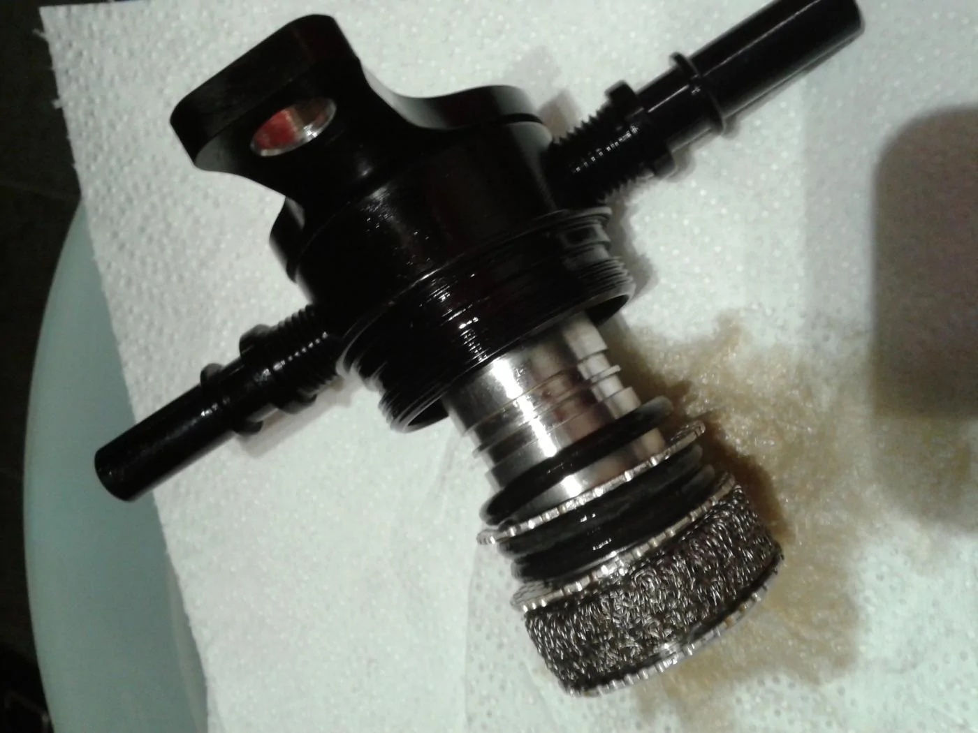

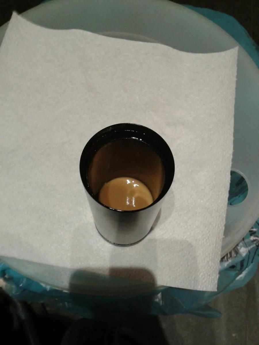

I'm still on factory oil, or maybe the temprature dunno, it does really smells like fuel though and is pretty liquid. I kept the bottle and will see in the morning if it's changed in color or if some dirt has dropped..Why the oil is beige color instead of dark black as we ve seen in many videos?
From past experiences...this usually means there is moisture in the system weather it's from condensation or coolant...
