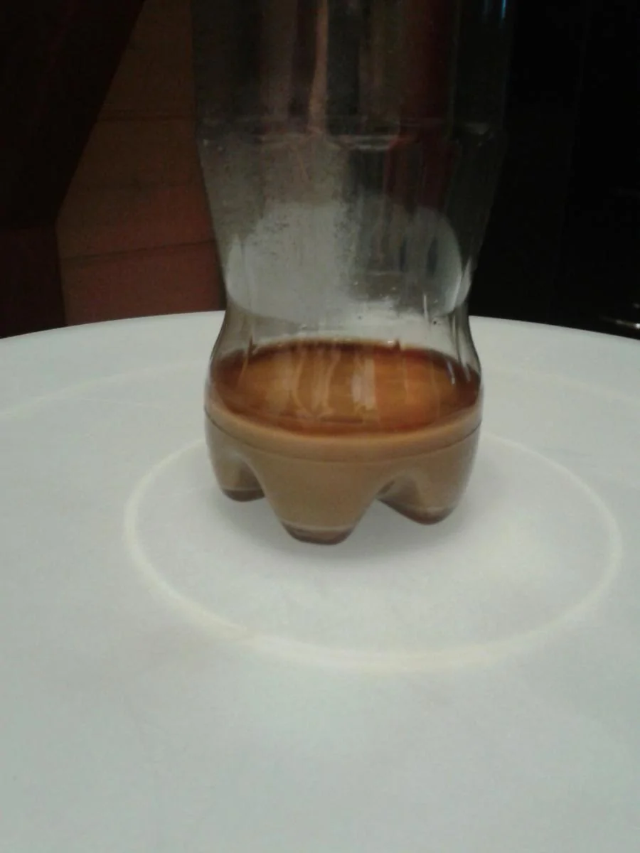

I'm still on factory oil, or maybe the temprature dunno, it does really smells like fuel though and is pretty liquid. I kept the bottle and will see in the morning if it's changed in color or if some dirt has dropped..
If your oil still looks like that in the morning I'd take it to the dealer ASAP. Only time I've seen that is when it is mixed with coolant which = destroyed motor.

Here's a pic after sitting in the bottle over night. All I can say it smells like fuel, definitely not like cooling fluid. I did notice some sludge though and feels grainy/sandy...
The thing is as far as I know it's supposed to catch blow by, so I guess it's normal that it smells like fuel. Condensation maybe due to the weather.
I just found the same issue on the interwebs, they say it's ok http://www.camaro5.com/forums/showthread.php?t=396733
Maybe it flipped out the last time I checked it about 2 months ago. I did pay attention though, but once the o-ring is expanded it slides out to the sides of the can when closing it.
Also why the o-rings & filter ring on the inside have dropped down I don't know, maybe from pressure?
Mine has never looked like that in any of my cars but one thing worth mentioning is that this is in a catch can, but your oil pan. If your oil looks like this when you change it, then I'd be seriously worried lol

If you had a lot of cold starts recently there will be condensation of water in the valve covers, this moisture sucks in to the Catch can mixed up with oil.
If you open the fill cap for the Engine oil you will probably find some cream there too.
Nothing to worrie about, usally Cleans up if you take it for a longer drive.
But just to be sure, check the color on the oil on the dipstick.

Had a lot of cold starts lately indeed and have been driving a lot of short distances where the oil isn't even warm at arrival. I checked my oil today and could'nt see anything abnormal, also managed to get the o-ring to seal again on the can. And repositioned the 2 thick rings with the filter ring inside can, but I'm sure they will drop down again, not usre if this is normal either.

Just a quick heads up as the oil has a ton of condensation in it to get that coloring which is normal when you have a can that works this efficiently. Also the o-rings are not doing what they're supposed to be doing and they look too big. I will go into the catch can department on Monday and get you the parts you need. Just PM and I will make sure your all set right away.
