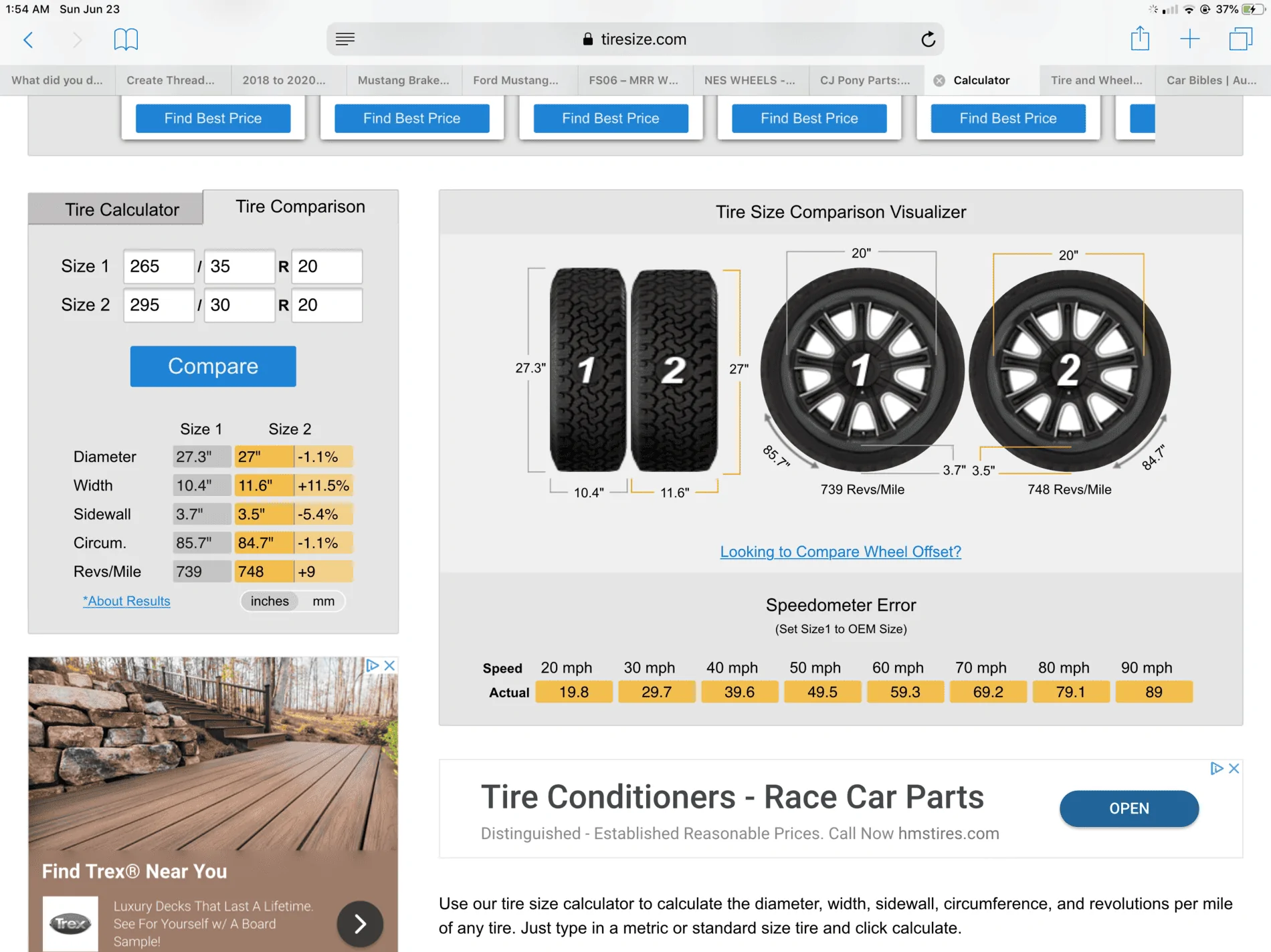

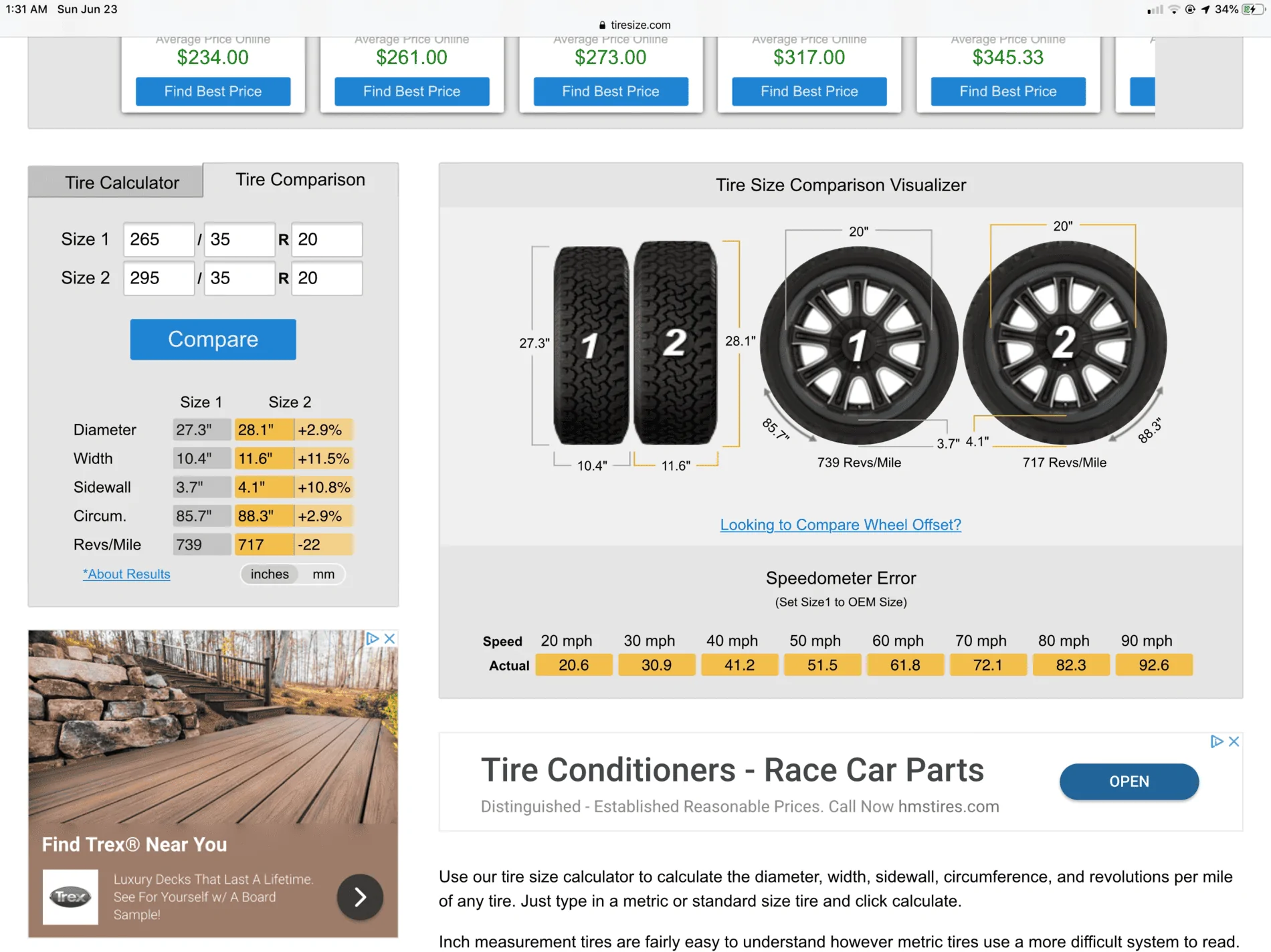

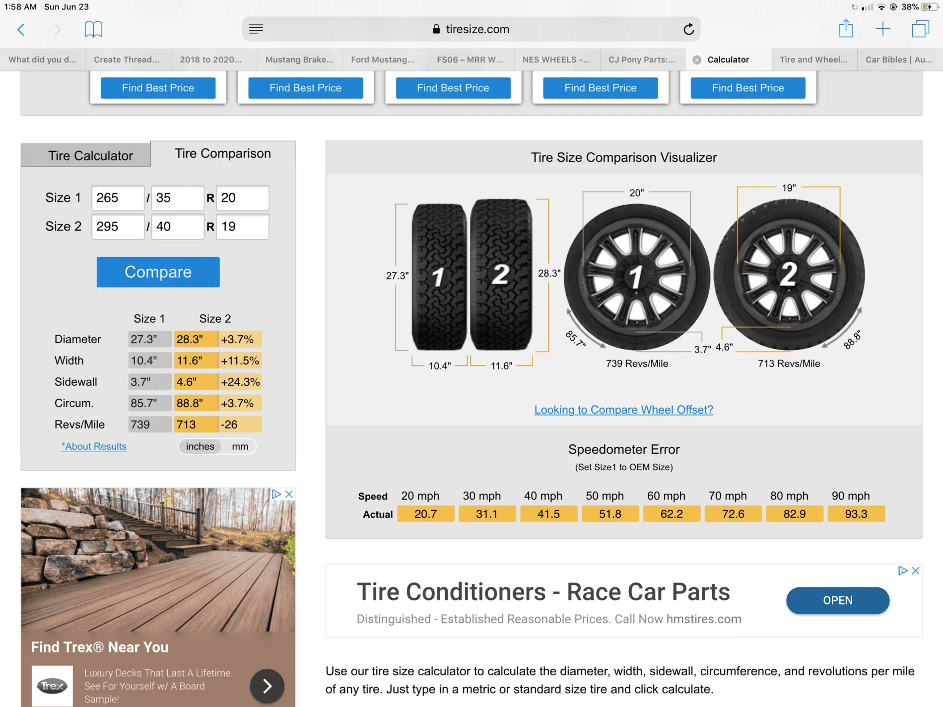

I really want to upsize my tires from 265 to 295. I understand keeping the diameter of the tire maintains speed. Can anybody explain to me why changing the width but leaving everything else the same effects my speed so much? I have even tried 295/35/20, 295/30/20, 295/35/19 and 295/40/19. Anybody have any ideas? Or am I just overthinking this entirely too much?

The two-digit number after the slash mark in a tire size is the aspect ratio. For example, in a size P265/35 R19 tire, the 35 means that the height is equal to 35% of the tire's width, so changing the width, automatically changes the aspect ratio of the sidewall, and therefore the height and your speed.

This guy knows whats up. 35% of 295 is more than 35% of 265 and therefore taller. If you want a wider 19" tire that is almost the same height you're looking at a 305/35/19.

295/30R20 is as close as you're going to get to stock diameter.

You're getting your boxers in a bunch over the 295/30/19 being 0.2" shorter than the 265? As the calculator you attached indicates in slide number 2 -- 295/30 vs 265/35 -- you will be doing 89 MPH when your speedo reads 90. You're golden there. Get the 295's and be done with it.

Agree 295/30/20 in pic 2 is fine.
