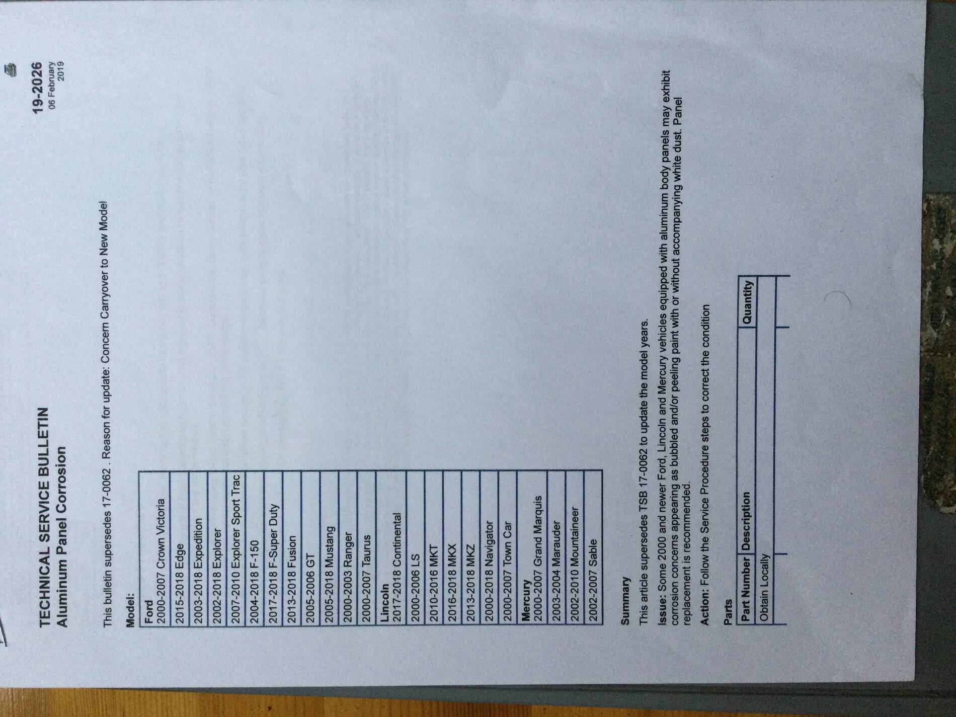

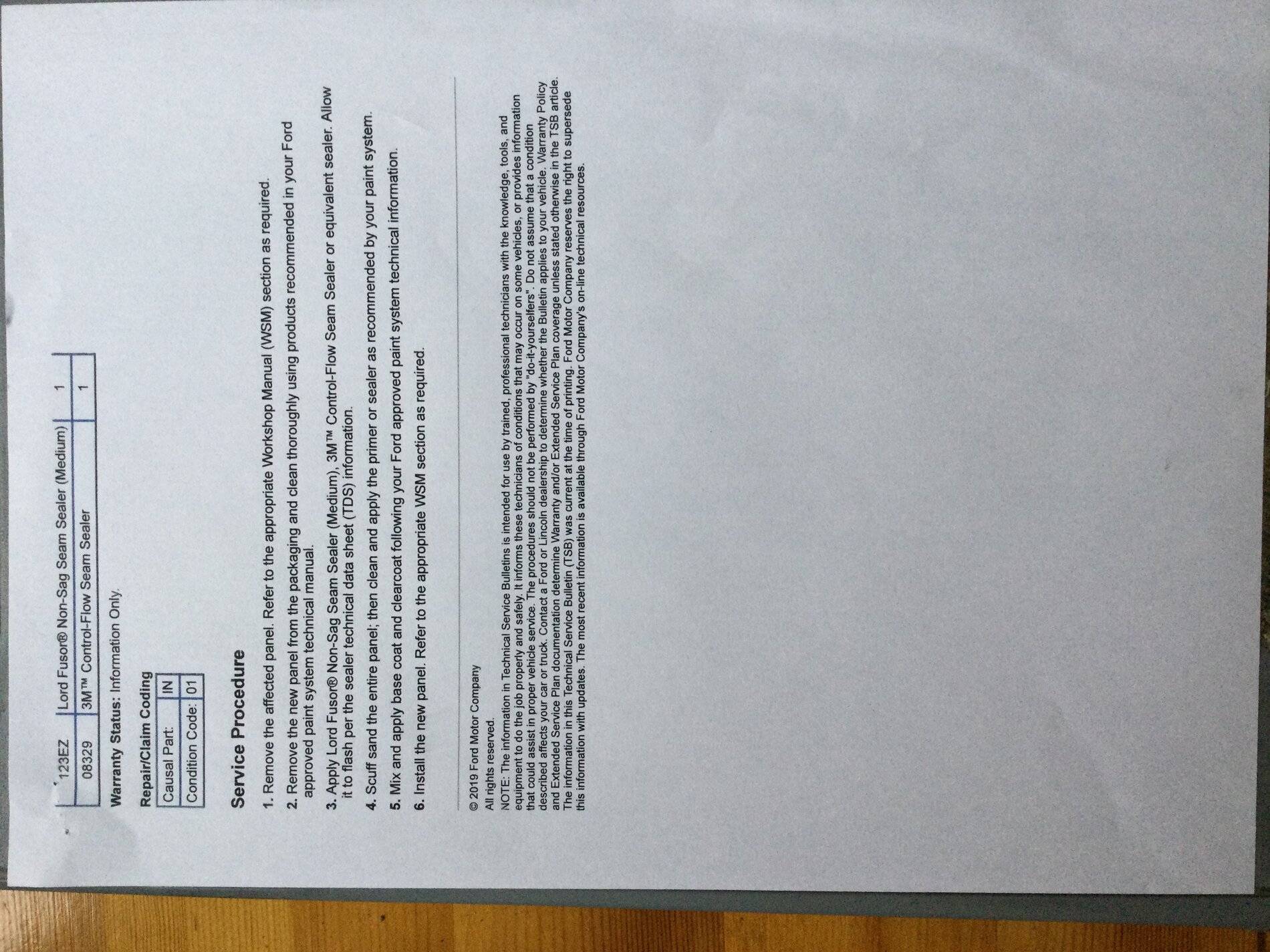

Good luck with getting any corrosion issues sorted after the three years are up.
I didn’t delay(thank goodness ) and took mine to the dealer at 26 months old.The issue of bonnet corrosion was exactly as described in the TSB,a copy of which I gave to the dealer.Now 11 months later I am still waiting for the repairs to be authorised.
You can understand why people go the non metallic route, especially when the replacement goes the same way!
FAB Cruiser
Aug 30, 2019
94
31
Bucks UK
David
Mustang GT 2017
Where can I find that TSB?
