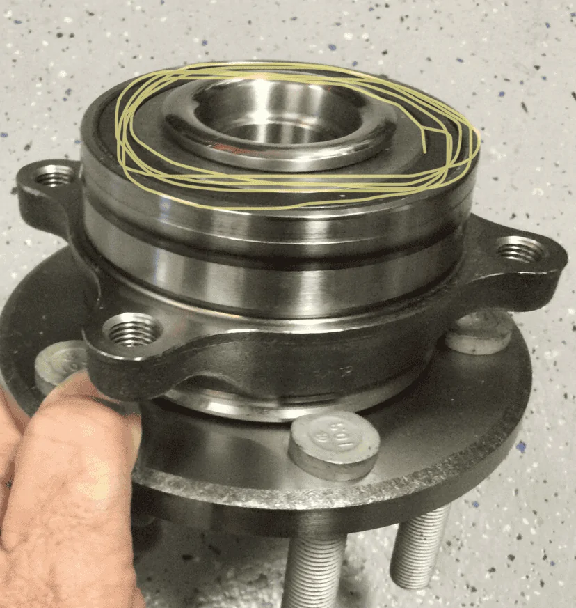

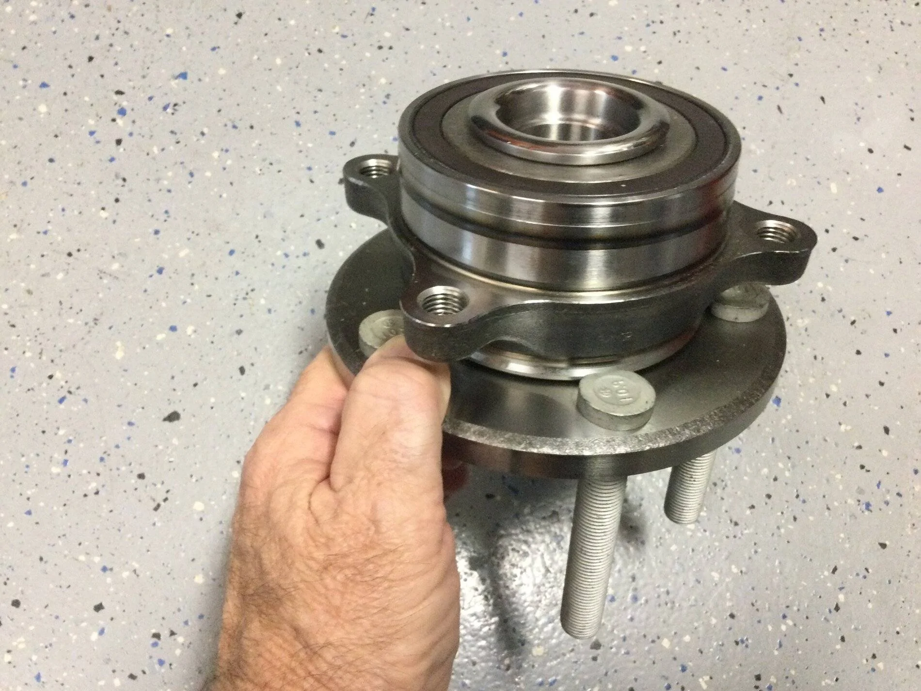

It’s imbedded inside the hub on the GT350 & GT500:

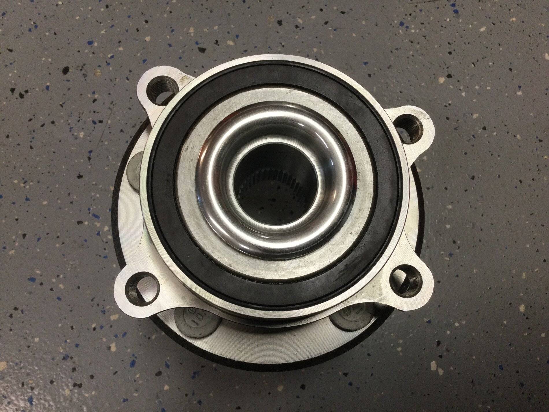

Thank you very much. That tells me I need to use this hub as opposed to a cheaper and shorter hub from another car. I've already checked and the ABS sensor for the GT and the 350 are the same. Is it the brown looking ring at the outside on the back of the hub? Usually it's serrated. Everything in your picture looks smooth.

Looks like it’s in the black ring sealing the bearing. Looks like it has the pattern visible for the little magnets.

1” Bearing of Back to bearing mount surface
1 11/16” disk mount surface to bearing mount surface
2 11/16” disk mount surface to back of bearing
There is no obvious exciter ring, but it could be behind the black segment as it is rubber.

The non-GT350/500 hubs have a step in that 1” mounting area. So each upright has it’s own unique bearing setup. Once you pick an upright, that dictates the hub bearing.

Good luck with your build.
Another item to factor in is wheel offset (front to rear). If you plan to go with a square setup (i.e. same front & rear wheels & tires), you should consider using the GT350R or GT500 CFTP hubs with longer studs on the front; then add a 1” spacer to get to the right numbers (or just replace the shorter studs with longer ARP studs). I was lazy and just bought the hubs with the longer studs. That’s why I could show those pix as I have them on the shelf.
