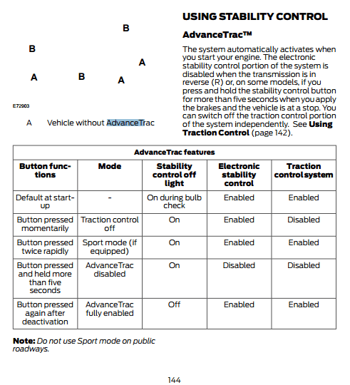

T/C off, yes. AdvanceTrac not. (AdvanceTrac != 'Track' mode or T/C).
Hold the T/C switch for 5+ seconds, as others have said, to turn off T/C AND AdvanceTrac.
You can still smoke tires with AdvanceTrac on.
See page 144 and on for more info.
PS Read your manuals, people!

Every 2015 Mustang has advanceTrac. It's a standard feature. Why don't you go and try what I (and many others) suggested first :). Push and hold your T/C button for more than 5 seconds. You'll see a notification that AdvanceTrac was turned off (along with the T/C OFF light being on)
Once again, AdvanceTrac != any kind of mode.

I just did this in my 2015 BASE GT.
1. Press Traction control off and it says off.
2. Press Traction control again and it says on
3. Press and HOLD traction control for 7 seconds and it says advance trac off.
You have advance track. You don't have sport in the base gt.
This is most of your launch problem.
EDIT: This also going to create some of the wheel hop you are getting even with the new bushings you have.
