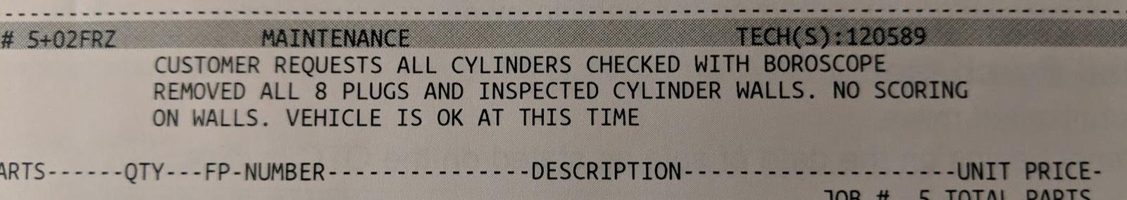

10/24/18 - Dealer replaced the cam sensors and stated they couldn't hear the ticking anymore at this time. I asked them to move forward with scoping the cylinder walls to inspect for damage for my own piece of mind. (based on @bigriver findings since my car also has the light throttle 2k rpm rattle) If they find nothing I will pay 3 hours of labor. Will update when they complete the scope. Hopefully it was just the sensors causing my tick and the walls are clean.
10/25/2018 - Picked car up from dealer. I really cant hear any ticking now. Boroscope found no scoring on any of the 8 cylinder walls. See picture below of explanation of what got rid of the tick (for now). Hopefully this might be the case for some of the other 18's ticking out there? Keep in mind I have never had had a CEL on this car. Not sure exactly what a code in the PCM means.

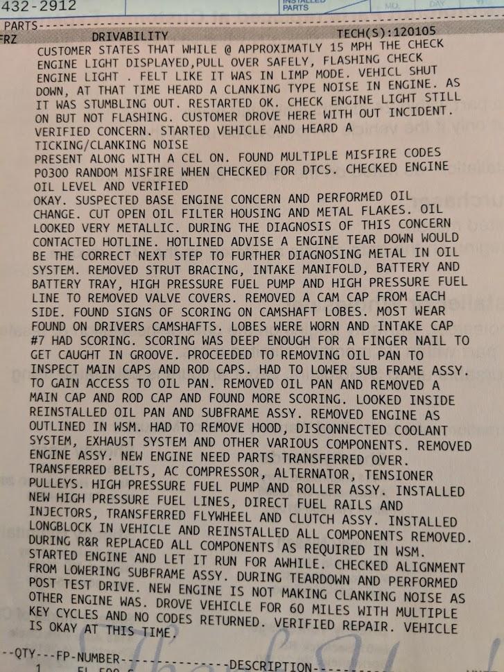

10/26/18 - Things have turned for the worse for my car. So there is still no tick but something worse has happened unfortunately. My car died in the middle of driving it last night on my way home from work. Engine code P0300 (Misfire) P0390 (Camshaft position sensor failure) and P0394 (Crankshaft position sensor failure). Car went into limp mode after restarting the engine. The car is now back at the dealer. I will update as soon as I hear something from Ford. Still no ticking though.
10/28/18 - Car is still at dealer. They reached out to the Hotline and asked if they should do an engine tear down. Ford engineers said no and to replace parts of the wiring harness and sensors. They later on moved to cutting open the oil filter. Looks like they are looking for an excuse to do an engine replacement so they don't have to hunt down an electrical grimlin. Hoping to hear something tomorrow.

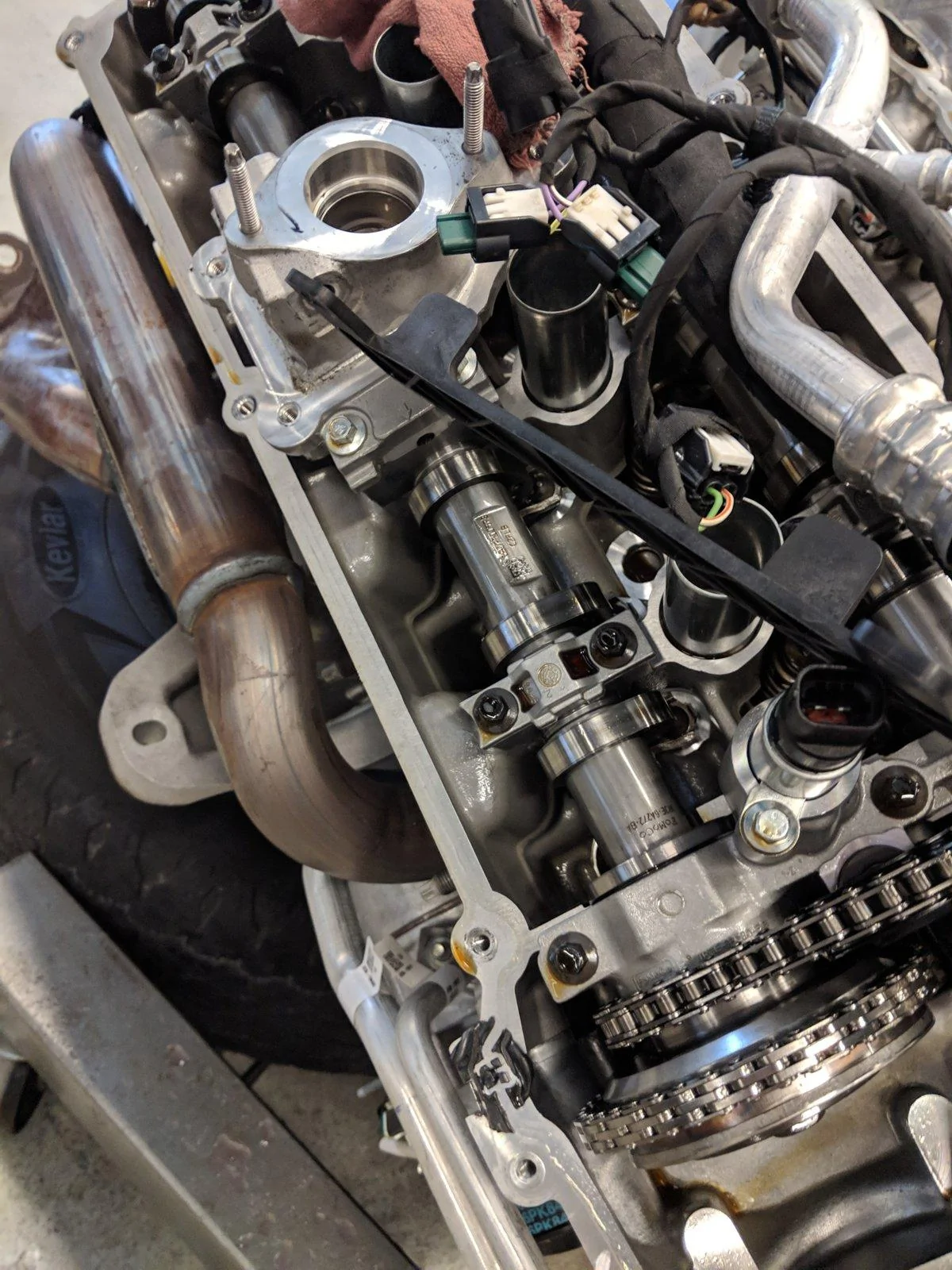

10/29/18 - Technician found metal shavings in the oil filter. They are going to pull the heads over the next few days and inspect for further damage.

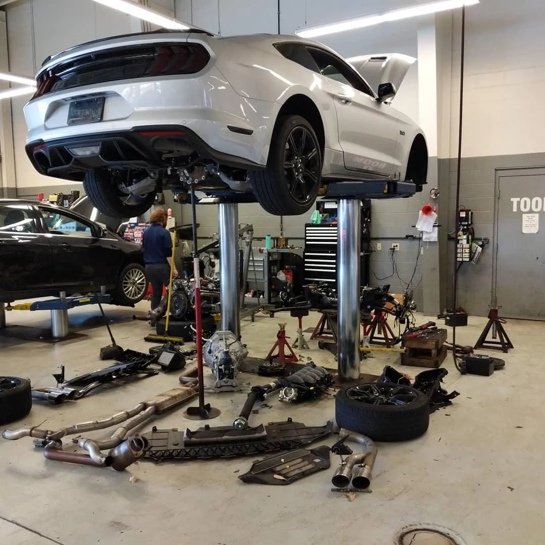

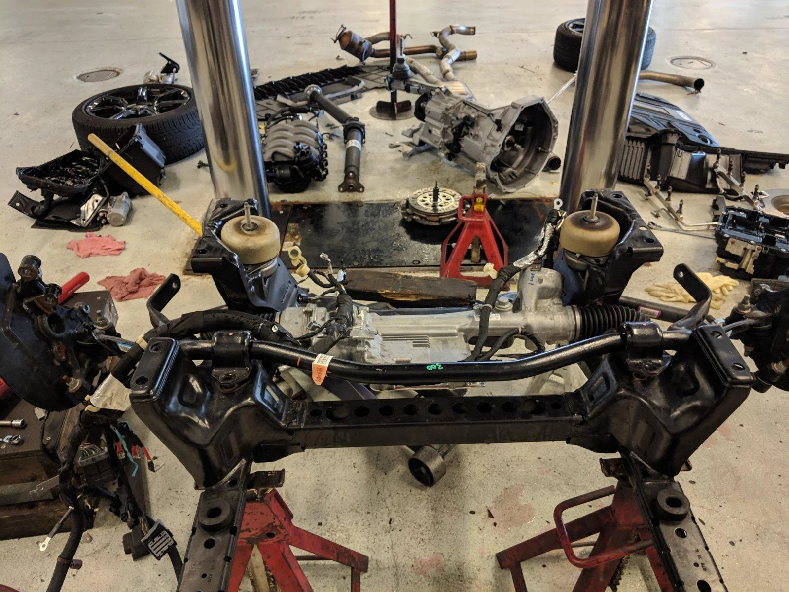

11/2/18 - Went to the dealer to check on my car and they brought me back to the car to show me what they found. The cam caps and cam shafts were scored to hell. You could tell the engine was eating itself alive for awhile now. They found metal glitter in the oil pan and oil filter. The Technician is recommending long block replacement and awaiting approval from Ford. I have opened a case with Ford Corporate in case I need to pursue a buy back which may be where I am headed. We are at 11 days the car has been at the dealer in total.
11/2/18 - Ford approved Long Block replacement.

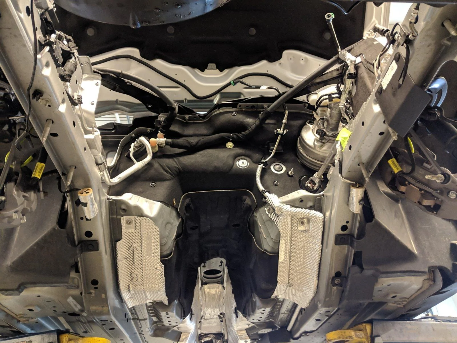

11/9/18 - Picked up car from Ford Dealer with a new long block installed in the car

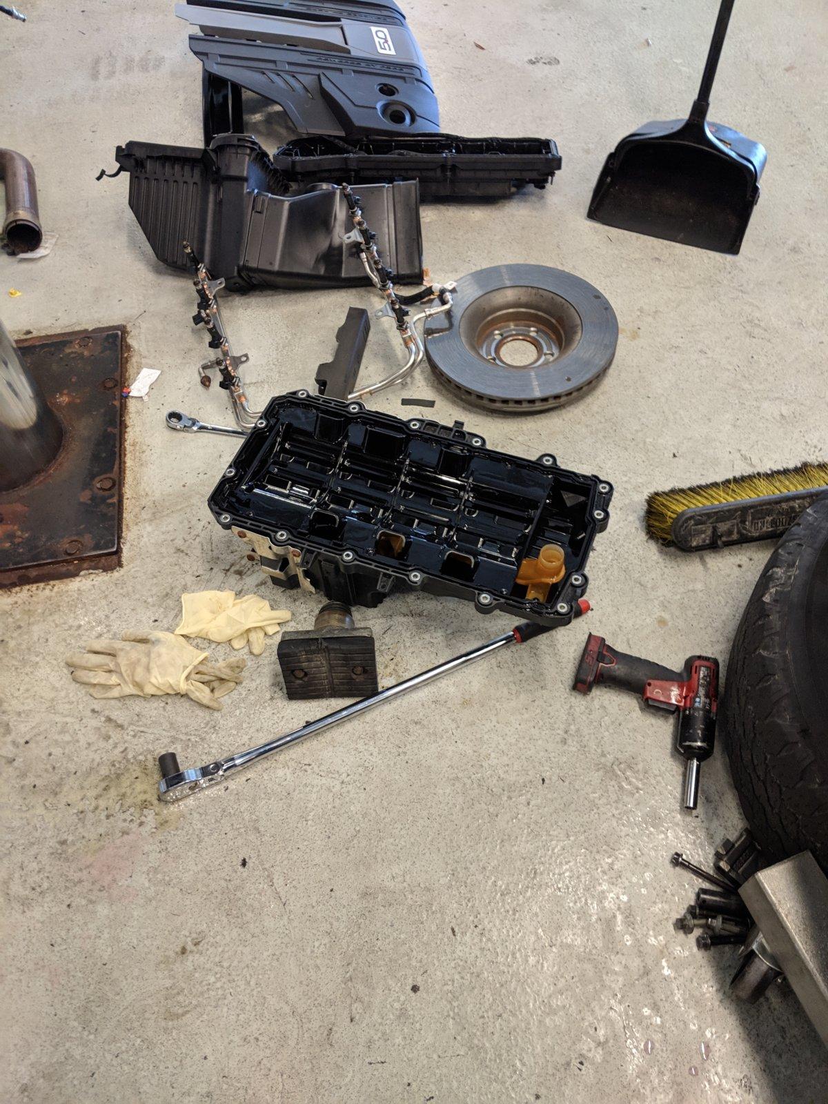

11/13/18 - Ford has declined my buyback. Car is still at the dealer and approaching the 30 day mark. This is already the third time the car has visited the dealer for engine issues. So I have reapplied for buyback under lemon law. As for the car, the dealer said that now they think there's a major electrical issue and to get comfortable in my loaner car as it was going to take awhile to diagnose and resolve.
11/14/18 - Received a call from my dealer that my car was ready today. Picked up the car with no CEL. Resolution notes as follows: CUSTOMER STATES CHECK ENGINE LIGHT CAME ON, HEARD TICKING NOISE THIS A.M. VERIFIED CODES P0303,P0305. CHECKED MODE 6 AND FOUND MISFIRES ON ALL CYLINDERS PERFORMED POWER BALANCE. PULLED SPARK PLUGS FOR CYLINDER 3 AND 5 FOUND PLUGS TO BE ASHY COLORED. SUSPECTED A LEAN QUOTATION. RESET PCM KAM AND MISFIRE RELEARN DROVE VEHICLE STILL HAD MISFIRES ON ALL CYLINDERS. REMOVED PORT FUEL RAIL AND FOUND INJECTORS TO HAVE CRUD OR DIRT AROUND THE UNDERSIDE OF ORINGS AND INJECTOR PORTS. CLEANED ALL INJECTORS AND REINSTALLED PORT FUEL RAIL. CLEARED DTCS. PERFORMED PCM ASBUILT, MISFIRE RELEARN AND CLEARED KAM. PERFORMED POST TEST DRIVE AND NO MISFIRE COUNTS PRESENT AT THIS TIME. MO-8164 VEHICLE IS NOW OKAY AT THIS TIME. VERIFIED REPAIR.
11/19/18 - I had to drop the car at the dealer yet again. The BBQ tick has returned on the new long block at about 200 miles on the new engine. I'm back in a loaner. Video below of new long block dated 8/18 ticking.
12/18/18 - Well after a long wait, Ford finally called me this morning to inform me that my car is accepted for Buyback. I've been absent lately dealing with some personal events as well as this Mustang issue. So I'll back track real quick.
The new engine started BBQ ticking at about 100 miles. I put another 1000 Miles on the engine and the ticking remained. I had the dealer change the oil when the new engine hit 1000 miles. They noted they found no metal glitter in the oil this time.
