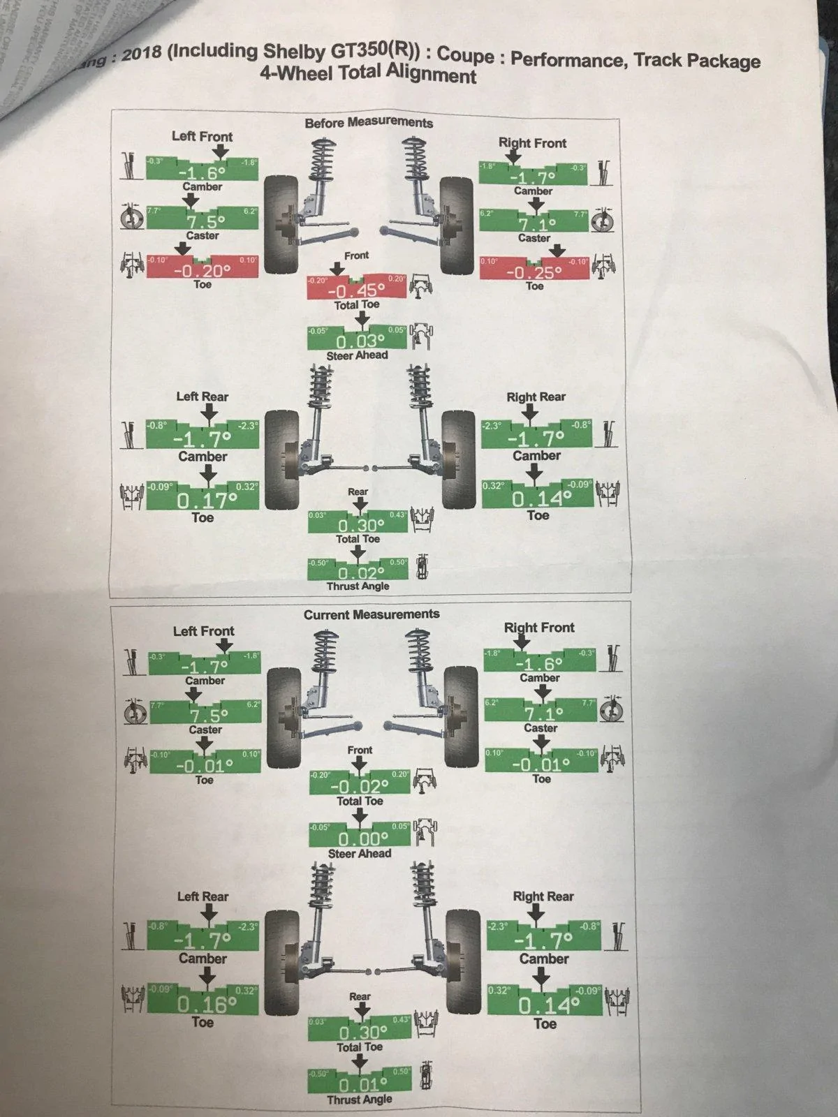

The dealer contacted me and they are going to realign the car free of charge.
I daily drive the car, I will have them set the camber somewhere between the 2 specs Ford gave.

I had bad front toe at first after the FP Track/shock kit paired with Steeda minimum drop springs with BMR CB005 kit already installed, Installer sent it to a regular alignment shop with hunter machines using Performance Pack specs and they also did fix up the front toe. I probably will need to do another one in a month or so. I will go to a decent alignment place, not a Ford dealership.
My driving style is just DD and city/highway, a little spirited at times, but mainly I drive normal despite I got linear springs, but ride is good.

^^^Your new alignment looks very similar to mine.
