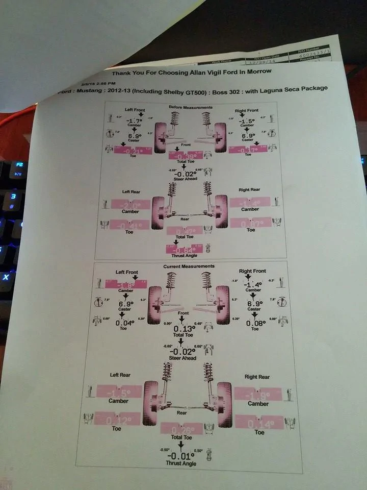

So after a weekend of driving my car dropped on Sportlines. Ive noticed some really weird issues, and I think they're alignment related.
Issue 1-
On hard acceleration or high speed pulls on the highway the car seems to sway back and forth. It feels really squirelly but not losing traction squirelly, just swaying right and left.
Issue 2-
On sweeping left hand turns , the car does the same thing. The car rocks side to side. On sweeping rights I dont feel anything wrong.
No clunks, creaks, or any other weirdness when turning full lock in parking lots or anything. Just on sweeping turns and hard acceleration do I feel that side to side swaying.
Here is my alignment sheet. Does the TOE seem way off , shouldnt they be the same? Is this what could be causing the weird problems?
I can't tell if you have a PP or not with the factory T2R but the swaying with high speed pulls has everything to do with how a Torsen diff works (by varying torque to each wheel as one speeds up/slows down due to gaining/losing traction. It could also be tramlining in the road or alignment.
My guess on the issue with turning is a blown shock or strut. These cars have crappy factory dampers that aren't valved correctly for stock springs, let a lone aftermarket ones. If one is blown you'll get a "porpoising" from the inside rear to the outside front and back again. It was a massive problem on the factory S550 until I put a real set of shocks/struts on the car. As for why it is doing it in one direction and not the other.... probably a blown shock on the driver rear or passenger front shock/strut.
