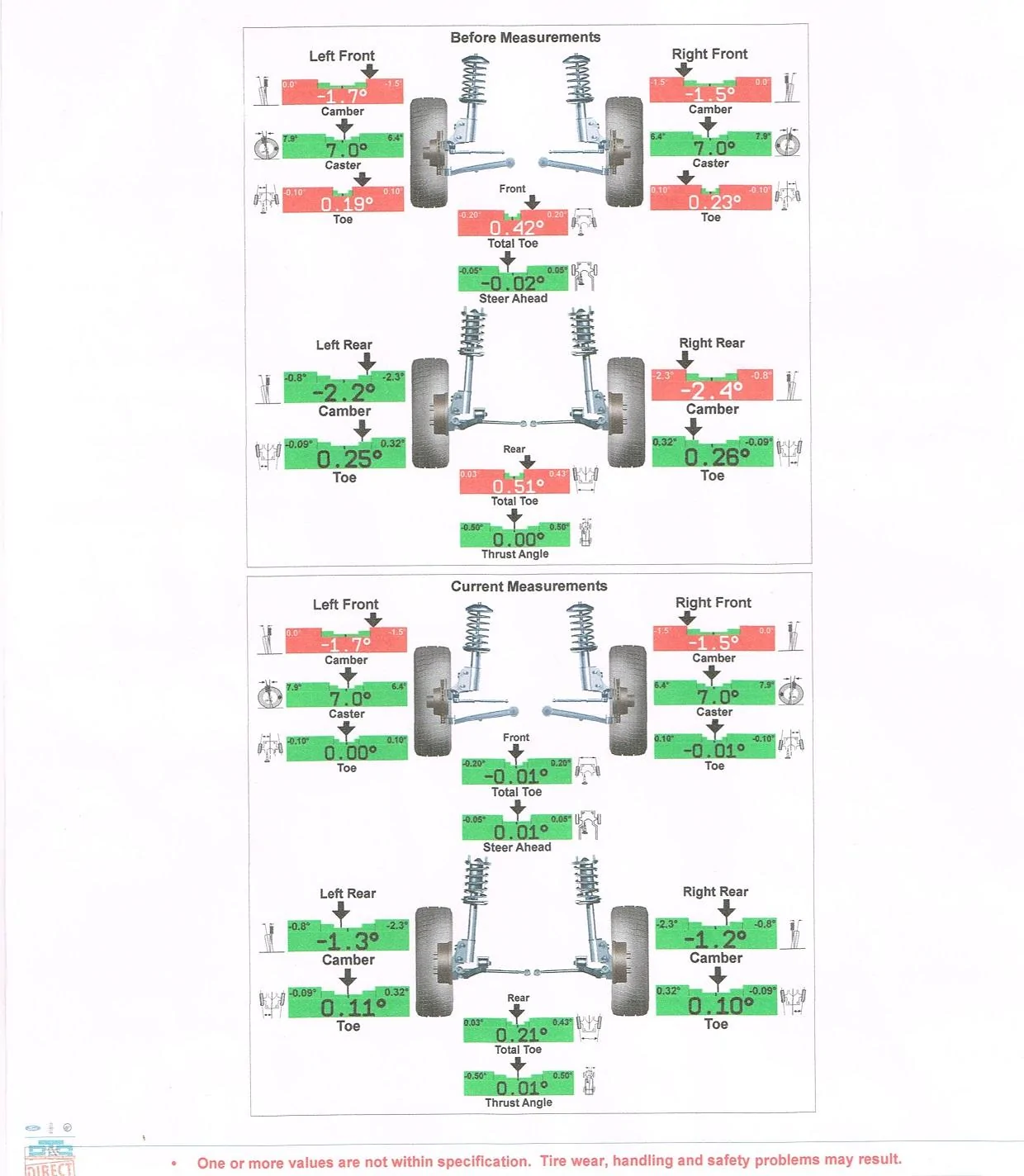

Alignment finally done.. Critique..
What do you think?

Turned out pretty good I think.. Seems to drive fine and goes straight when I punch it..

Looks great.

What type of shop/machine gave you those results? They look good for a street driven car.
I took it to my servicing dealers quicklane.. I know.. Cringe!!!
They had a better setup/machine than the service area at the dealership..
I didn't pay attention to the brand of the machine..
looks good for daily driver. Great to see that they were able to adjust the rear camber to good numbers for the street.
Some alignment shops have difficulty with the rear alignment settings.
