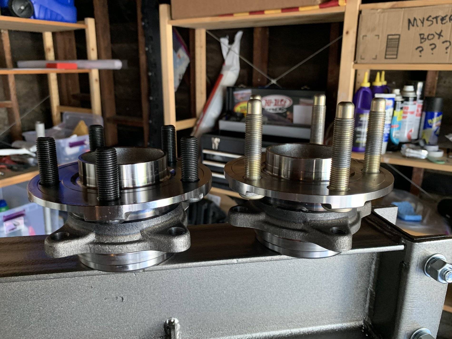

Here is a side by side if anyone is curious. On the left is an OEM replacement hub made by Timken. On the right is the same, but with 1/2"-longer ARP studs installed. I have these on the front and can't imagine life without them now.
