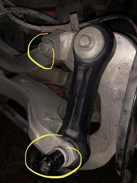

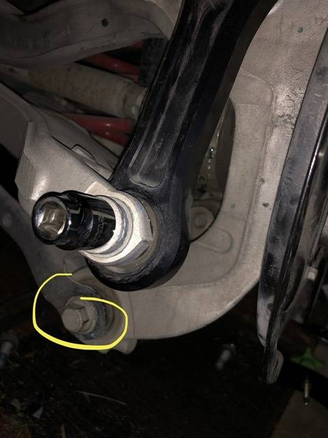

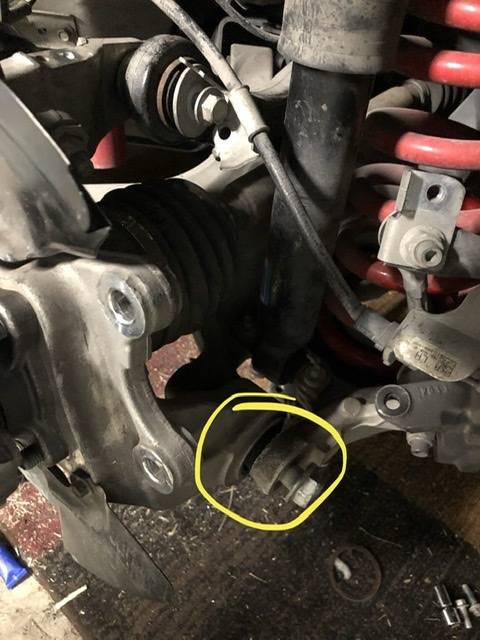

So I just got done replacing the rear wheel bearing and buttoning everything back up. I was seeing if anyone had the torque values for the bolts circled in the pics. What a bear if a job.... Thank you!

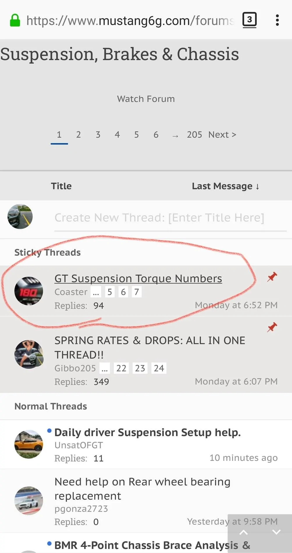

Not sure how I missed that but thanks for point it out :facepalm:

Here is a list of torque values I've collected and summarized for myself while doing my build. I'm willing to keep this first post updated if people would like to list additional info and any corrections.
I make no guarantees they are correct since they came from multiple places.

Front Lower Control Arm (24mm): 184ft/lbs
Front Lower Control Arm Nut to Spindle: 85 ft/lbs.
Rear Lower Arm to Frame: 184 ft/lbs.
Rear Lower Arm Outboard Nut to Spindle: 85 ft/lbs.
