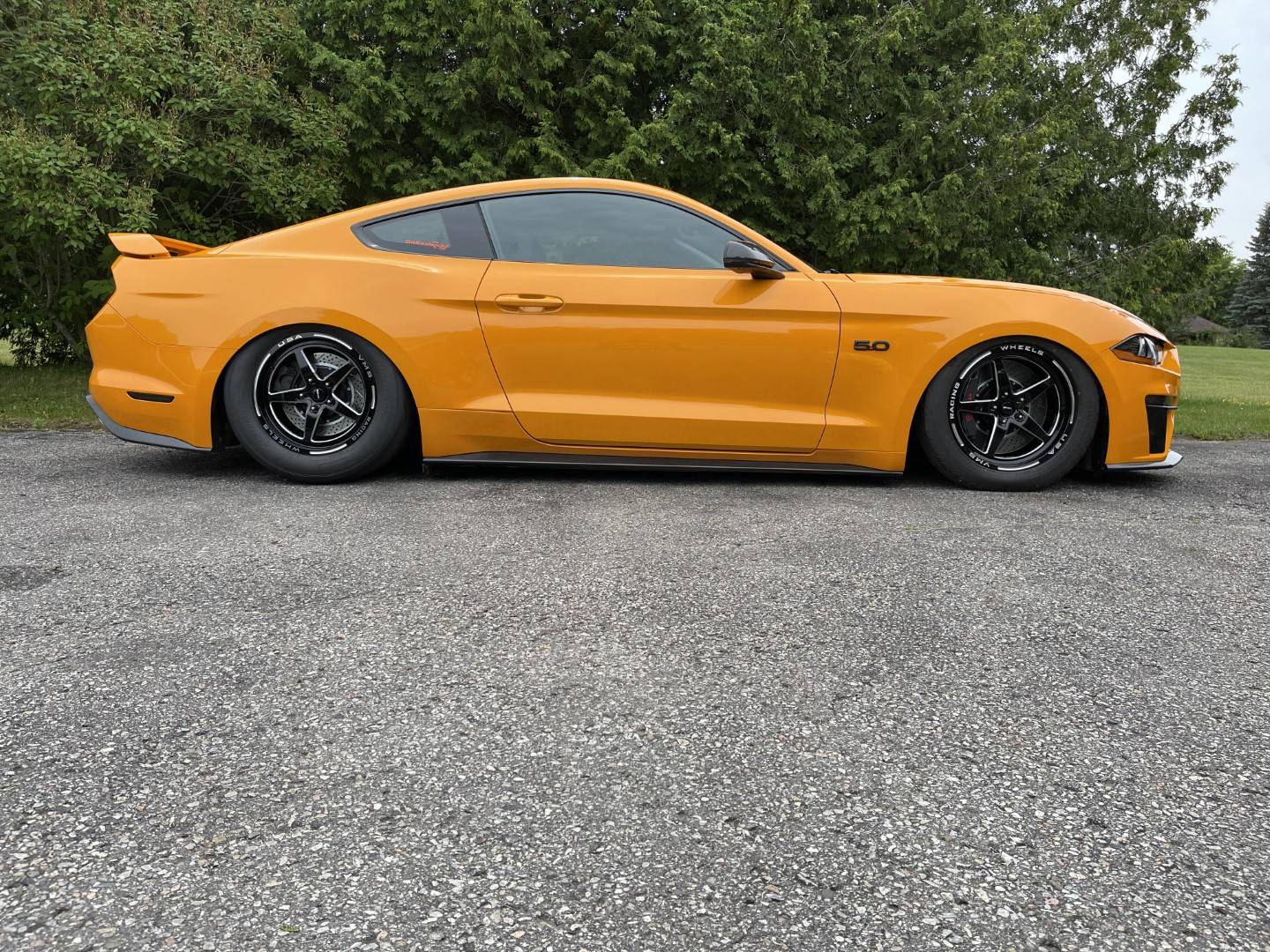

I have bagged my S197 and S550. S550 was easier to do. Could be done without drilling any holes in the car. I elected to enlarge two existing holes in the back to pass air lines through. My cars are not daily drivers so I can't speak to that. If an Airlift Performance kit, the front struts and rear shocks are 30 way adjustable so with a little tinkering you can achieve a comfortable ride. The front struts have a "pillow bearing" that fails freqently althoughI have not experienced it in my garage queens.
If your daughter is looking fo low she can get her Mustang there.
